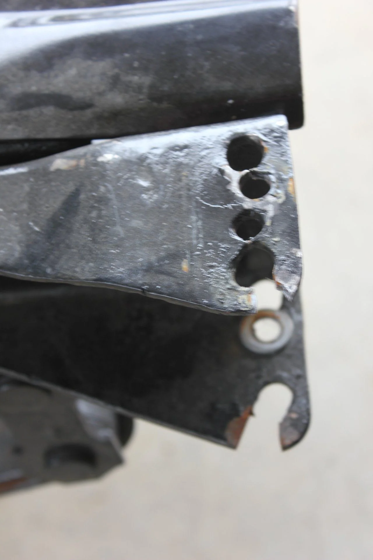

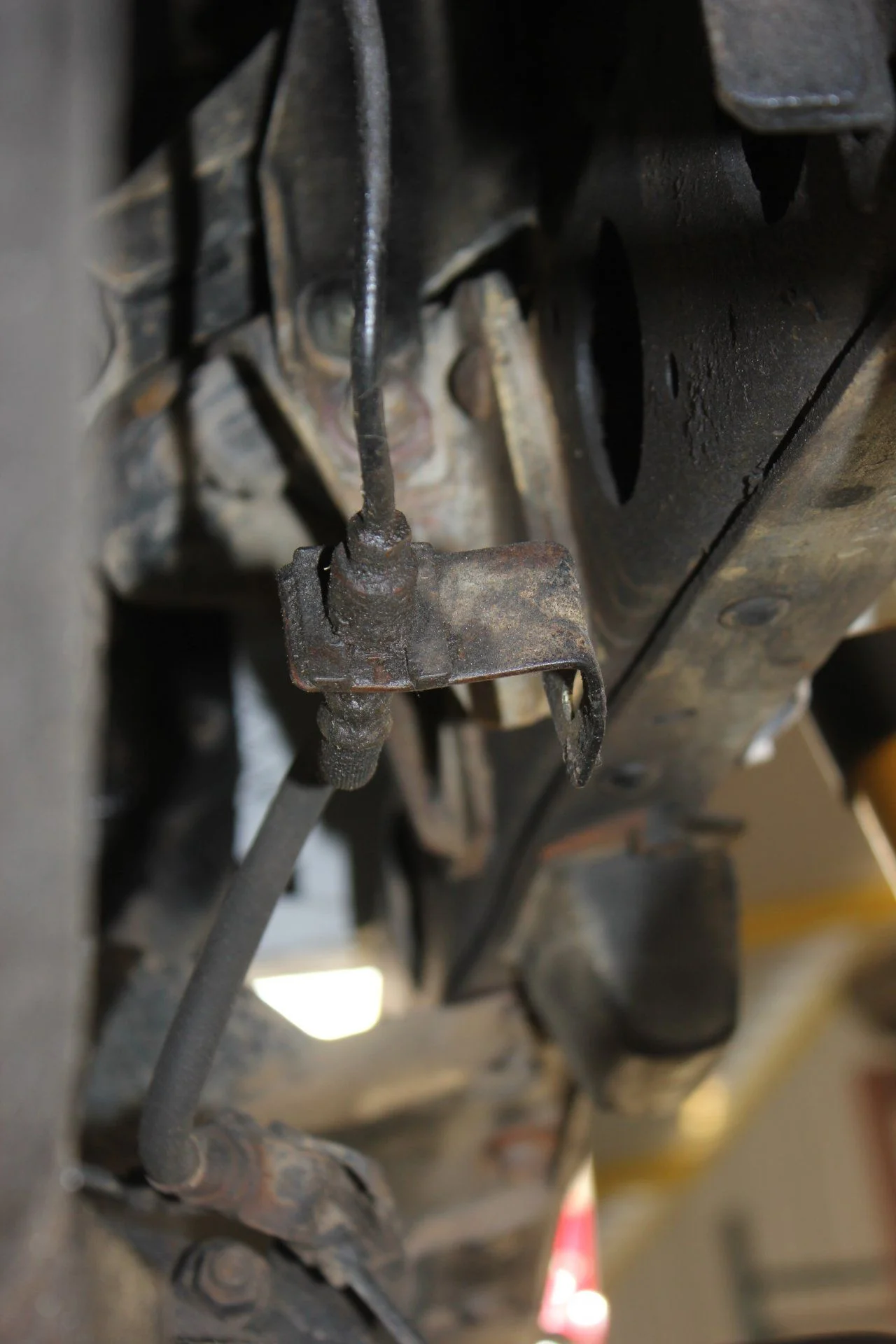

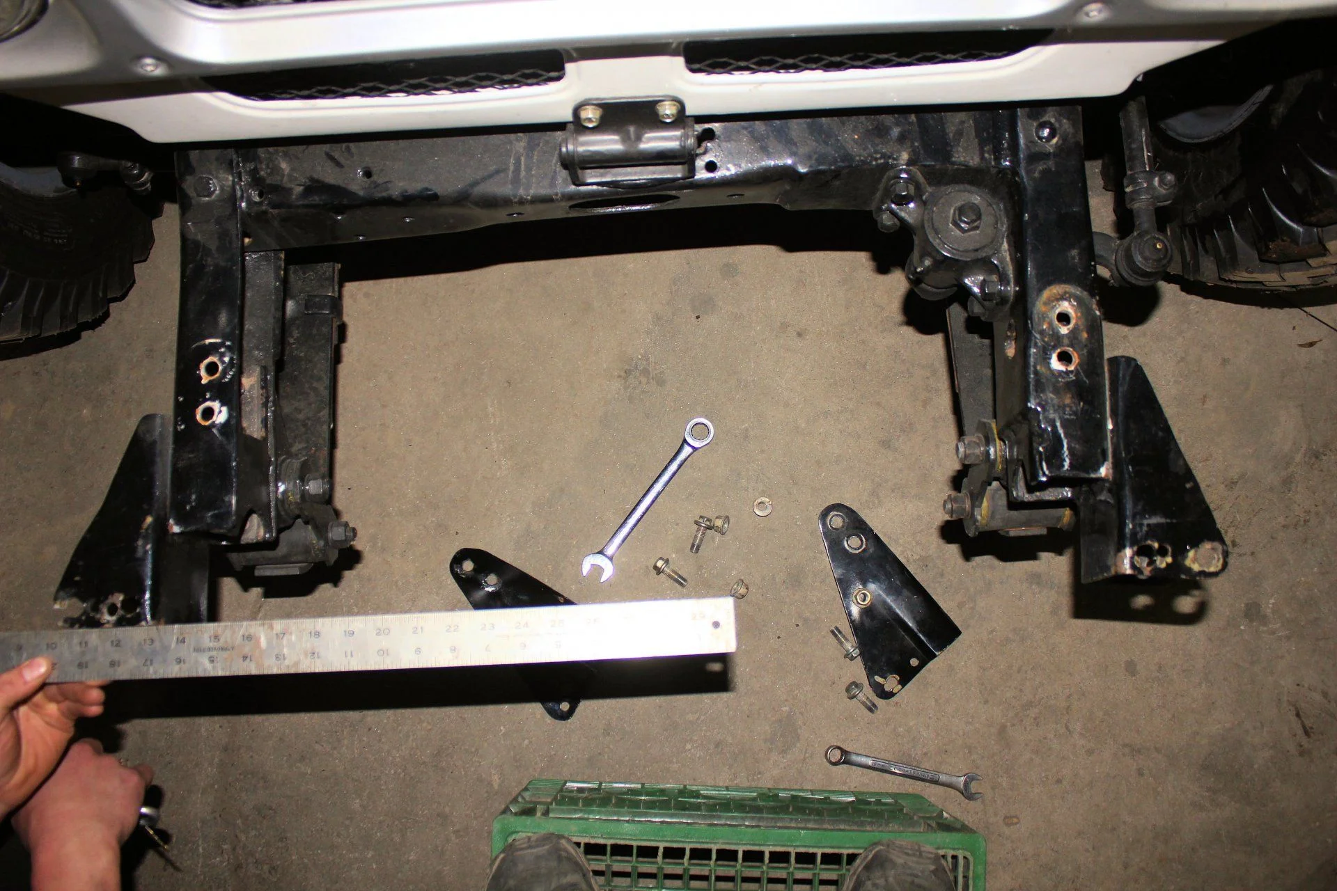

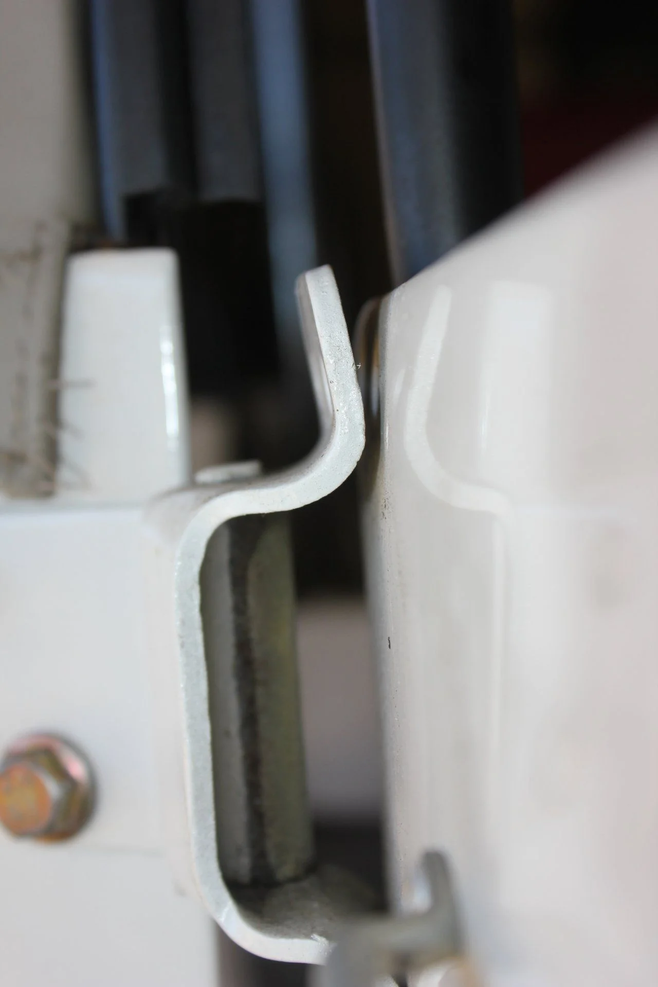

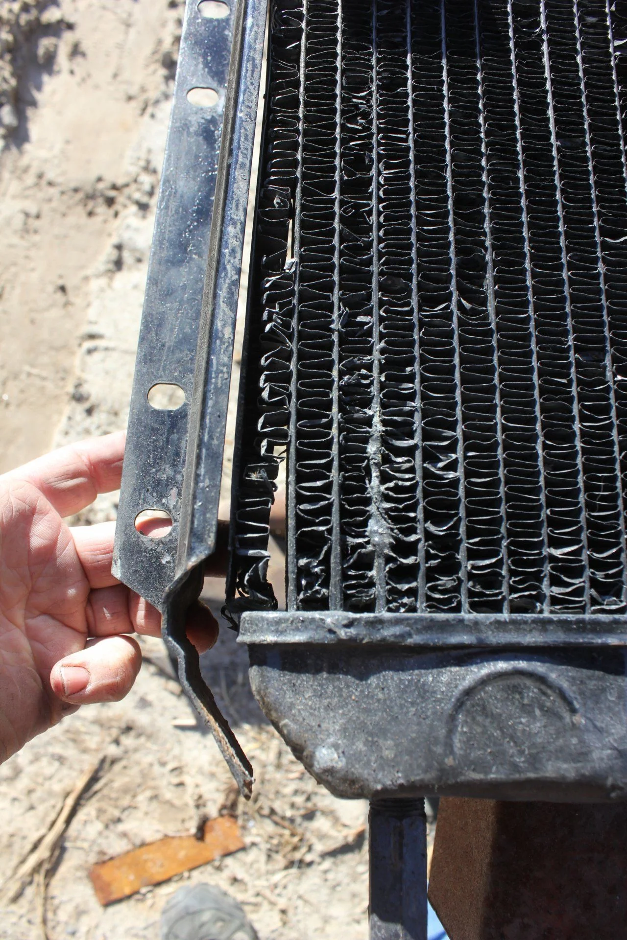

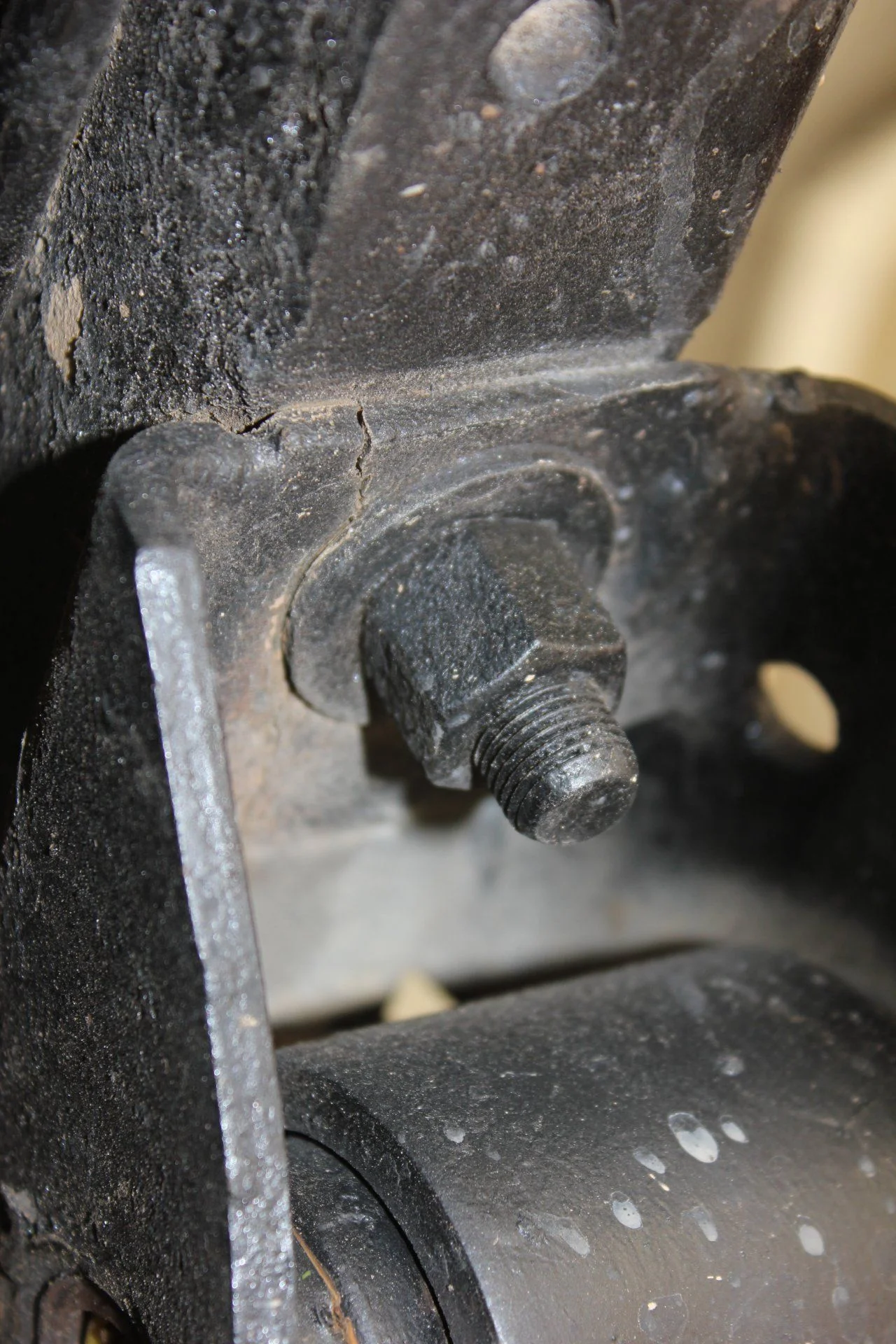

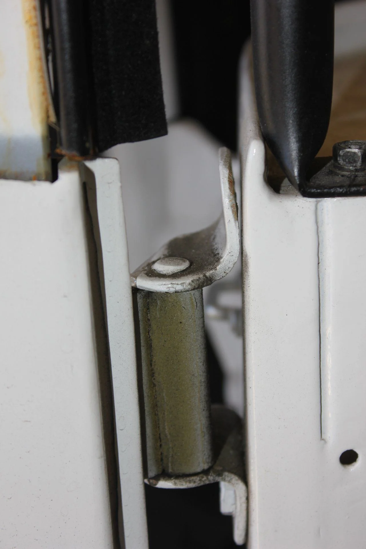

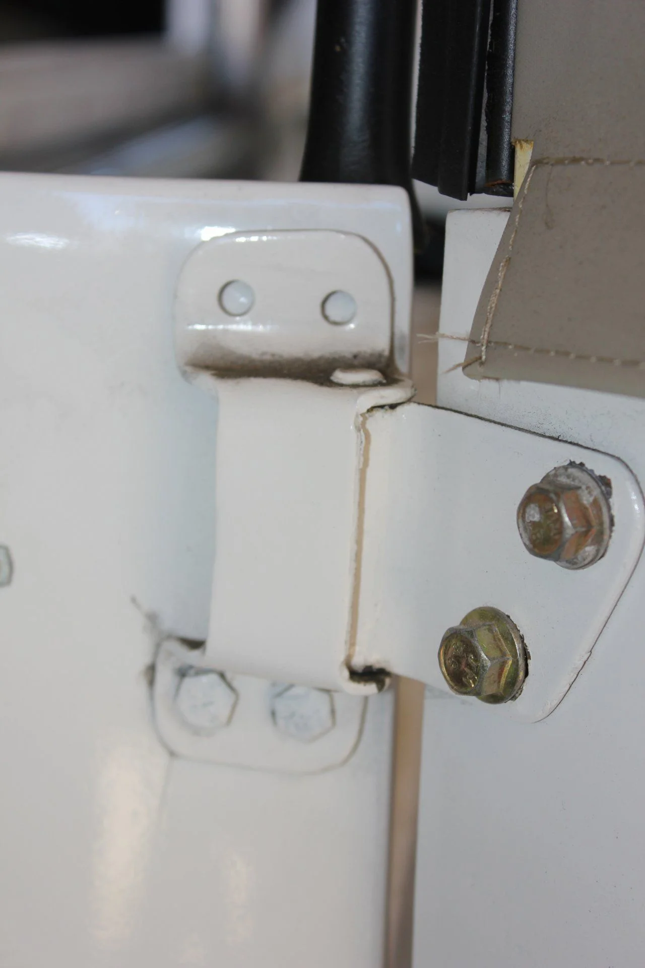

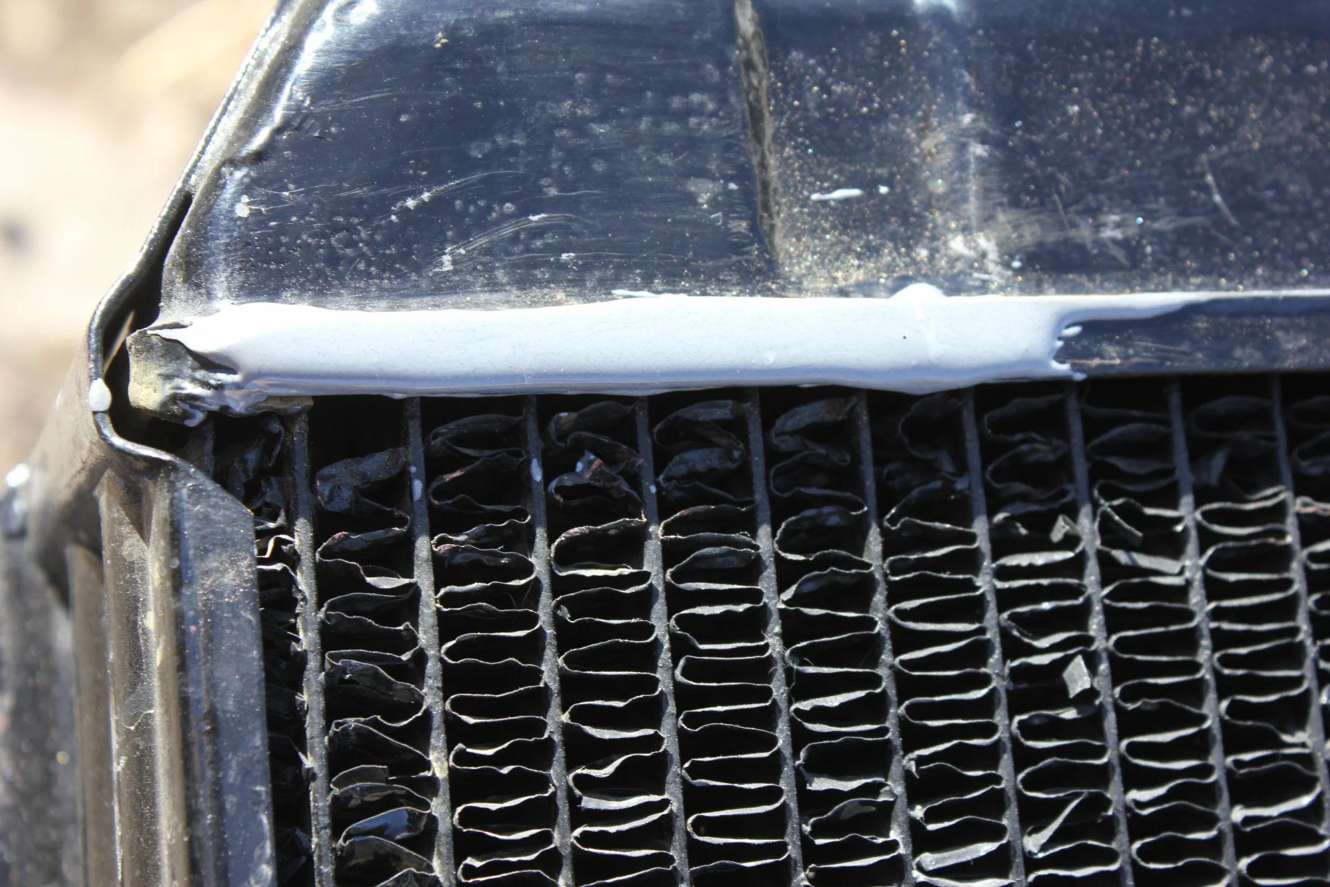

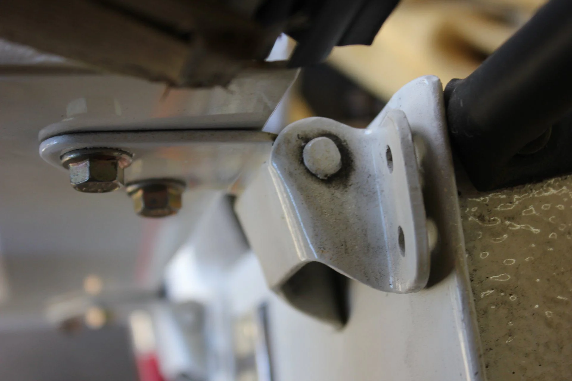

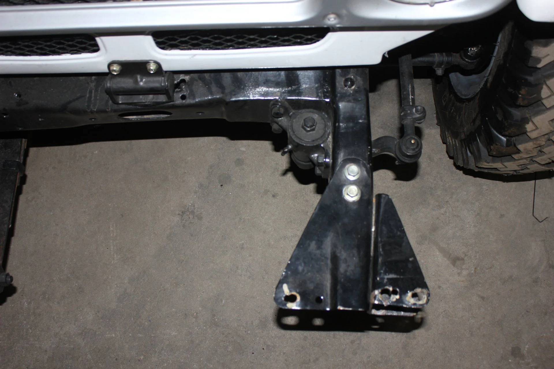

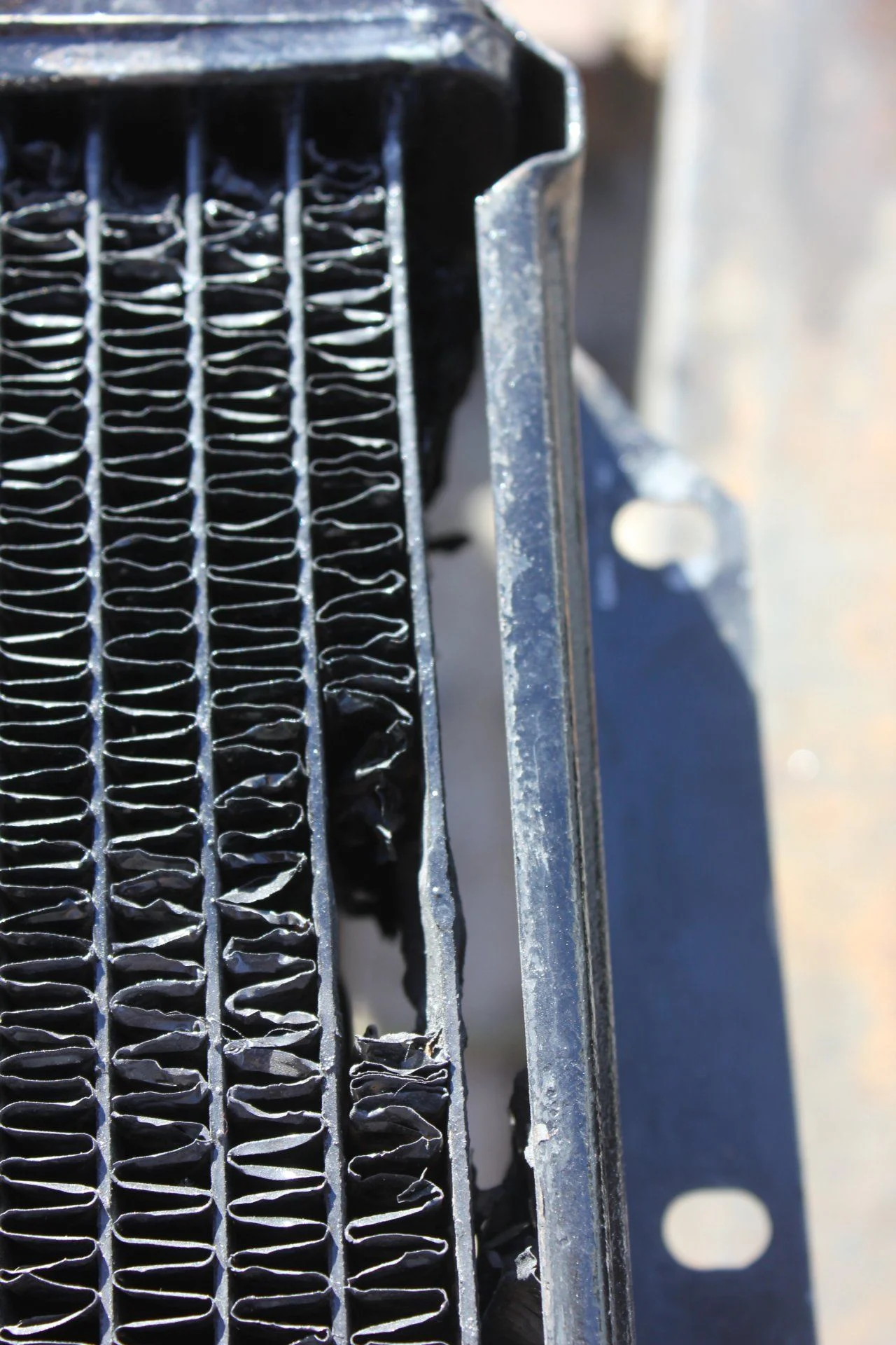

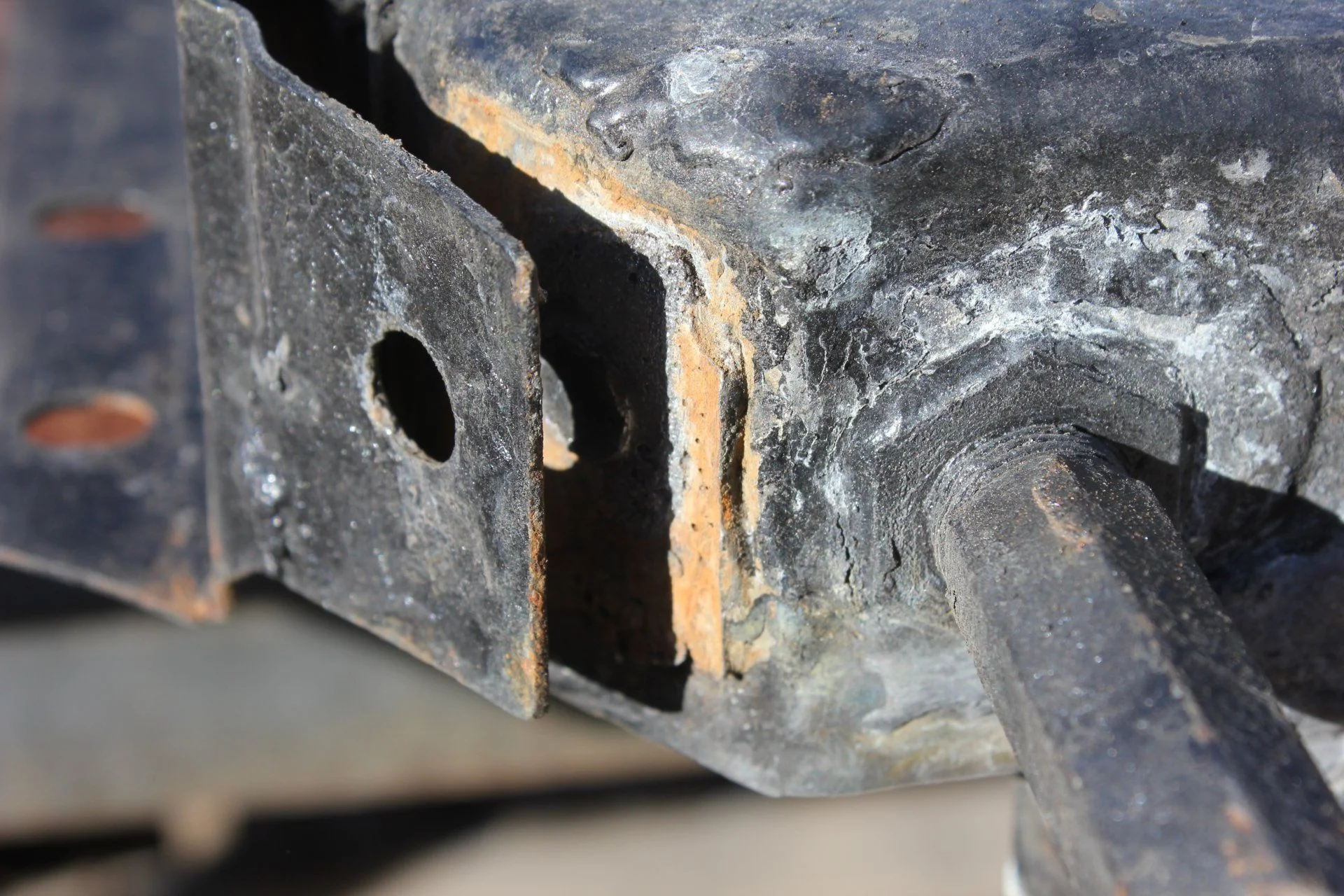

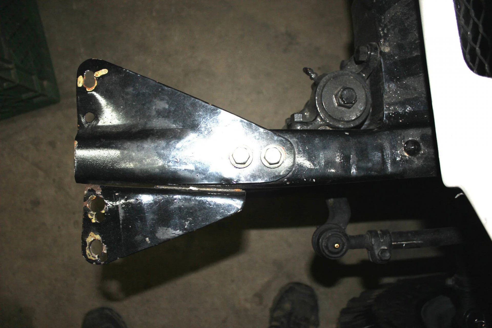

The last SA 40 series I worked on...from Fla.

All the soft brake lines were cracked and peeling. The shocks had no oil. No heater, speedo cable didn't have the internal cable.
With new paint and upholstery it did look OK from a distance.
The customer bought it of the internet and did not fly out to give it a once over. He bought it off the photos and description posted by a
"classic car" dealer in Florida which stated that it had a new OME suspension and ground up restoration.

Gives new meaning to "ground-up" restoration--the parts look they went though a meat grinder.
Looks like our friends in South America only use "certified" mechanics--their mechanics should be certified. And yes, you can count on the "classic car" dealer who gave it a 100-point pre-purchase safety inspection--from 20 feet away ! This is only topped by the inspection of some fuzzy photos by the buyer 2,000 miles away.
Common sense.............Priceless.
