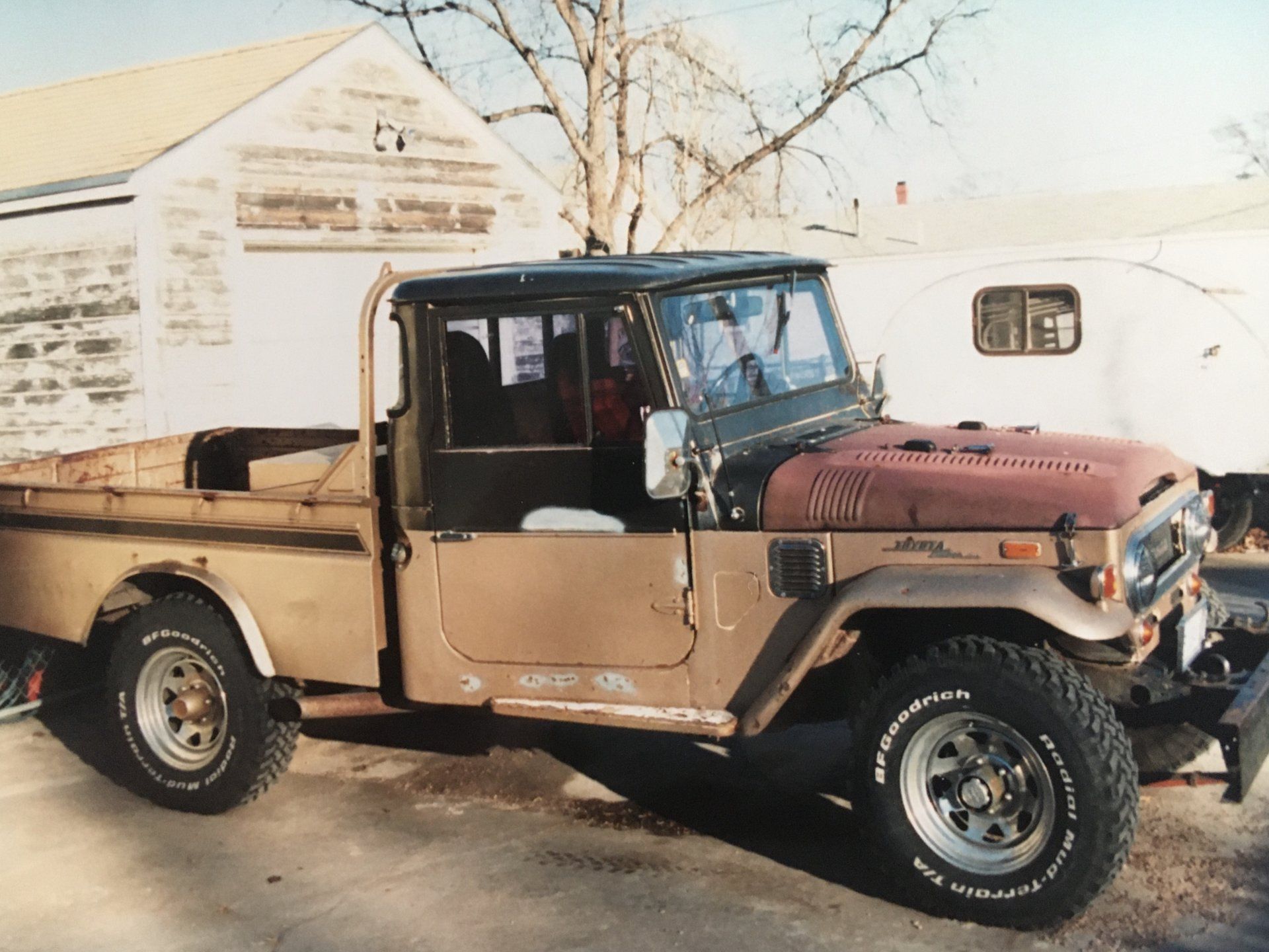

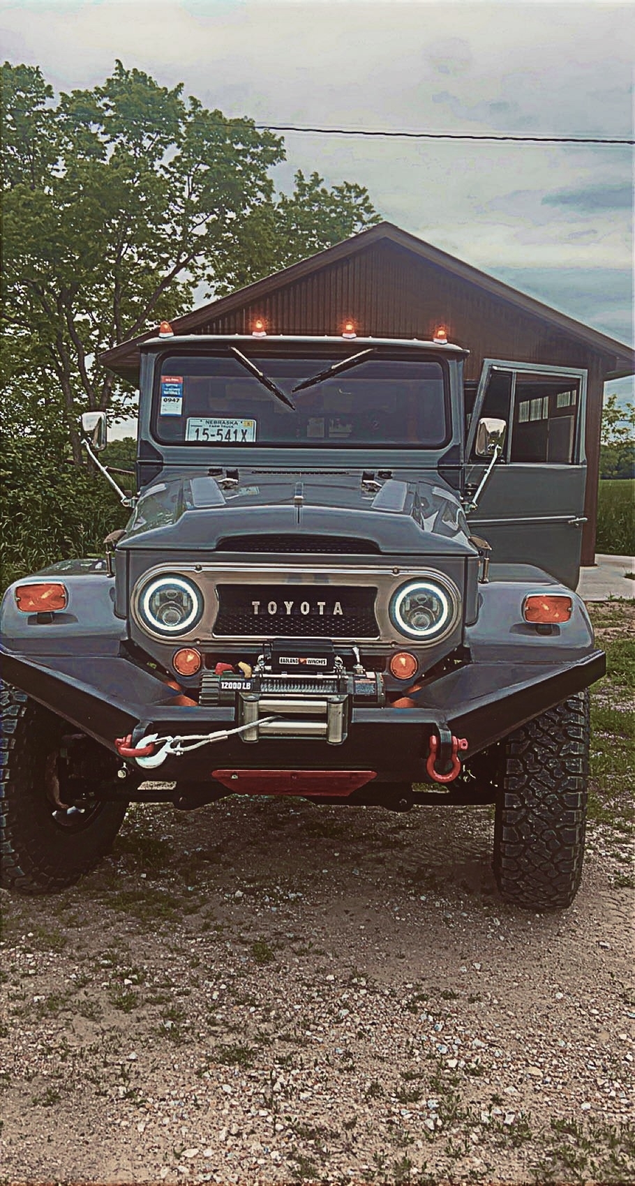

What ideas lurk in the mind of this man ? Only the “FABRICATOR” knows.....! Alan is the name, and fabricating is his game. Gazing deep inside his cranium, let us behold what he has done with my ‘67 FJ45 :
From this....
To THIS...!

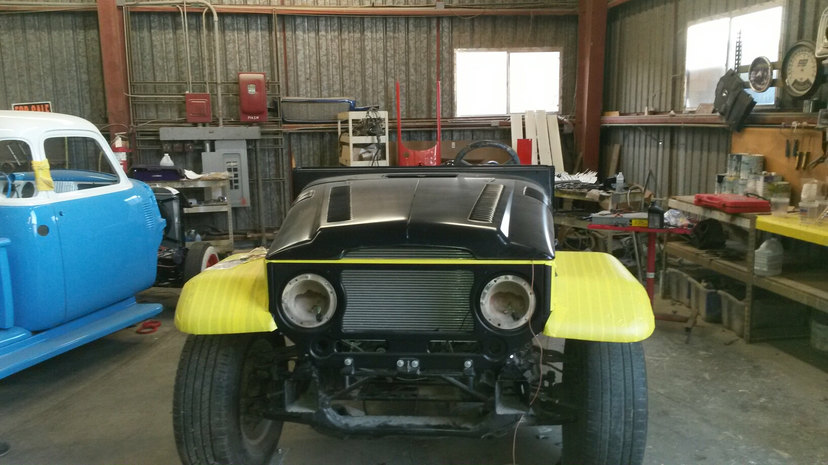

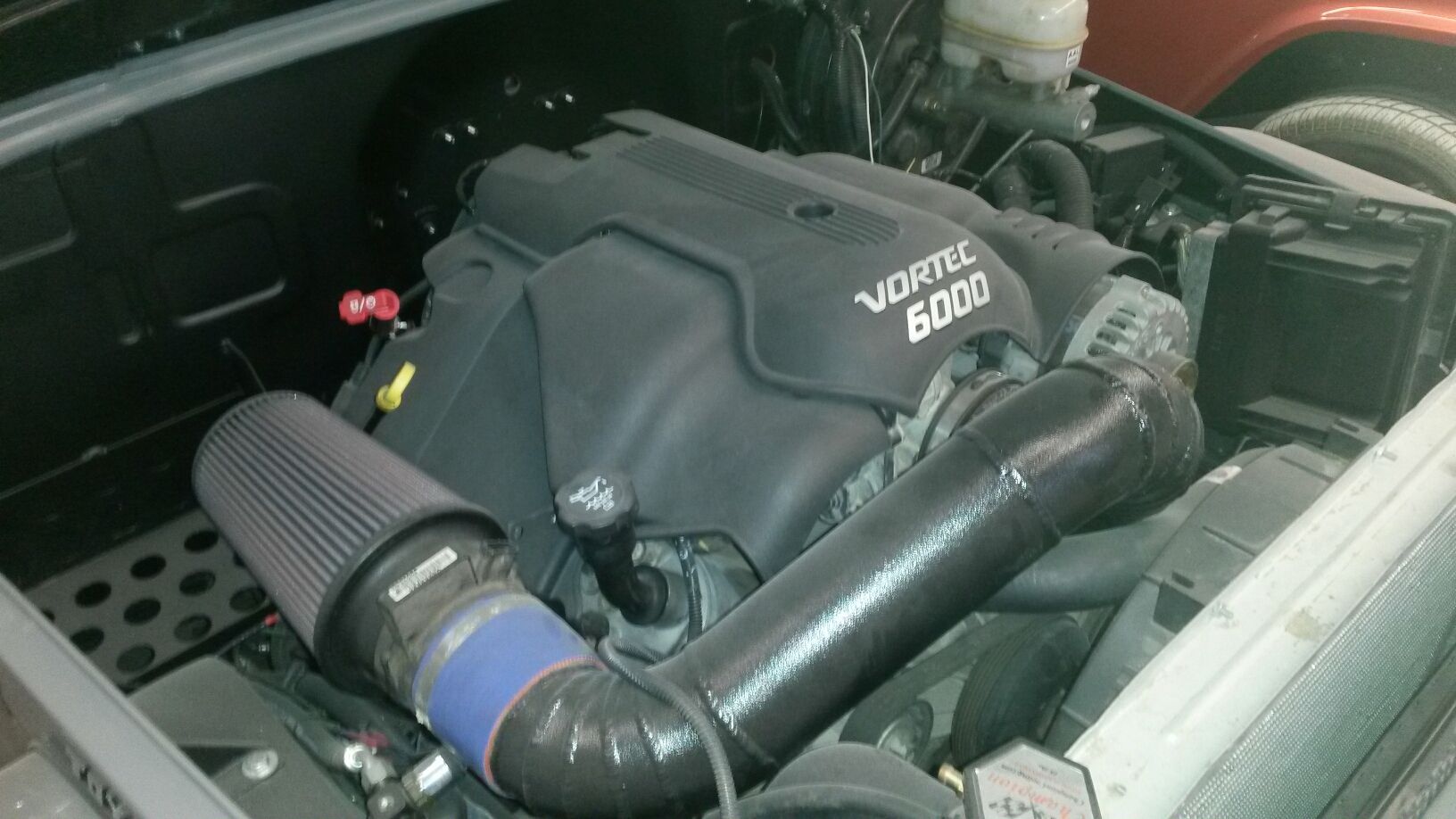

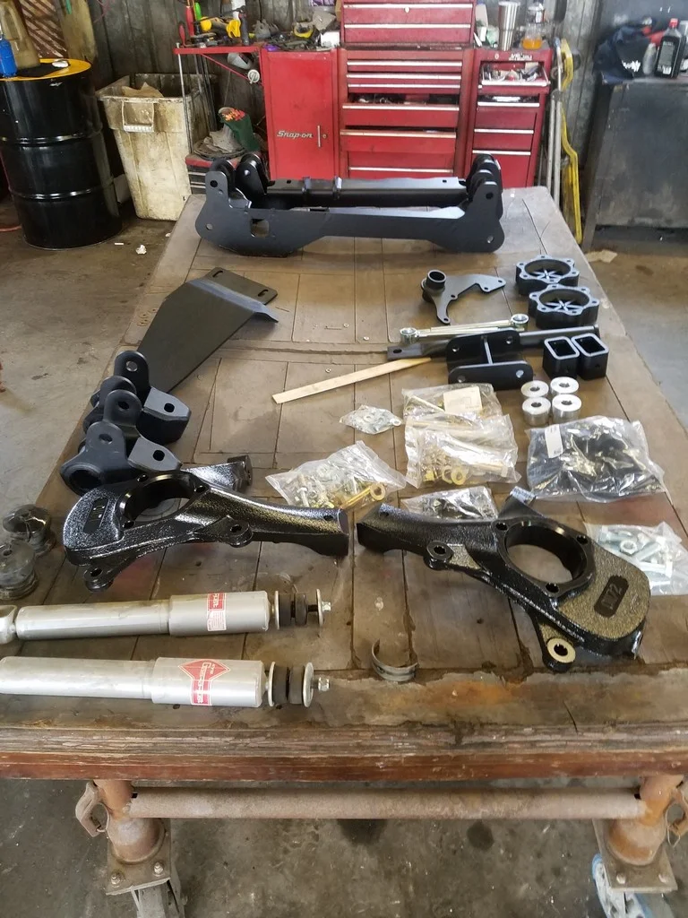

An unconventional build to say the least, using a chopped 2006 Chevy Silverado chassis, & skillfully commingling the old with the new.
Chevy 5.3

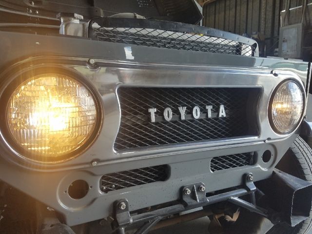

Who else could devise the infamous “Curmudgeon Crotch Saver” ....to fit where is doesn’t belong !

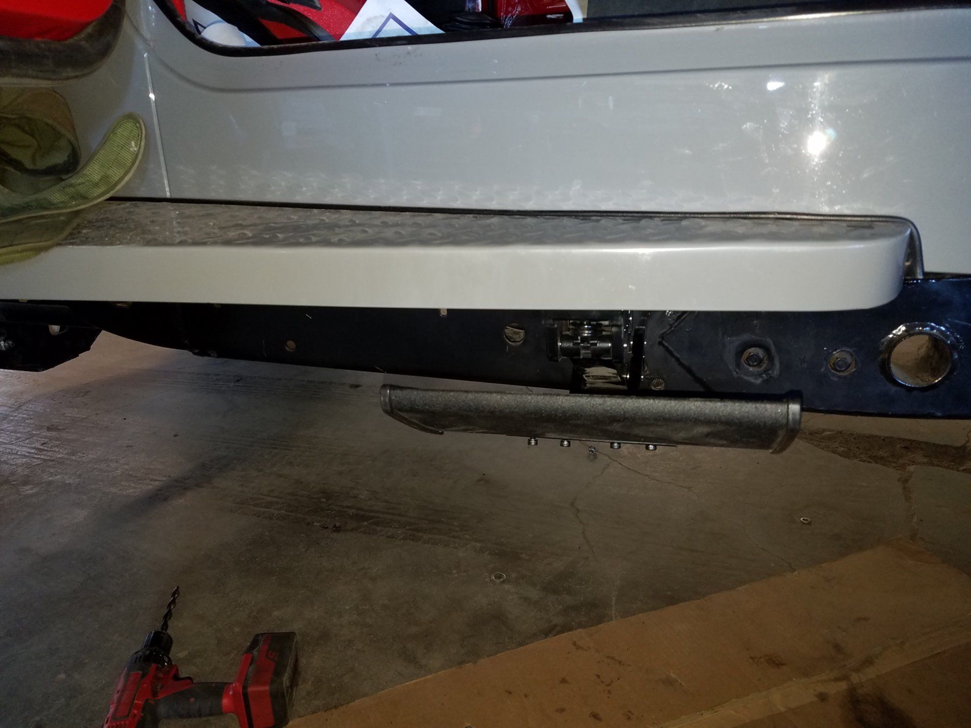

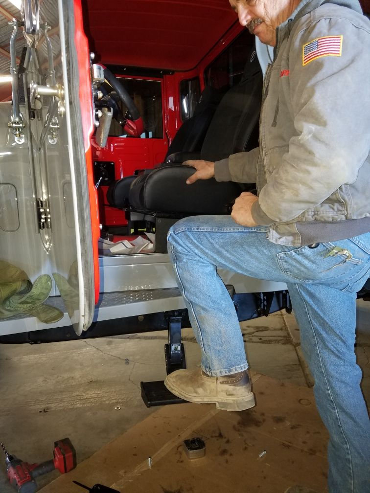

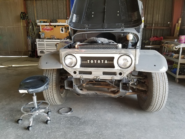

Using Bestop’s “TrekStep” a spring loaded mechanical, retractable step assist will be my salvation when crawling up into the cockpit. I was confident knowing full well that Alan could fab it to operate on ANYTHING that needed a step assist !
The “Hood Assist” yet another handy feature, conjured up from the deep recesses of the mind o_O of the......“FABRICATOR !”
Making life easier for an old curmudgeon’s such as myself ! :clap:

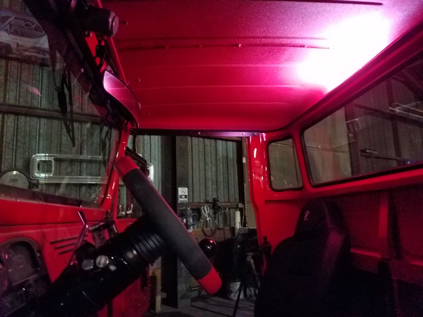

Yet still another feature is the placement of an l.e.d. engine compartment auxiliary light moved to the interior, providing ample visibility 👀 & soft uplighting inside the cab.

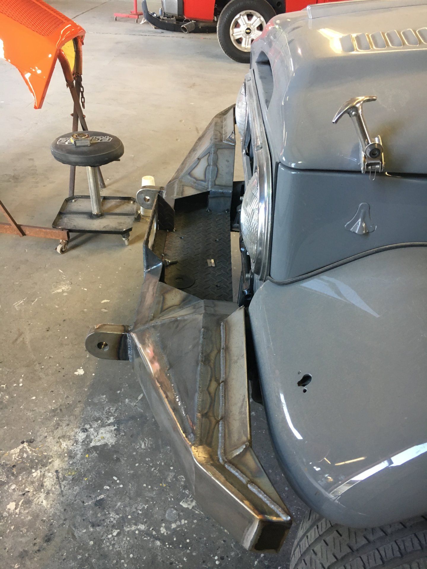

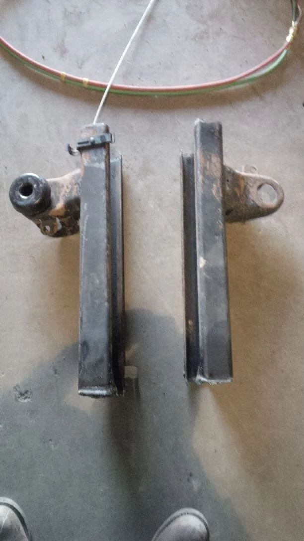

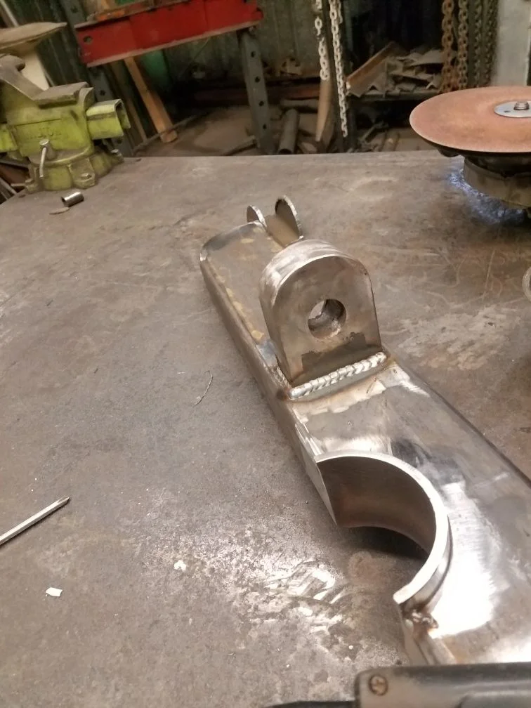

Front Bib hinge, here displayed, was fabricated by Alan’s son...Tyrel, obviously a chip off the ‘ol block ! A important component in weight distribution after additional metal was added to widen the fenders to compensate for the additional 9 inches of width, that the Silverado chassis contributes to the build.
:steer:

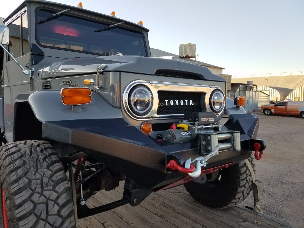

The “Bullish bumper”... multi-faceted angle welds.
Distinct & one of a kind
Finished product ..

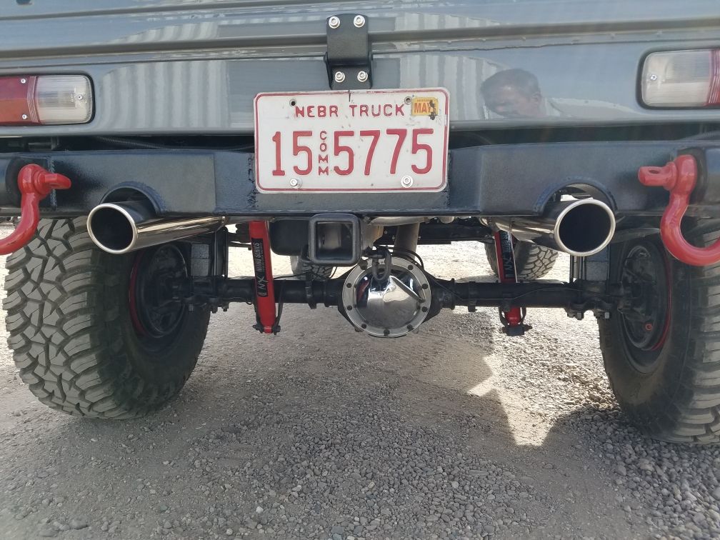

Rear bumper with exhaust “cut outs.” Job well done, one last final detail.....bring it home to Daddy !! :steer:

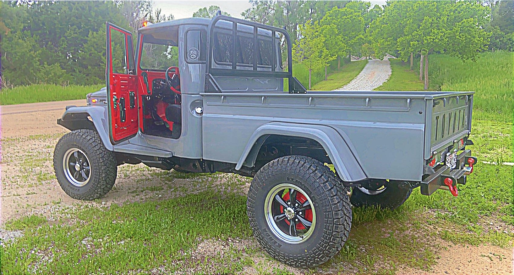

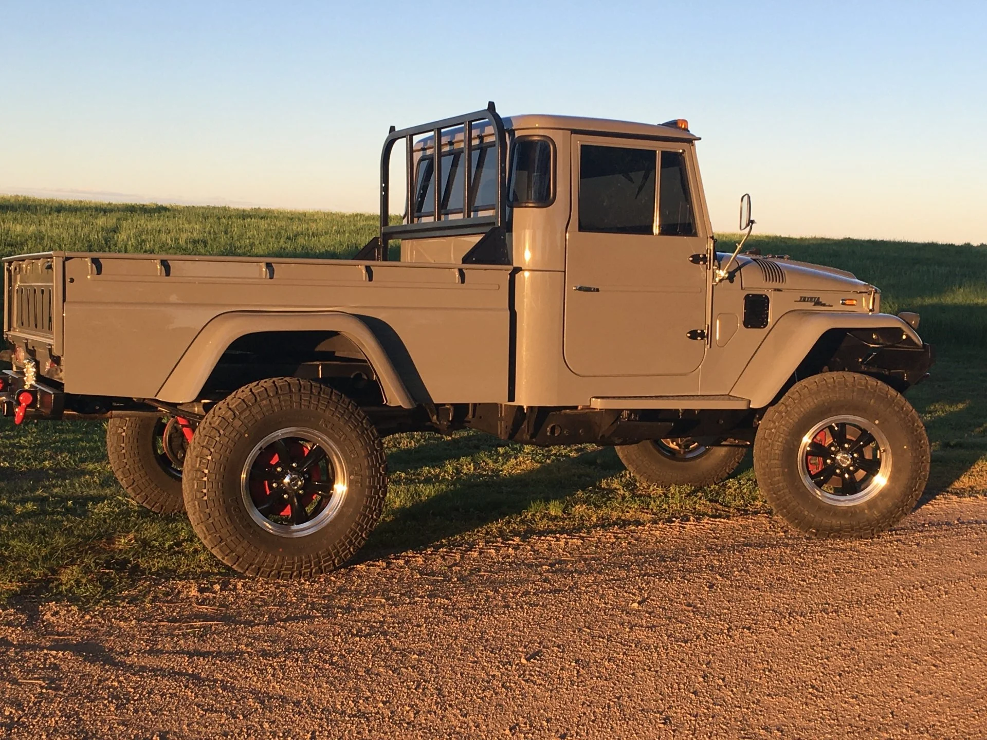

:steer:GroundEater made it home 🏡 May 28th, 2020 after a long 9 years of total transformation. Somewhere fairly late in the build l decided that the long box was kinda ugly....
This was the picture
that convinced me to chop, chop !!

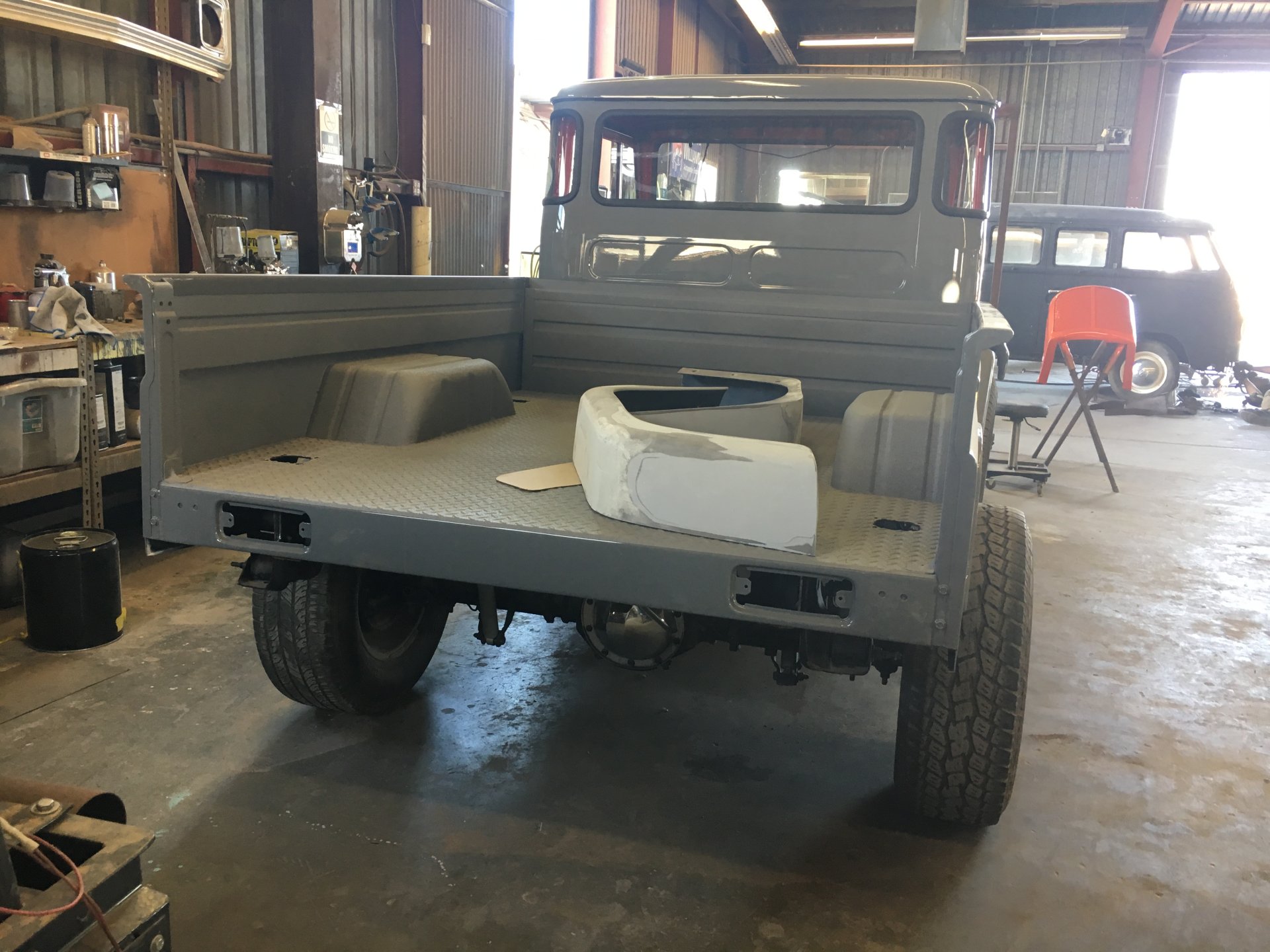

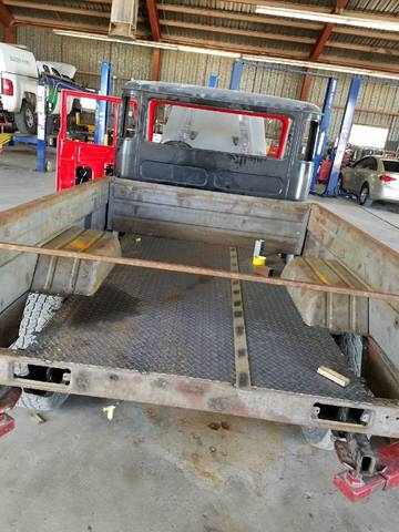

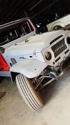

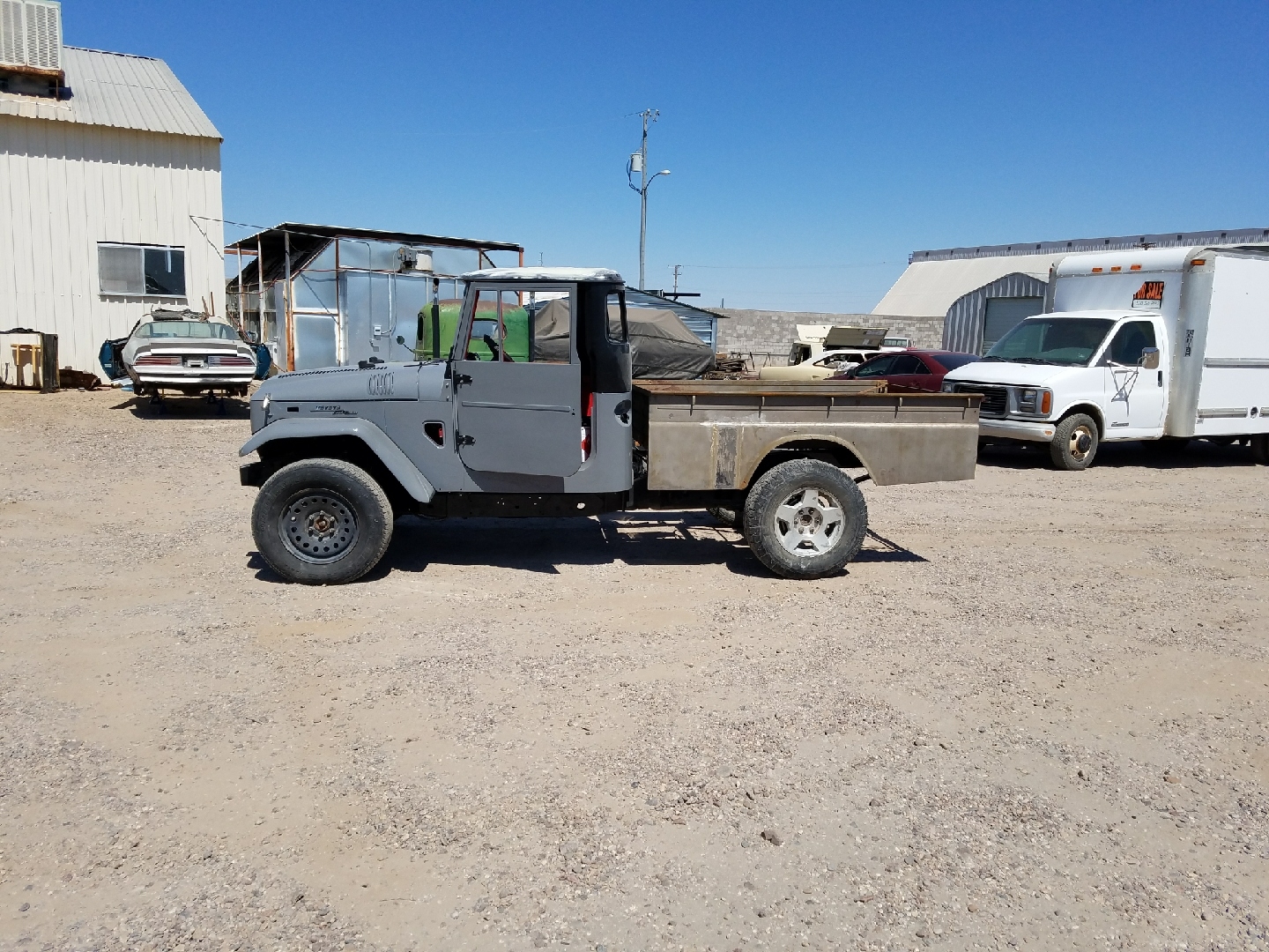

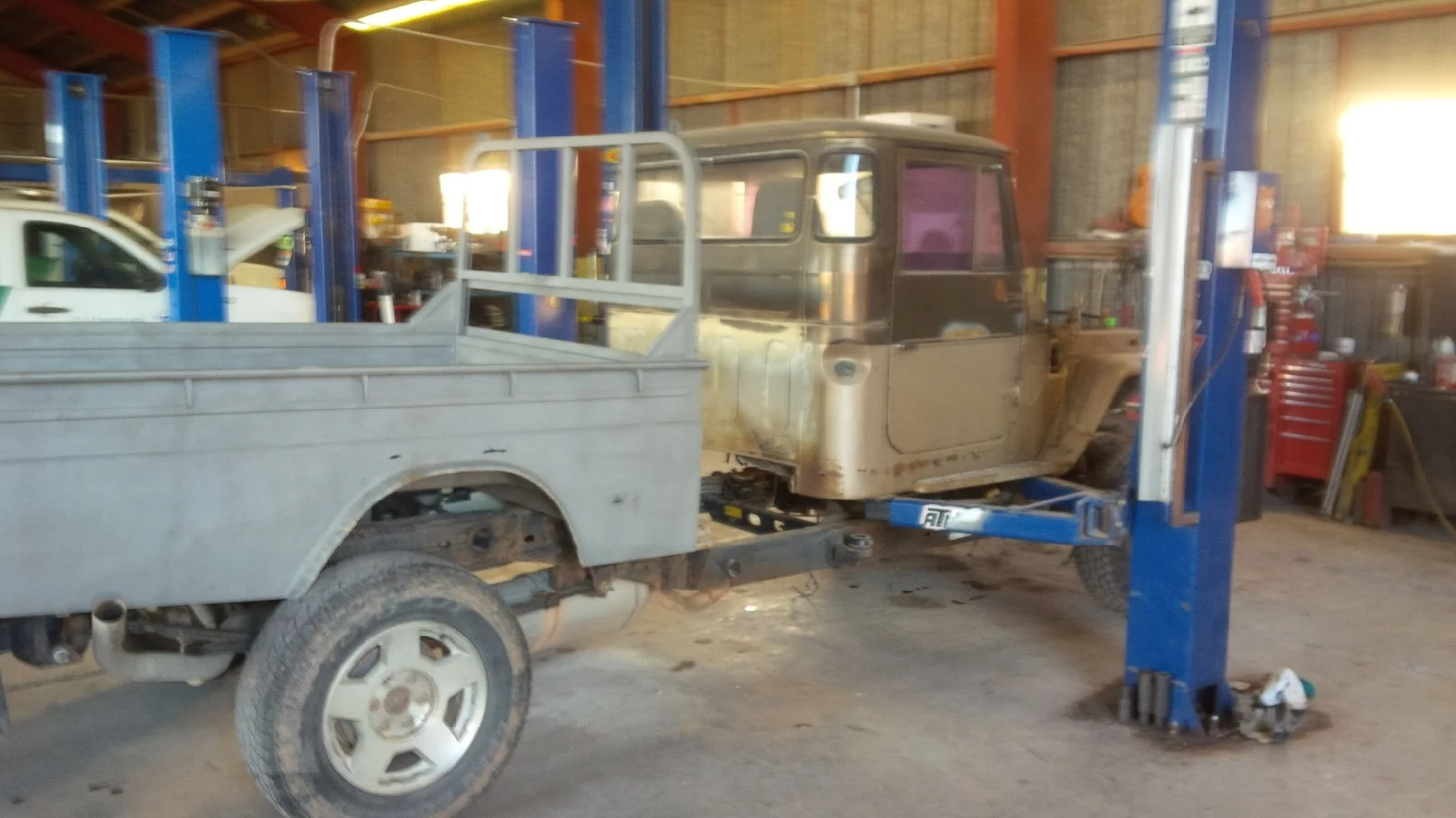

...no regrets, we proceeded to lop off 7 inches. I was glad that even though it was a late decision, they were still able to pull it off.

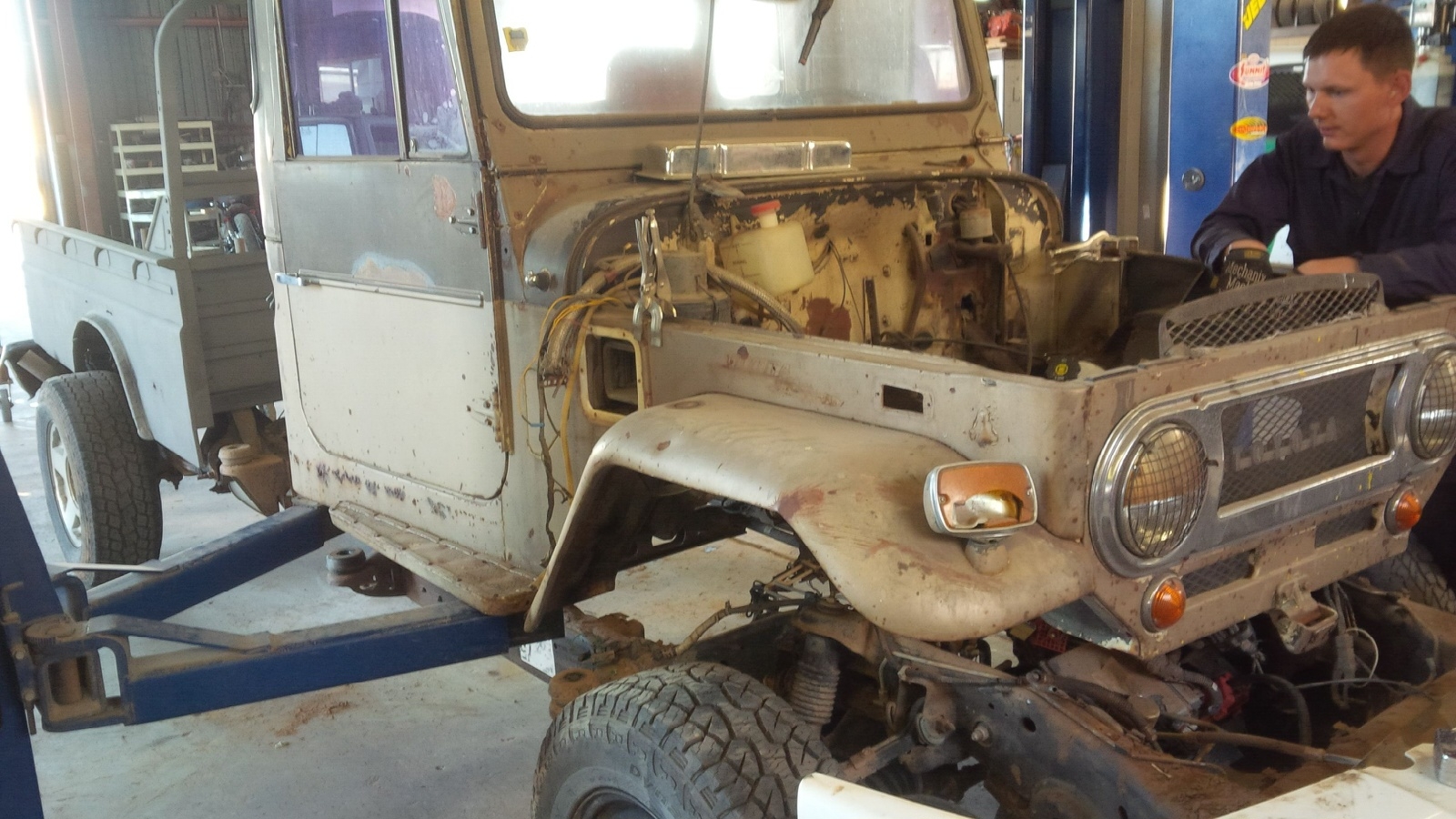

This’ll be a different thread than any other, because I wasn’t even there

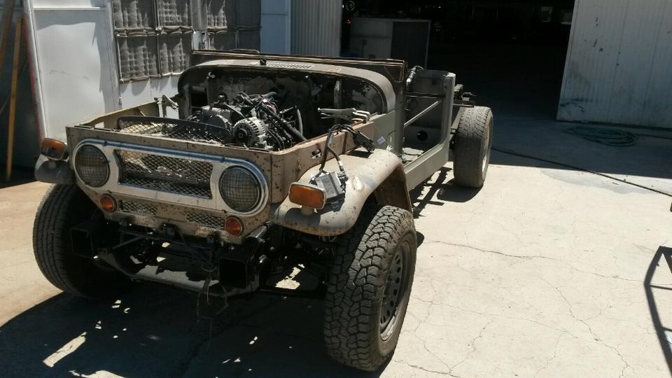

Over a foot off the 2006 Chevy Silverado frame...
...for me, seeing these photos for the first time from Arizona, things began to L👀K kinda interesting.

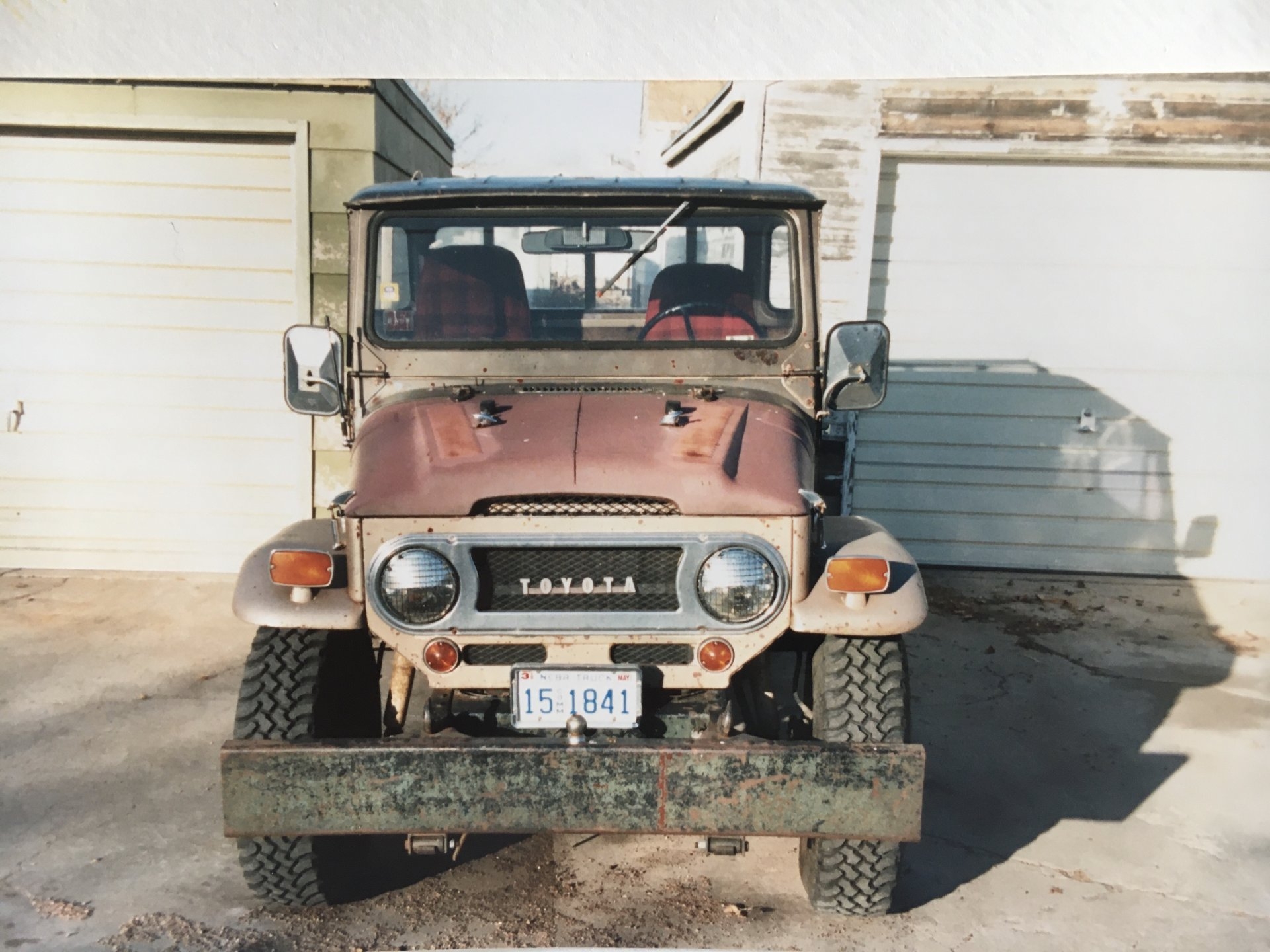

🇺🇸 Purchased in Grand Island, Nebraska in 1981 for $2350 never regretted it. They’re built tough, with heavy metal. Once parked next to a brand new Dodge pickup back when the new ram body style had just came out.
Big hail storm came through & trashed that Dodge, my Landcruiser stood tall...no visible damage. 👍🏻
____________________________
Late ‘80’s...here’s the only known pic of GroundEater in captivity 🤣 !!
Circa 1992...👇🏻
Fast forward to 2011...👇🏻

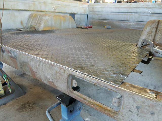

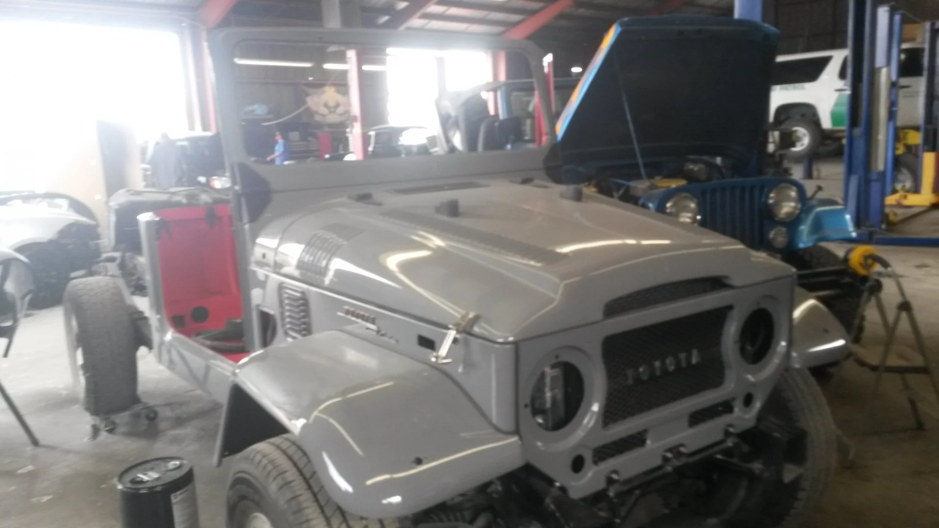

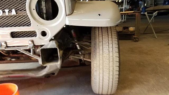

I think that it’s worth mentioning that the Chevy Silverado frame was approximately 9 inches wider than the Landcruiser frame was.
This required the fenders to be cut down the center and be widened with a 4 inch strip of metal.

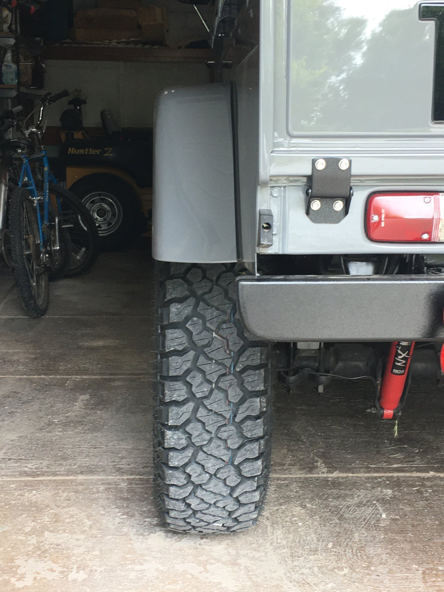

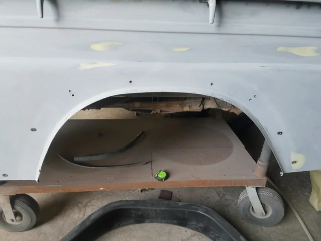

✨FENDER FLARES✨
Keeping things tidy and pleasant to the eye, the rear rounded fender
L👀K had to go, enter..Jeep’s 7 inch fender flares.
