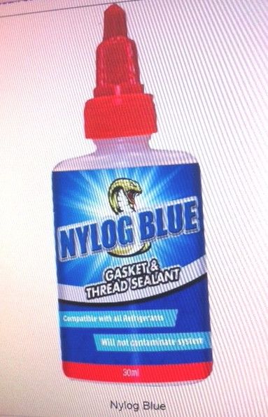

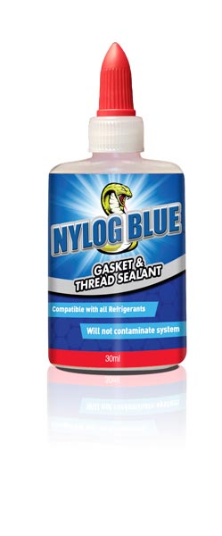

When replacing O-Rings and reconnecting fittings do yourself a favor and get a bottle of Nylog. One bottle will last you a lifetime and you won't have leaks from O-rings or connections.
Also, remove your schrader valves at all service ports and replace them with new. Use Nylog on the threads and also your service port caps (when finished recharging).
I have no affiliation with them....its just a good product that folks outside of the HVAC industry are mostly unaware of. I never do A/C work (lines, connections, O-rings) without it.
So you coat the o-rings with the Nylog instead of the AC lubricating oil?
Yes, and also put some any mating surfaces that join together and any threaded parts. It will stay flexible forever, will not make parts hard to disassemble later (easier actually) and is completely compatible with refrigerants (don't worry about getting into the system).
O-rings and Shrader Valves (and caps) are common leak points. Corroded lines, damaged Condensers, Corroded Evaporators...probably next. Front seal of compressor is usually a slow leak...but nearly last on the list.
A/C work in usually a PITA and not something you want to have to do twice. Nylog is cheap insurance you won't have leaks in areas you have used it.
