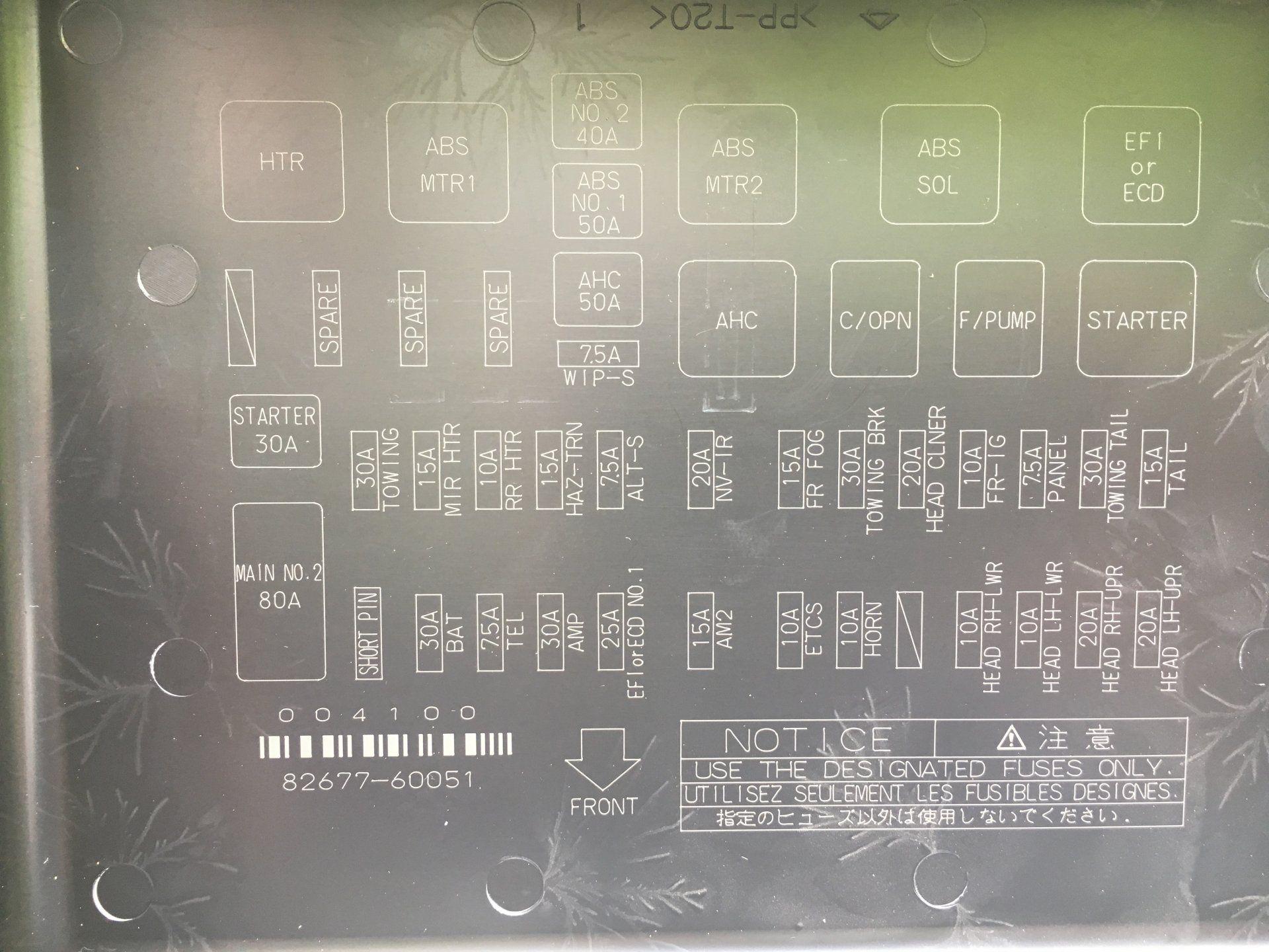

2000 LX. A/C light blinks after compressor engages for about three seconds then disengages.
What I DO know so far...... thanks to the generosity, knowledge and guidance of @flintknapper is......
--The compressor will engage fine when jumping the relay.
--The relay is good (tested in other vehicle)
--Front A/C amplifier is good (tested with known good source)
--Rear A/C amplifier is good (tested with known good source)
--Pressure switch is good
--Freon has been evacuated, filled properly and tested with no leaks
Anything else you guys may have run into or anything else to check that comes to mind ??
Thanks a bunch.
