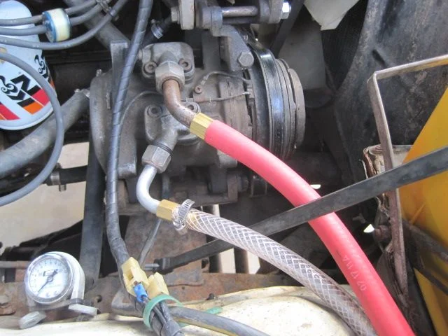

The trickiest part for my method is threading the ends from your A/C hoses so that you can screw on the brass fittings. I cut the aluminum ends off as long as possible and gently clamped them in a vise, the small one is the discharge and is very close to the right size to thread it for 1/4" NPT (tapered pipe thread) At work we have a set of pipe dies so I did it over lunch break, use a little cutting oil and get it as straight as possible. The larger one (discharge) is a little on the small side for 3/8" NPT but it won't have any pressure so the couple threads that you can get on it with a die is enough. You can get thread cutting dies at a hardware store or fastenal. Usually they have a hex shaped body so you can turn them with a large wrench. Use a little teflon tape and put the brass fittings onto the intake/ discharge pipes so it looks something like this.

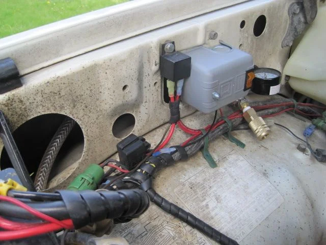

I ran all of the hoses inside the fender so as not to have a cluttered mess. (I'm anal about that kind of stuff.) It's kinda tricky to get the hoses all attached and hose clamps tightened inside the fender but with the right order of assembly it can be done.

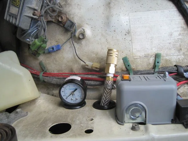

Use the grommets to protect the paint from scratching and absorb any vibration (not that our fantastic 2f engines aren't smooth as silk...)

For the wiring I used 16ga wire and went from battery, to fuse holder with 15A fuse, then to the orange rocker switch, then through the contacts on pressure switch, the used a spade terminal to connect the the factory wire to the compressor (see first pick about 8 inches from compresser up the string of wires.)
(to avoid confusion that relay right next to the pressure switch is not a part of this system, just another one of my hack jobs.)
