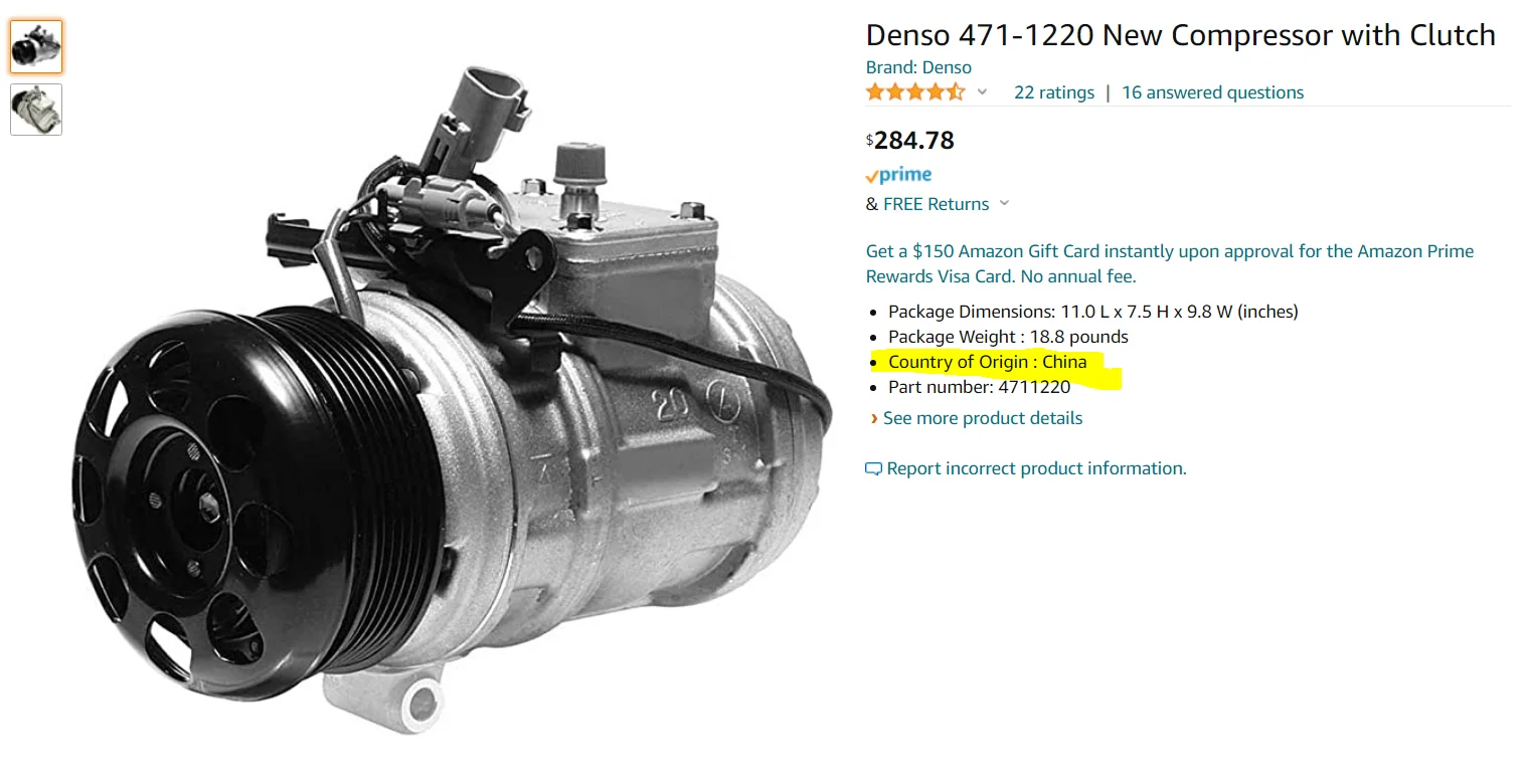

I'm not seeing much activity about a new Denso 471-1220 compressor. It looks like Denso moved their compressor manufacturing to China.
My latest Toyota A/C replacement success story has been with a compressor brand from Korea named UAC that I bought at RockAuto.
Does anyone have experience with a new Denso 471-1220 compressor?

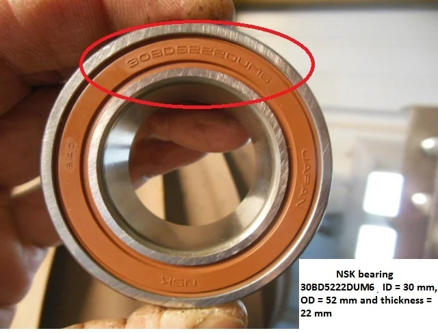

If you’re looking for a cheap swap, I’m 98% positive that 3GT4R bearing fits the 100’s compressor. Should be 30x52x22 mm bearing on both vehicles.
Also, I think @nissanh is who did the thread on replacing the clutch and bearing.
Thank you. It gives a way to fix it using a part that I already have in the workshop. 👍
I showed the replacement of the bearing. Do NOT use cheap chinese bearing. I used it once and lasted only 6000 miles. The dimentions are given above. I think those bearings are made by NSK.

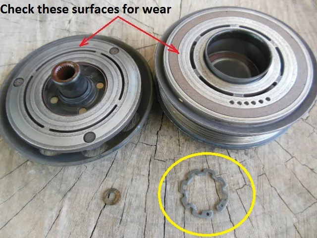

Also, the clutch surfaces themselves should be checked for wear or scoring before considering replacing only the bearing.
Thank you. for the pictures. I ordered a new NSK 30BD5222DUM6 that should be arriving on Tuesday.

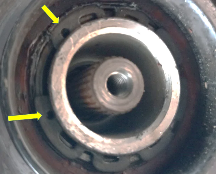

Once you remove the 10 mm center bolt, you'll reomve the circlip. From my experience, I had the most difficulty removing this circlip due to the straight plier I used. I did not remove the fan bracket to replace the AC bearing. You can pull the pully off by threading a 12 mm bolt into the enter of the pully.

I had to buy better external circlip removal pliers. Here's a picture of the circlip before I removed it.
Ok. I got it out. It didn't want to come out without a twist. My puller is too large. I need to find something different to pull the pulley.

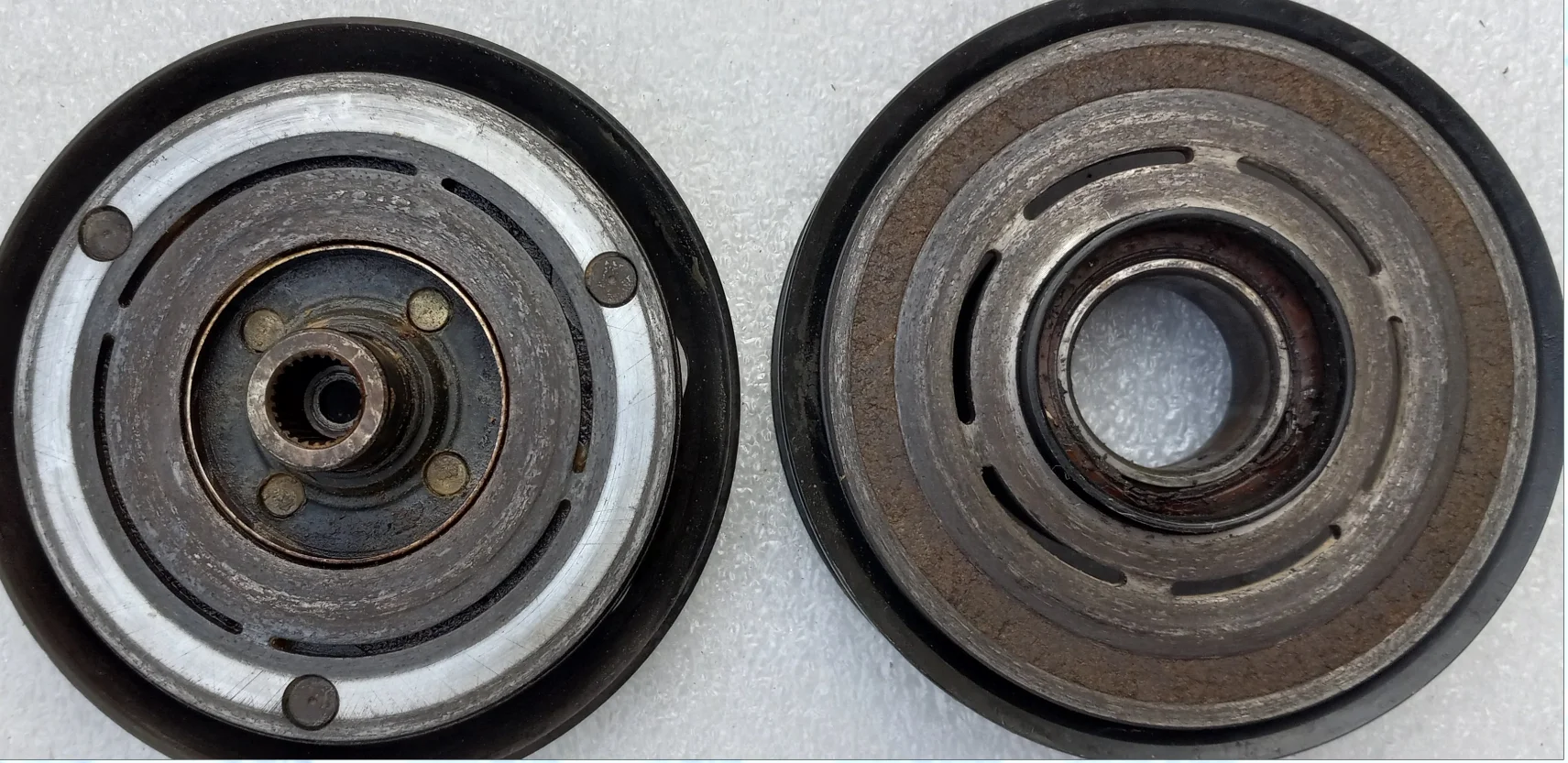

How does this clutch wear look to our experts?

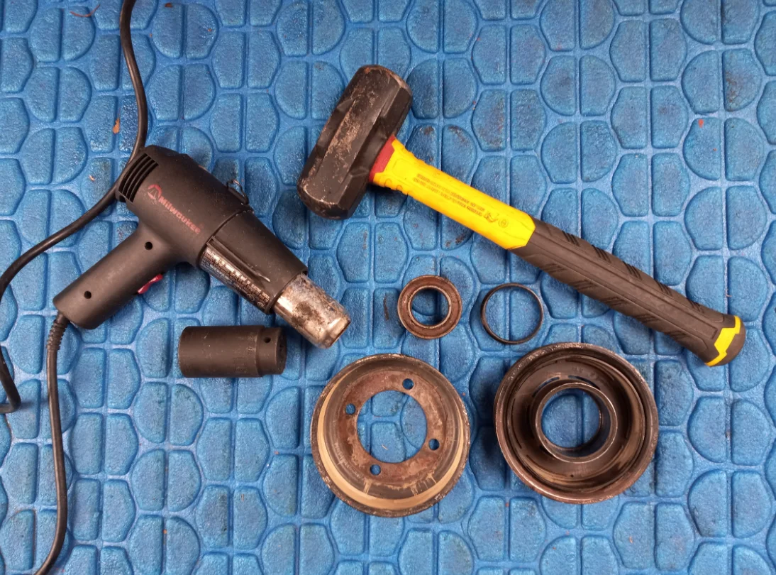

With out a press, (and this isn’t the perfect procedure) but you can tap the old bearing out with an appropriately sized socket. Freezing the new bearing for 30min to insert using the reverse method- just being careful to have the socket riding on the edge of the outer race- taping into place.
It worked. Here's the secret sauce.
Milwaukee heat gun to heat up the pulley body.
30mm socket.
Hammer - 2 to 3 smacks
The old fan pulley was used to keep the other pulley up and off and away from the concrete floor while I tapped the bearing through the old pulley.
Pulley can be substituted with an old brake rotor.
Two blocks of wood side by side with a gap between them also works well, but a vise is the ticket.
Oh, I forgot that I have a vice. I'll use that on the installation. I didn't expect removal to be this easy. :bounce:
