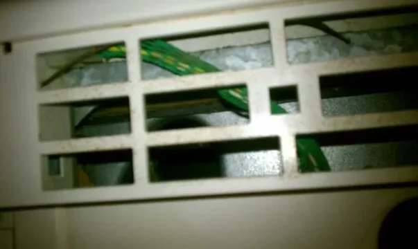

How about some pics of what you got?
Identifying the wire size for t-stat control may identify if it is line/low voltage.
Plethora!
pics
I was hoping for pics of the electrical components, any chance you want to email coleman for a wiring diagram/schematic? I did a quick google search and didnt find anything.
I guess to be more specific it would help to see whats there (electrically) for the fan and for the compressor, and whats there for the thermostat contact/controls.
