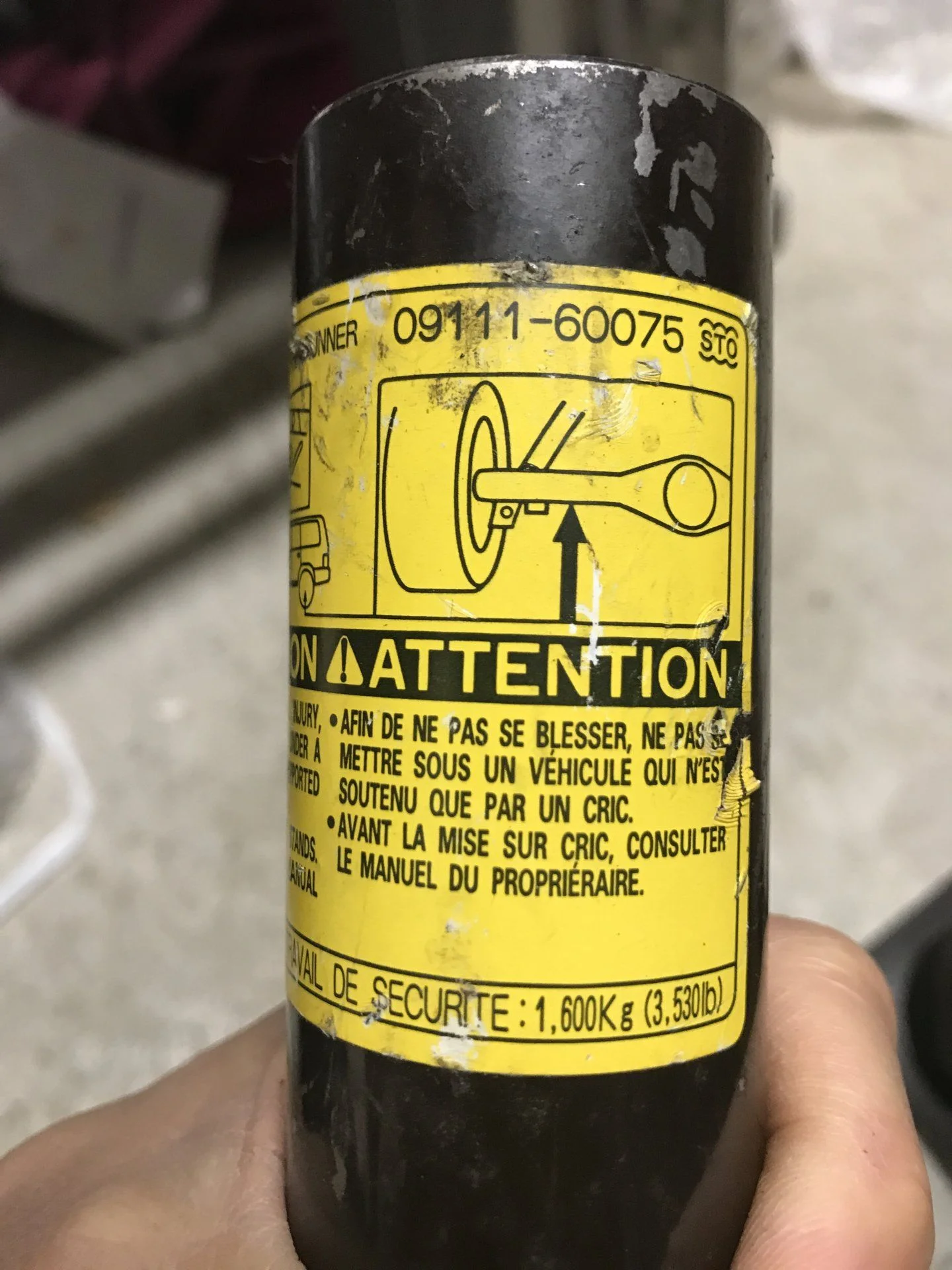

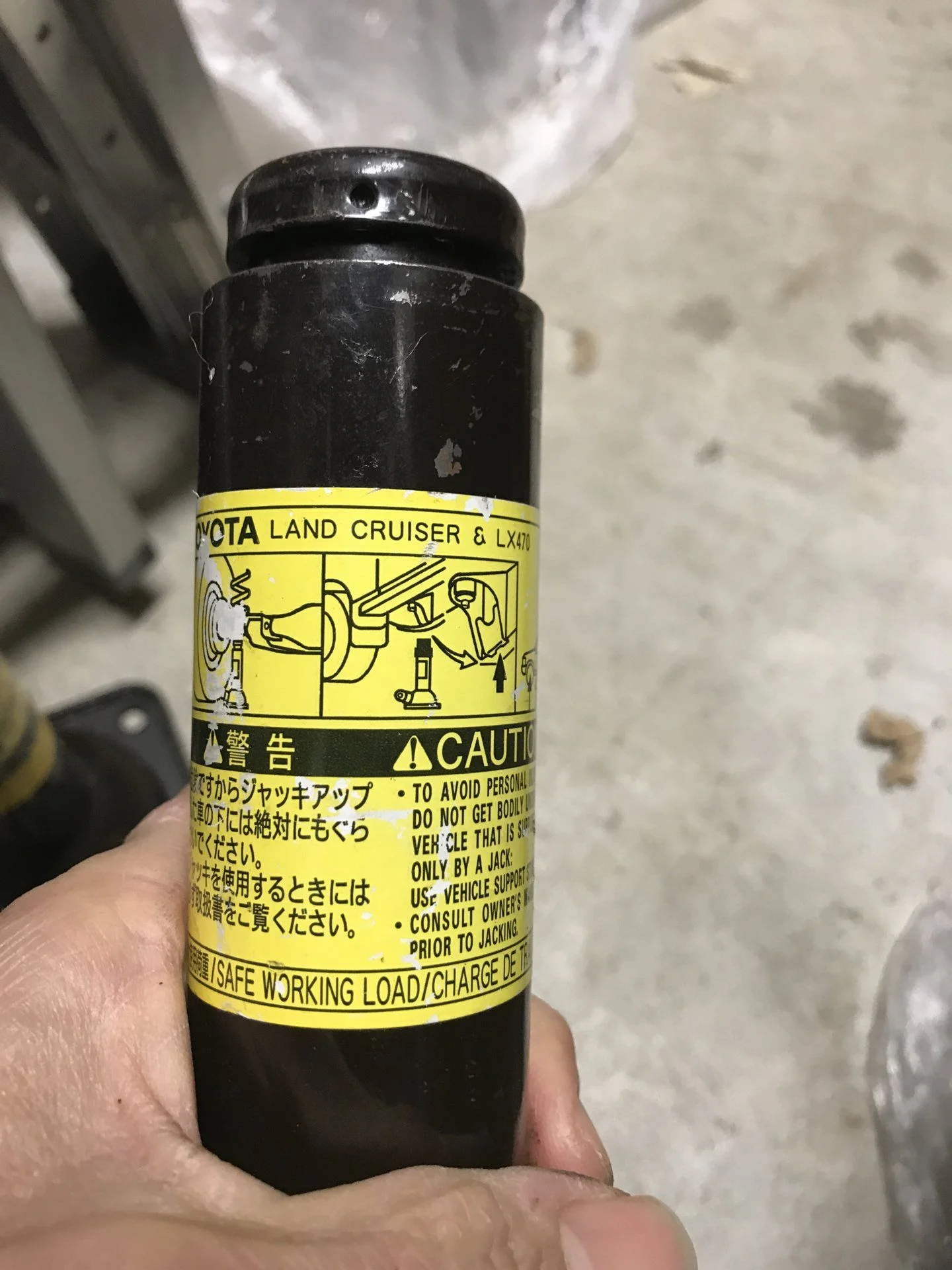

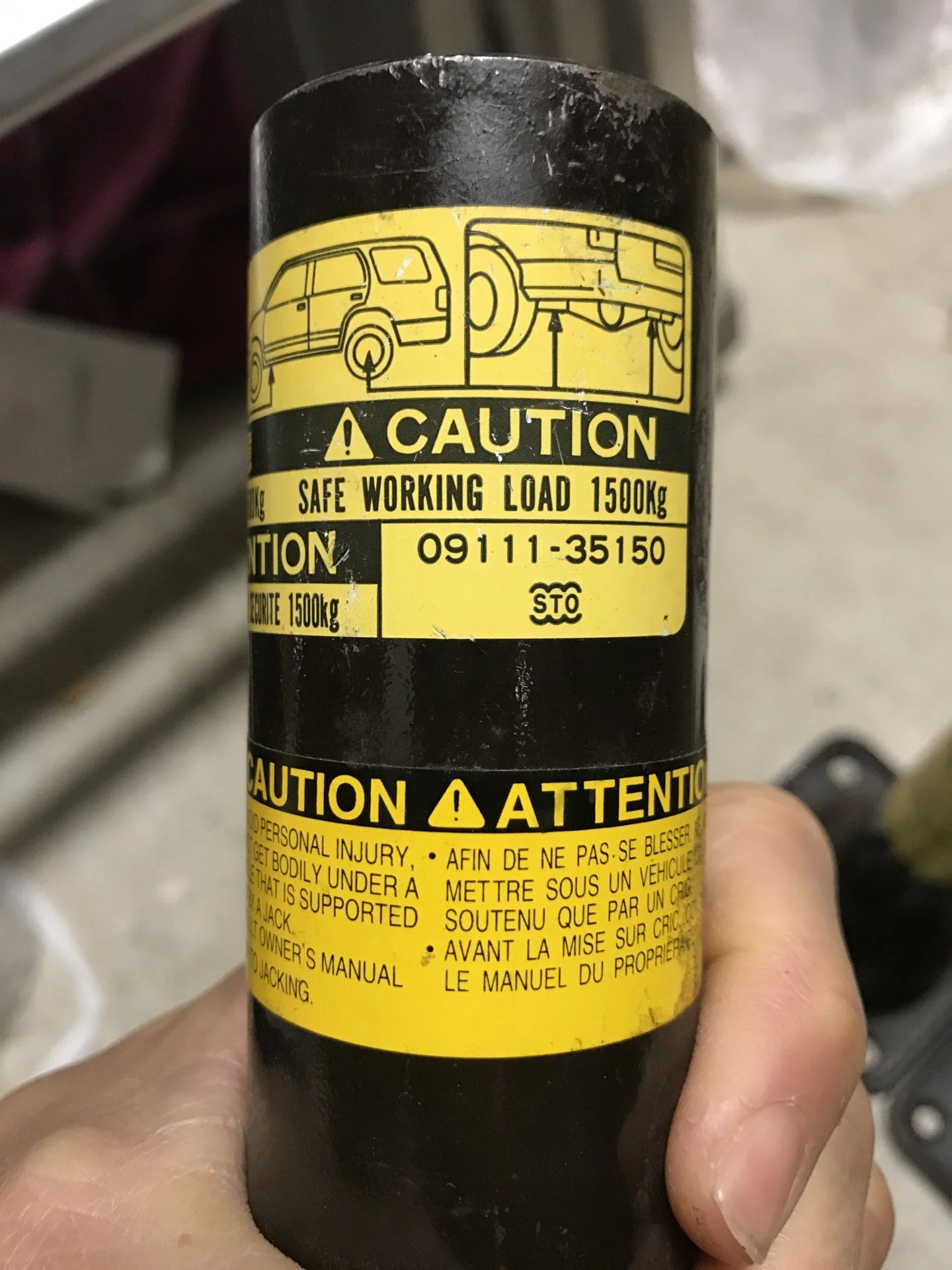

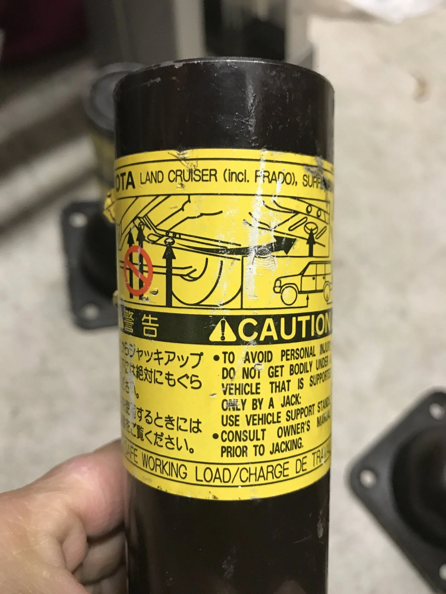

  6. ranma21
    ranma21
    Messages:
    2,555
    Likes Received:
    331
    Joined:
    Apr 18, 2005
    Location:
    Houston, TX
    IMG_1773.JPG IMG_1774.JPG IMG_1775.JPG IMG_1776.JPG IMG_1777.JPG I have a few of this jacks, went to garage and take a good look of the few I have. The part number for 100 series is 09111-60081 rated for 1800KG (3979 lb), another one is for Land Cruiser ( inclu Prado, Surf, 4Runner ), rated 1600Kg (3530lb) which is 09111-60075, the same one you saw on Ebay, and one more is from 4runner as well 09111-35150, looks to be 2gen 4runner by looking at the label, rated 1500Kg. And all look the same!!! Without label, you will have no idea the spec and which vehicle it belongs to! :rofl:

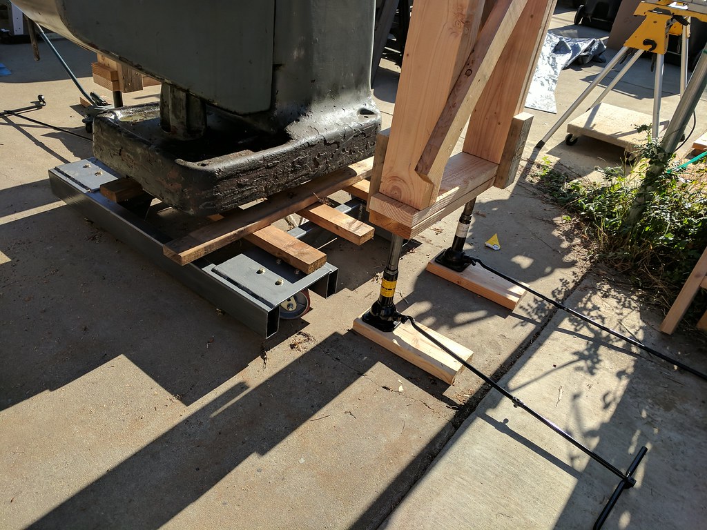

    While I love hydraulic jacks, nothing beats the durability and usefulness of the Toyota screw jack.
    I used 3 of them to lower a Bridgeport mill into a mobile base:
    [​IMG]
    I am always on the look out for more, their ability to adjust infinitely is so useful.
  8. ranma21
    ranma21
    Messages:
    2,555
    Likes Received:
    331
    Joined:
    Apr 18, 2005
    Location:
    Houston, TX
    IMG_1779.JPG All 3 side by side.

  9. calskibum
    calskibum
    Messages:
    110
    Likes Received:
    6
    Joined:
    Jun 8, 2009
    Location:
    Northern Ca.
    Thanks, all, especially ranma21's photos and comparison. Although the higher rating of the 69111-60081 is preferred, I guess the 3,530 lb rating on the 69111-60075 would still work for the purpose of changing tires (my LC is pretty stock). Thanks guys!
