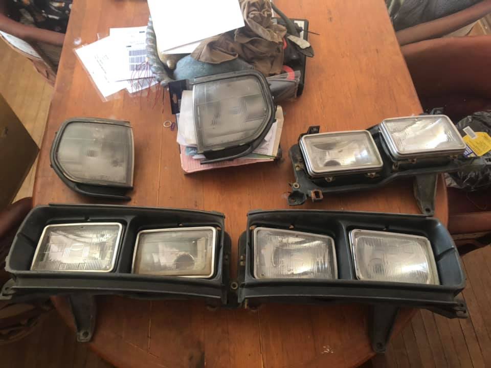

Always wanted to do quad headlights on this build, but had written them off as any North American retailer wanted what I consider too much to justify. Luckily, I found someone on an Aussie 80 series Facebook page who was selling a set privately. They just arrived today, can't wait to install these!
I have a set of these coming for my Lexus, can’t wait to get the installed. They are quite hard to find!

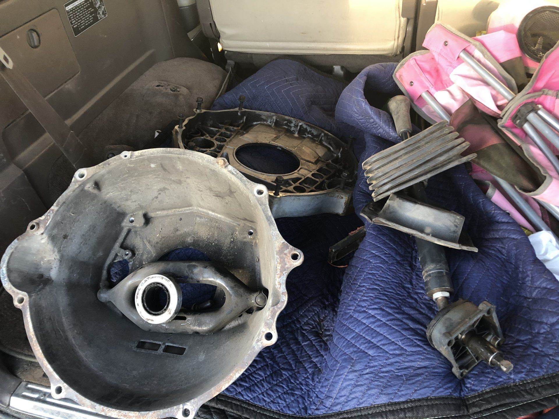

Made another trip to pick up a bellhousing for the 4500, turns out the fella had a lot of things I’d need to track down eventually. Just adding to the pile for now

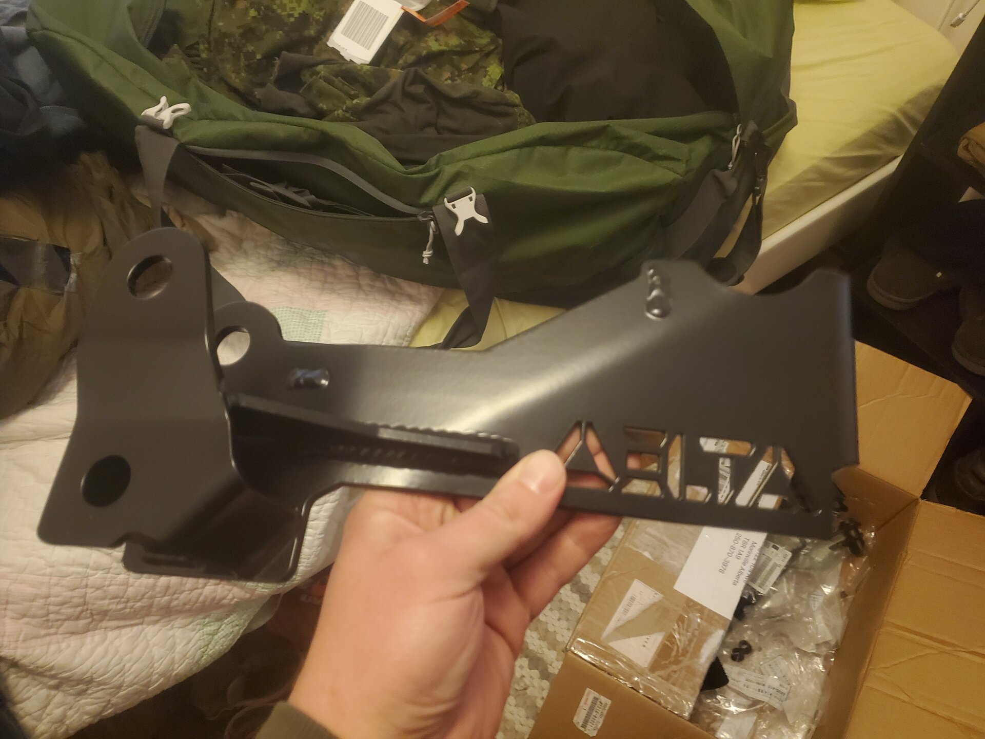

The rear panhard bracket came in from DVS

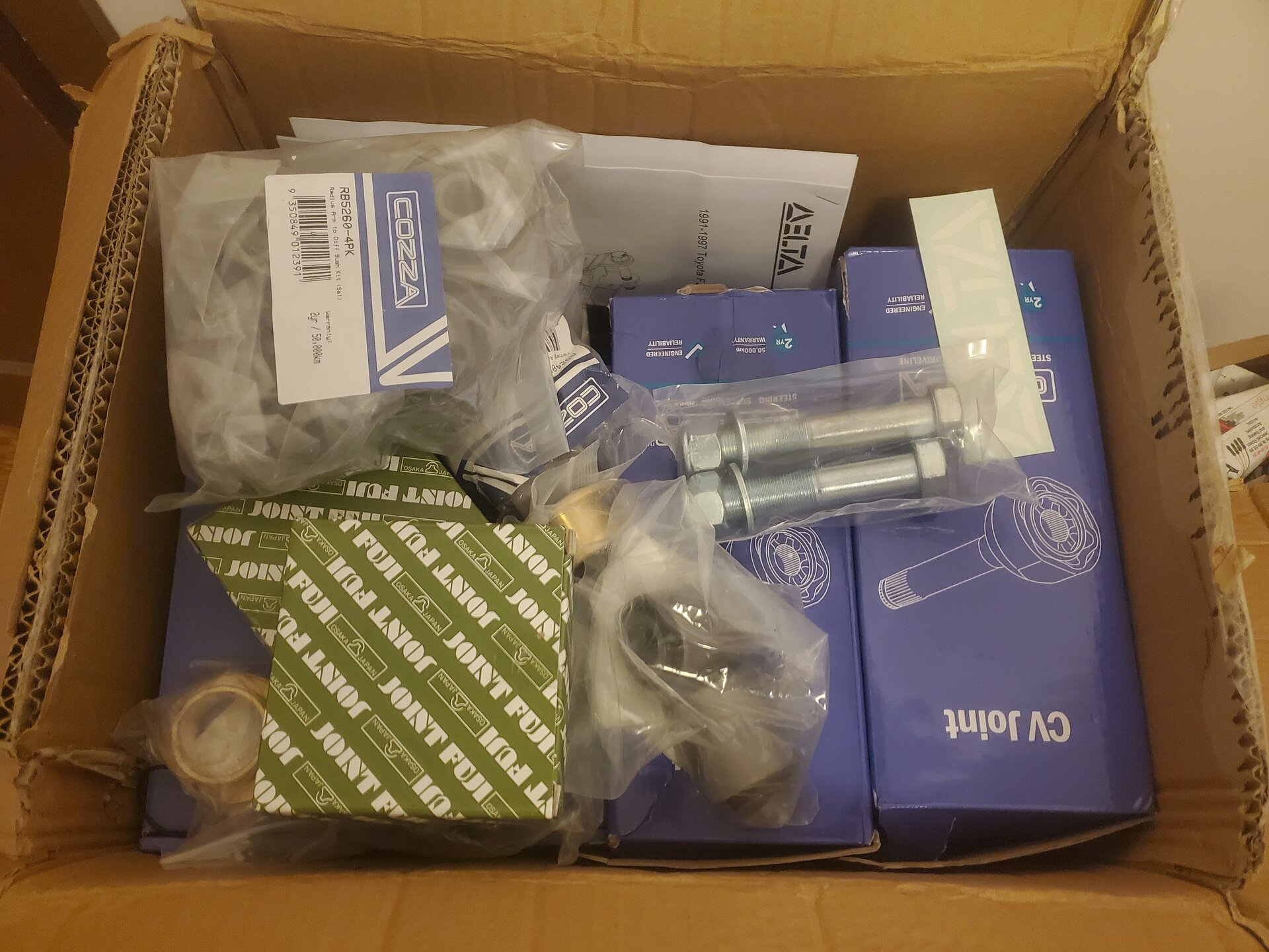

Also got a big box of front end parts from Australia. New bushings for the rear panhard, new adjustable front panhard, complete front end rebuild kit with bearings and Birfs, and front sway bar extensions
