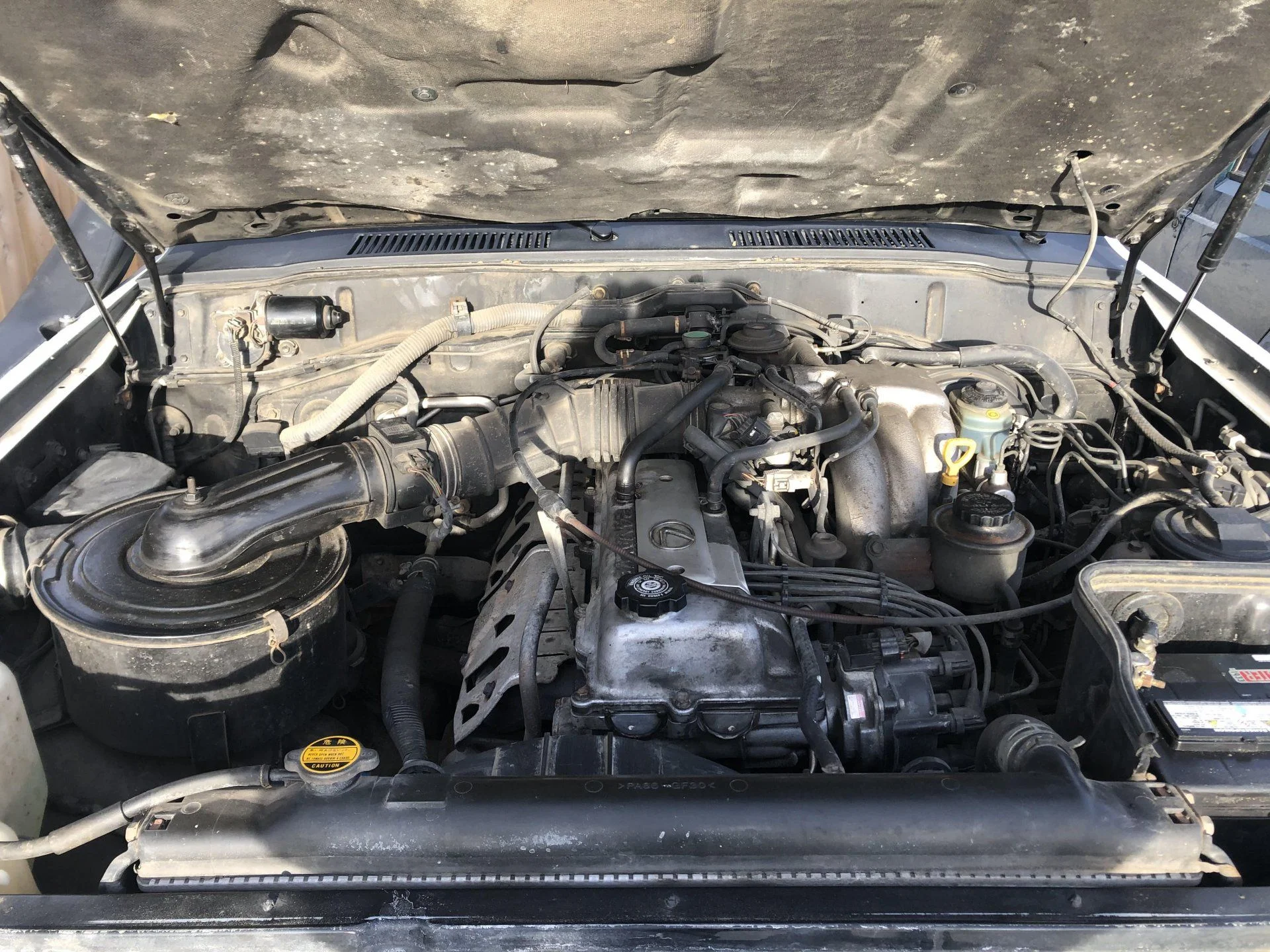

Hi all, been wanting to build a cruiser for a while now, I had an HDJ81 for about a year, it was already built up and introduced me to these vehicles. I recently sold that and picked up a very stock '97 LX450, been a family owned vehicle and currently has over 400,000 km. It has front and rear lockers, a well taken care of drivetrain and interior, and is the perfect candidate for a ground up build. I enjoyed the 1HDt, but I've seen a few members on here have swapped in various years of 12 valve Cummins, and that peaked my interest. My daily driver is a '93 W350 Cummins, I'm currently part way through putting a Cummins drivetrain into a 1986 GMC K30 crew cab, and I've been working with these engines for many years now. It just makes sense to me. I want something I can daily drive, and also load up heavy and take on week or or longer expeditions, so, the plans for the build:
-1991.5-1993 12 Valve cummins, mild power modifications, I don't want any more than 300 horse
-NV4500 or a 47Rh, not too sure if I want an auto or stick right now. Leaning towards stick

So the truck has been very well taken care of. I am the third owner, all of the maintenance and service has been done at the dealership since new. It has 400,000 km, and runs and drives like a top. Only issues is the AC needs a charge, and one of the O2 sensors reads out of range. The ABS light has since turned on, but it wasn't on for the test drive. I'm guessing I got careless with a strap when securing it to the trailer for the trip home. Interior is very clean, couple rips in the seat but nothing unexpected for the age and mileage. Both lockers work, and it's straight as an arrow on the highway. Third row seats are clean, it even has all the factory literature in the glove box, and a Lexus brand first aid kit. May not seem like much to some, but I'm used to buying vehicles in far worse condition than this. I know it's not very exciting right now, but we'll get there!
