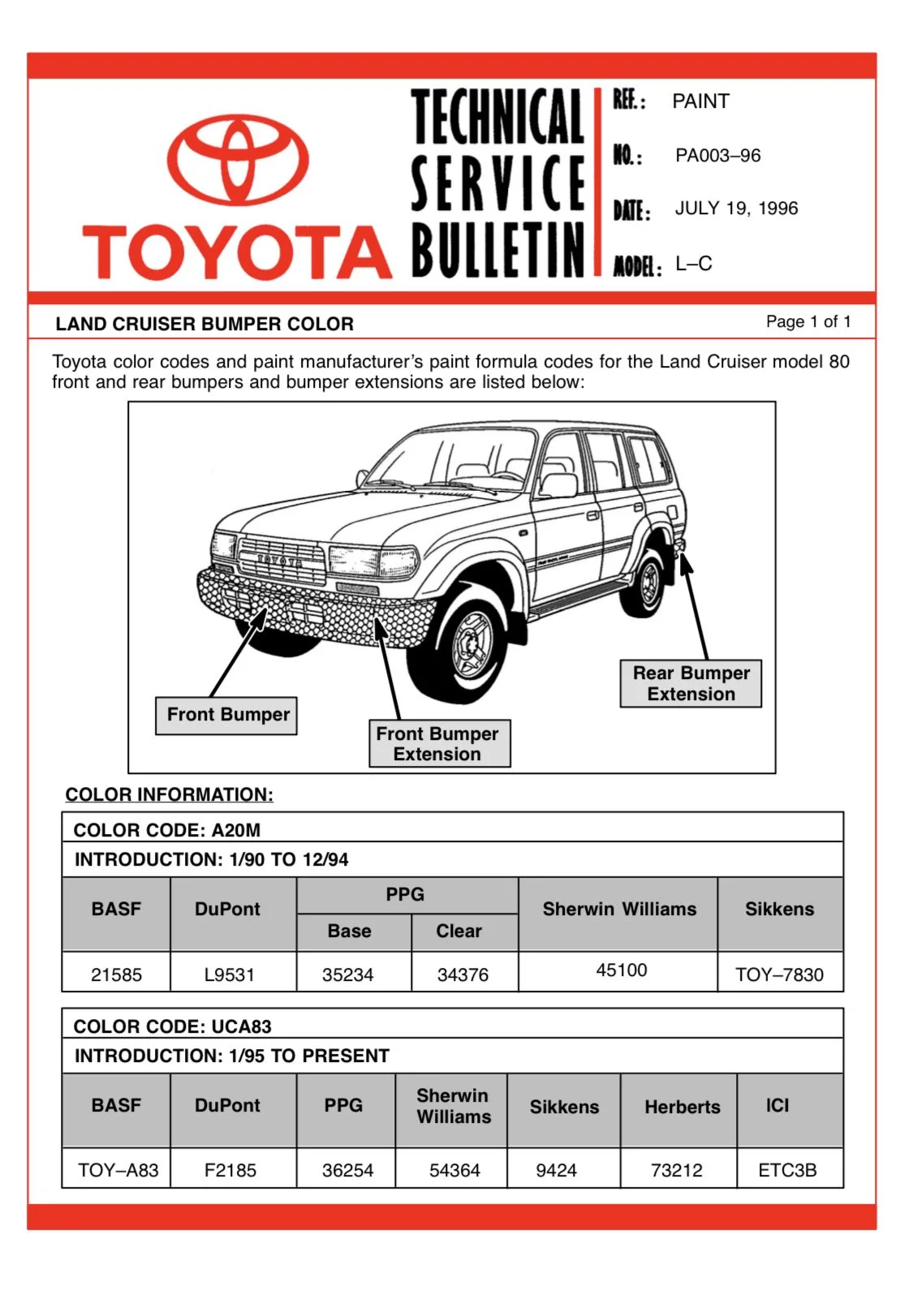

I've got a 1997 40th anniversary LC with the Antique Sage Pearl paint. The bumpers look to be slightly darker than the Antique Sage Pearl paint. I'm having the bumpers repainted but the paint shop says the VIN only pulls up the Antique Sage Pearl paint color. Does anyone know if they are actually the same color or is there a different paint code for the bumpers on this model? Every image I can find of this 40th Anniversary shows darker front and rear bumpers. Thanks guys!
