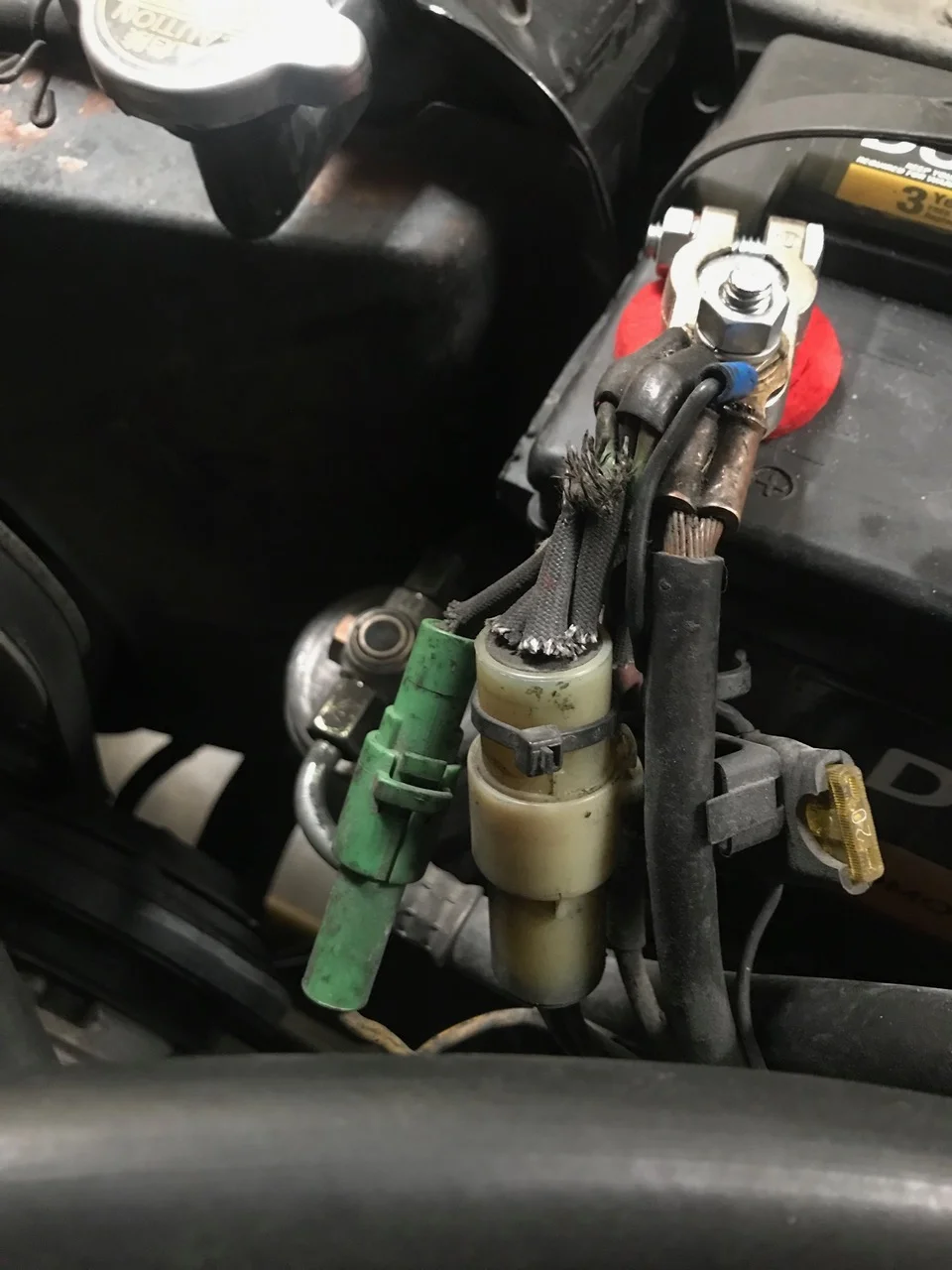

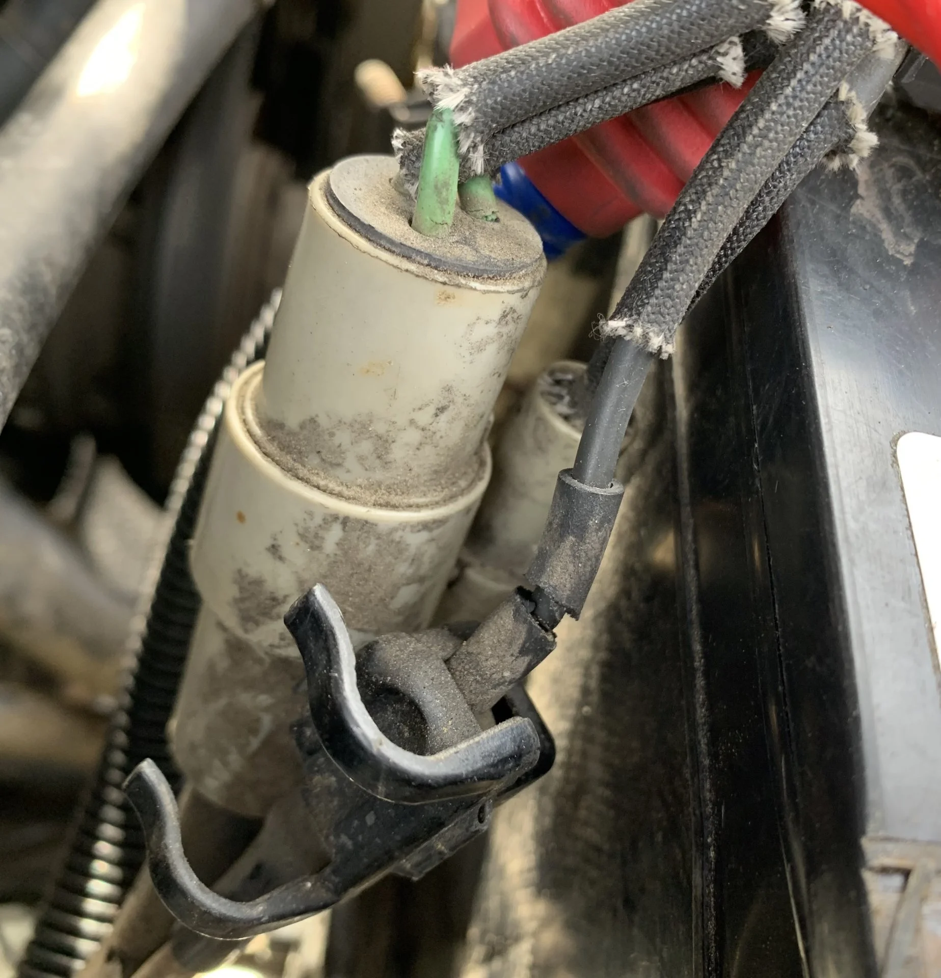

Not sure if you still need it or if these are helpful but I took a few photos and videos. Let me know if there’s something more specific that you’d like to see
Sorry for the link. Mud isn’t allowing me to post video

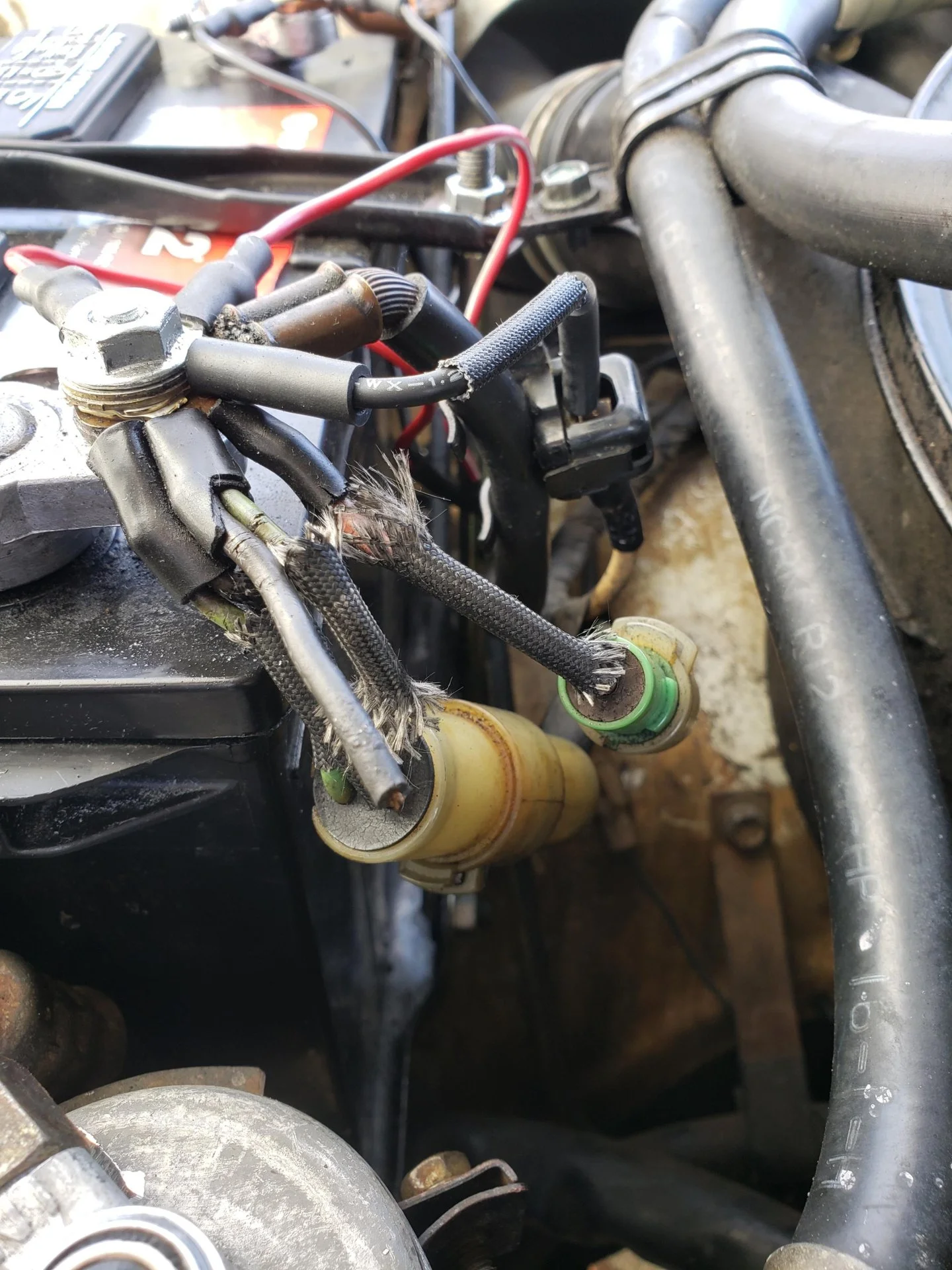

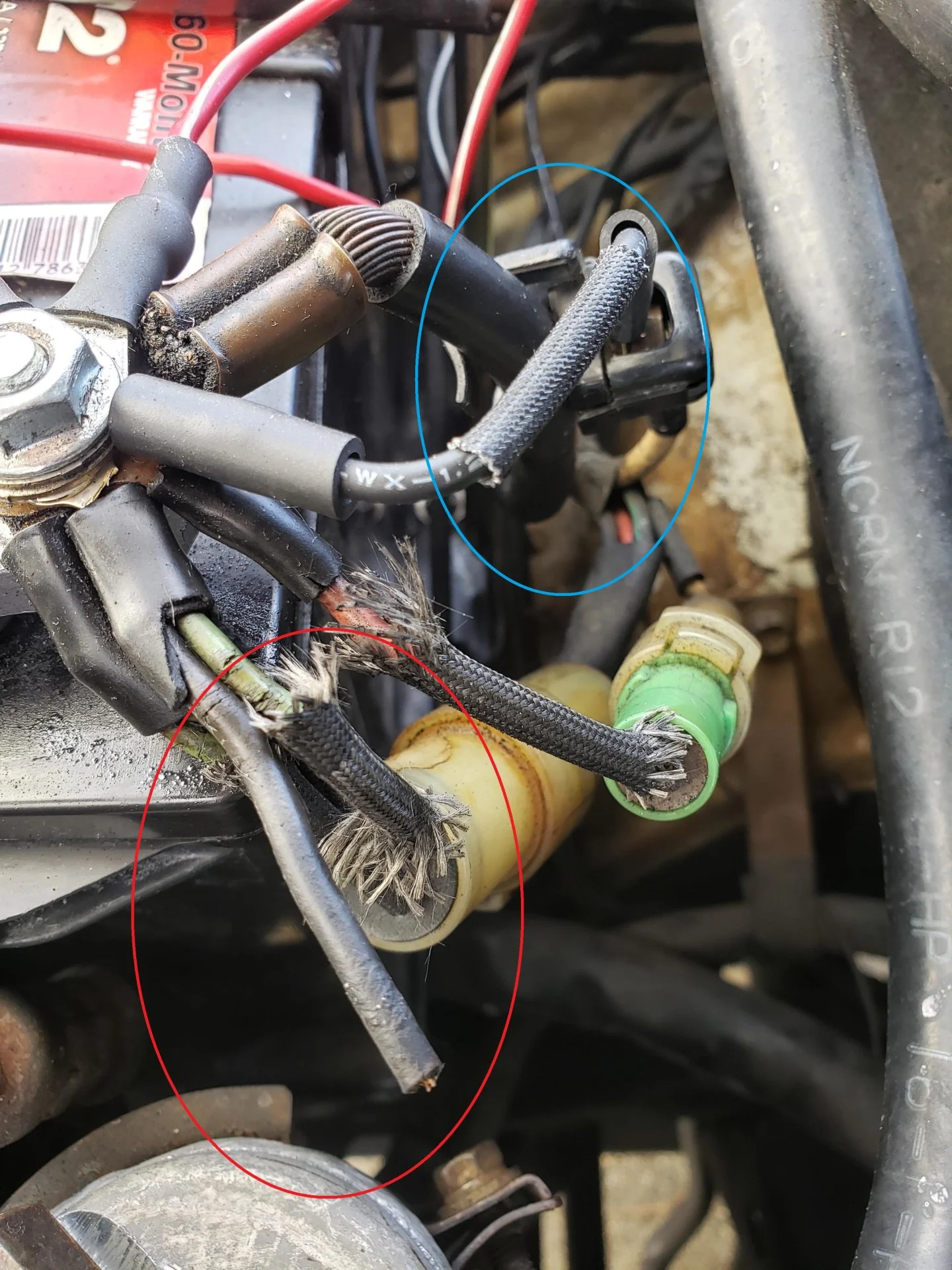

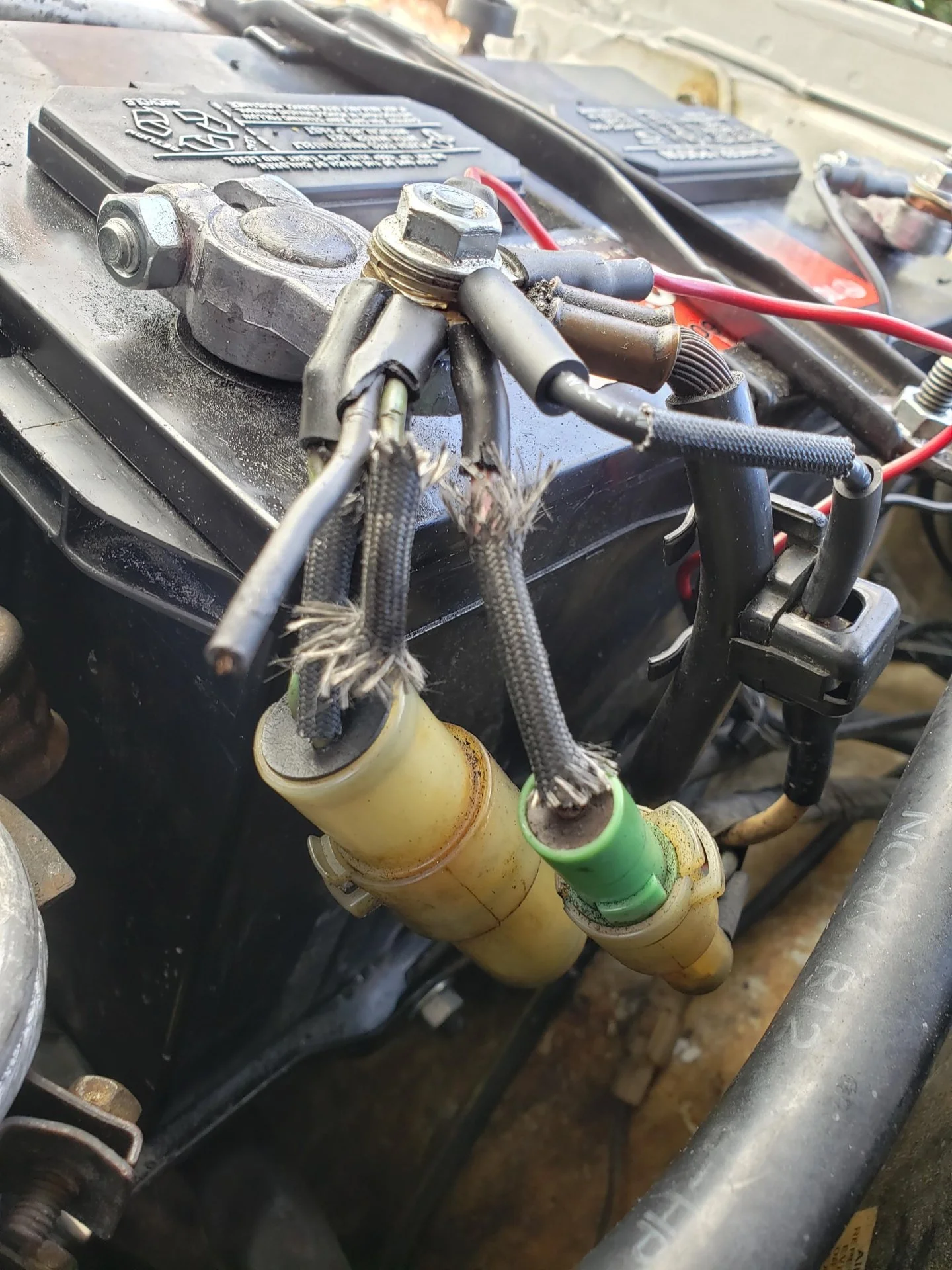

not sure if you need it or not but i took close ups of mine; there's two main plastic connectors and a single wire connector (that goes to the alternator).
you'll notice some anomalies; i circled these in the 3rd pic. in the red oval is the original fusible link that would have gone to the alternator. in the blue oval is a hack i put together recently. so the PO "fixed" the alternator's original fusible link with electrical tape and i didn't realize that until it fell apart after a long drive; i trimmed the bad parts, keeping most of it intact for reference, as you can see in the red there. ultimately i "fixed" my situation by obtaining the fusible links for an FJ80 and snipping off the 1.25 mm^2 fusible link for its alternator; that's what i've got in the blue there. needless to say i'm in the market for anything better than this....

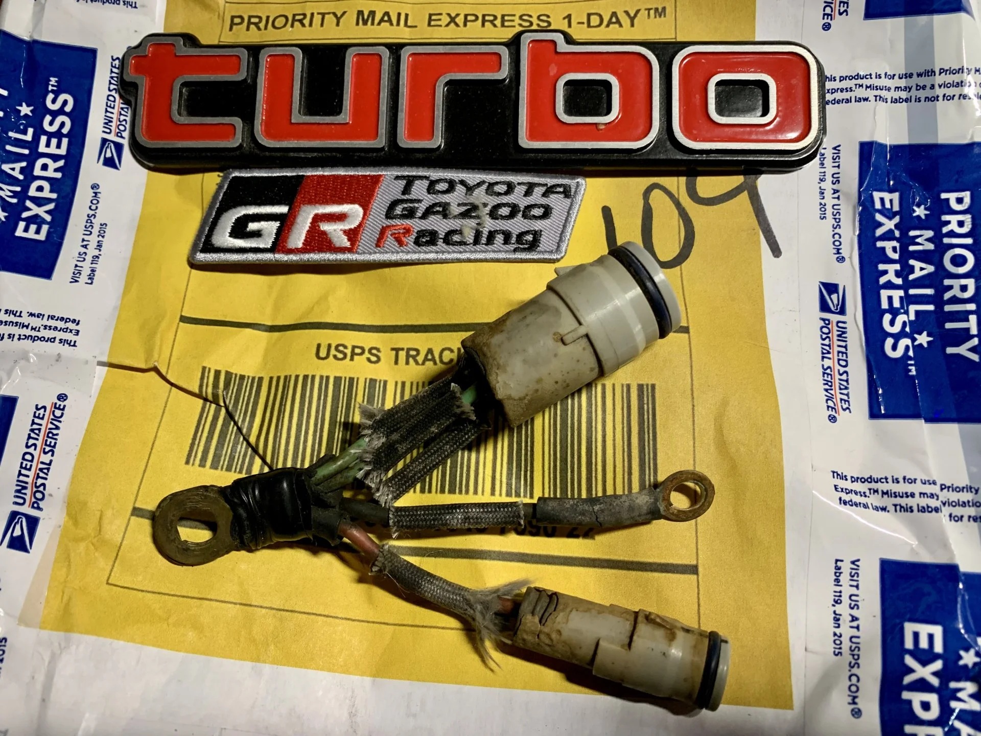

A Special big THANKS on behalf of the Entire 62 series Community to @cruisermatt And CruiserMatt,s OFF Road in Winter Park FLORIDA
For Over Night usps express mail the OEM original unmolested DONOR fusable links below
this is exactly what i need in hand to get i right the first go around , im stoked to say the least :D
also , a big shout out to everyone whom posted the TECH Photos above as well ..
i will procede wilh
To my Lab for full on Period Correct CLONING …

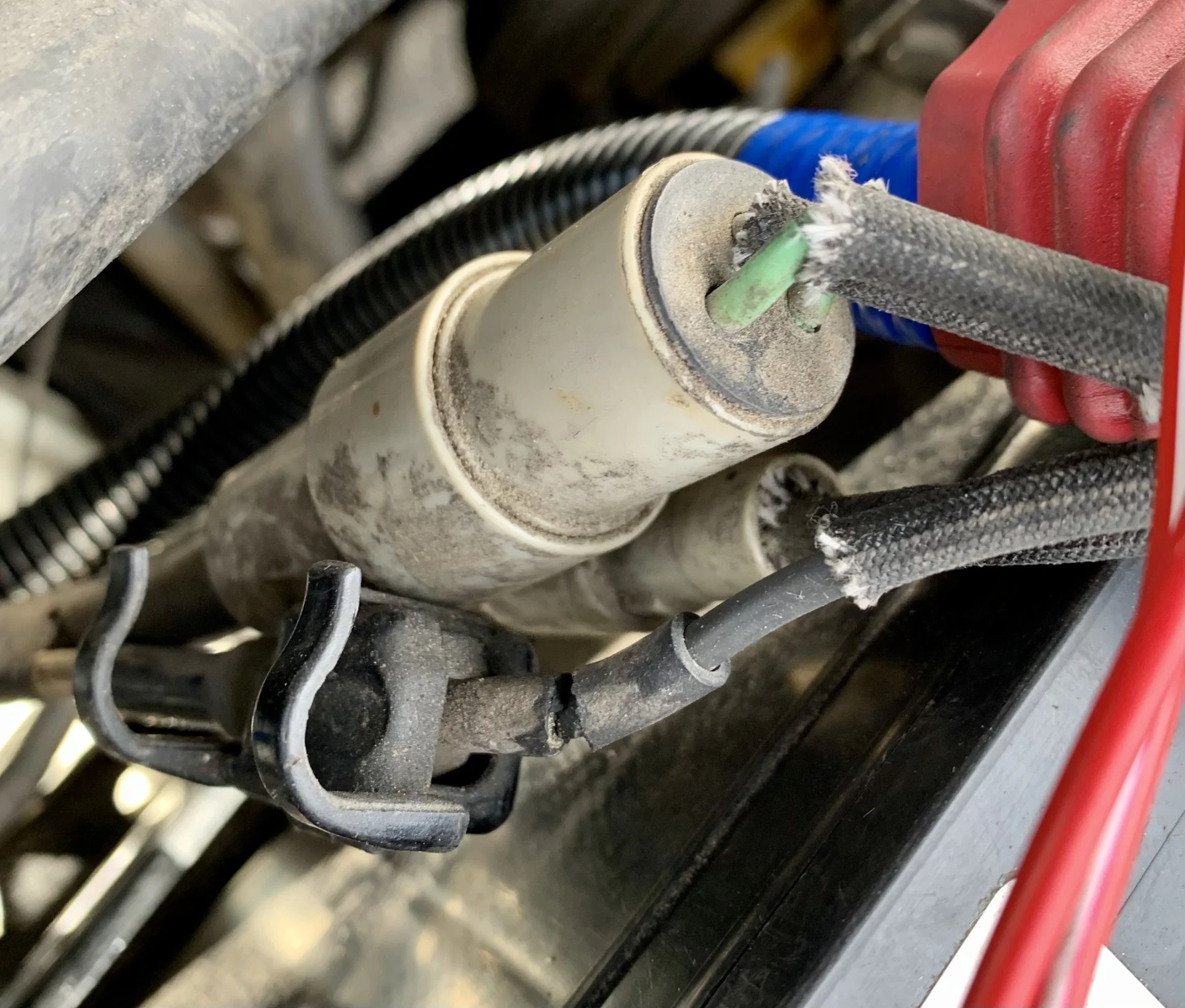

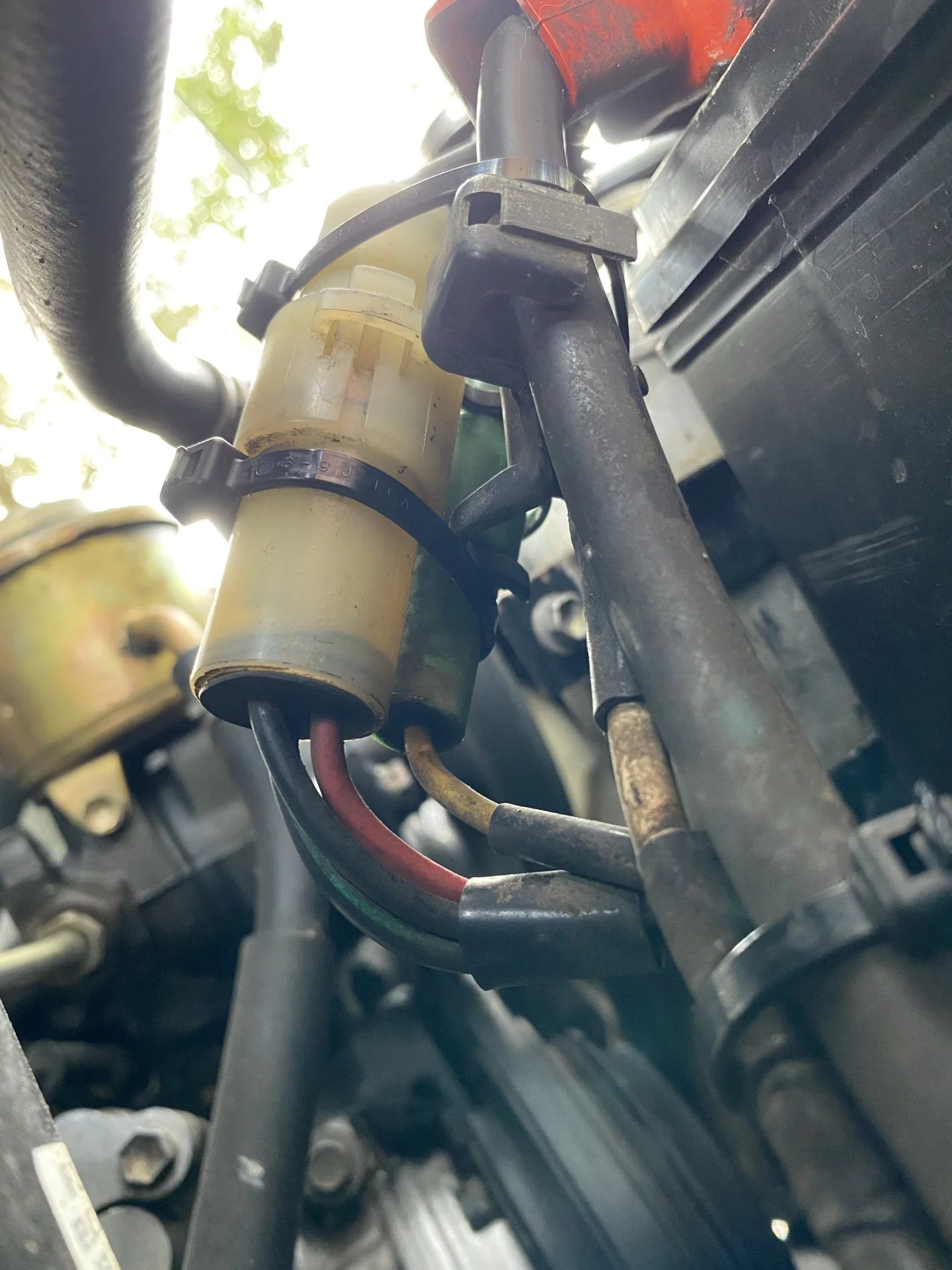

TM... my Feb 1988 build date has the green and white fusible links like Dogcruiser's.
