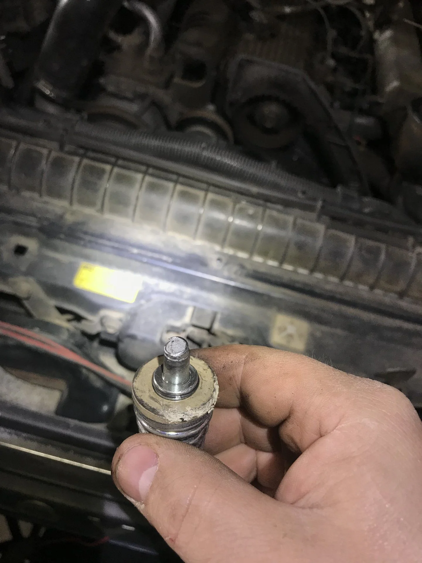

Bad news. Tensioner bolt on timing belt died. Then pistons met valves met bad news and destruction
Opened cover and found a locating dowel from tensioner.

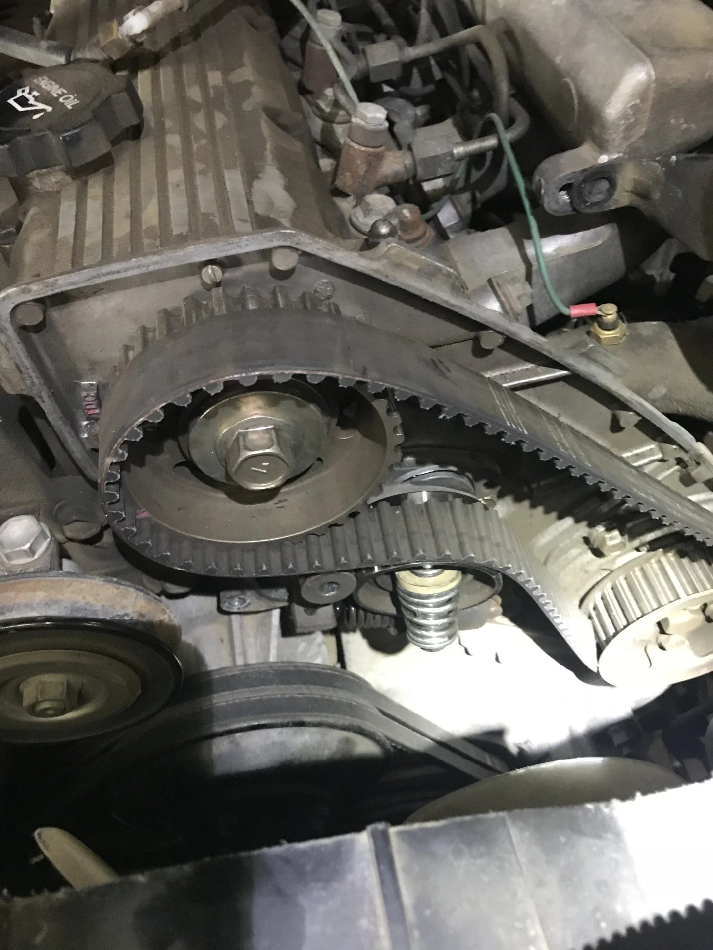

Then I saw the bent fxxxered tensioner

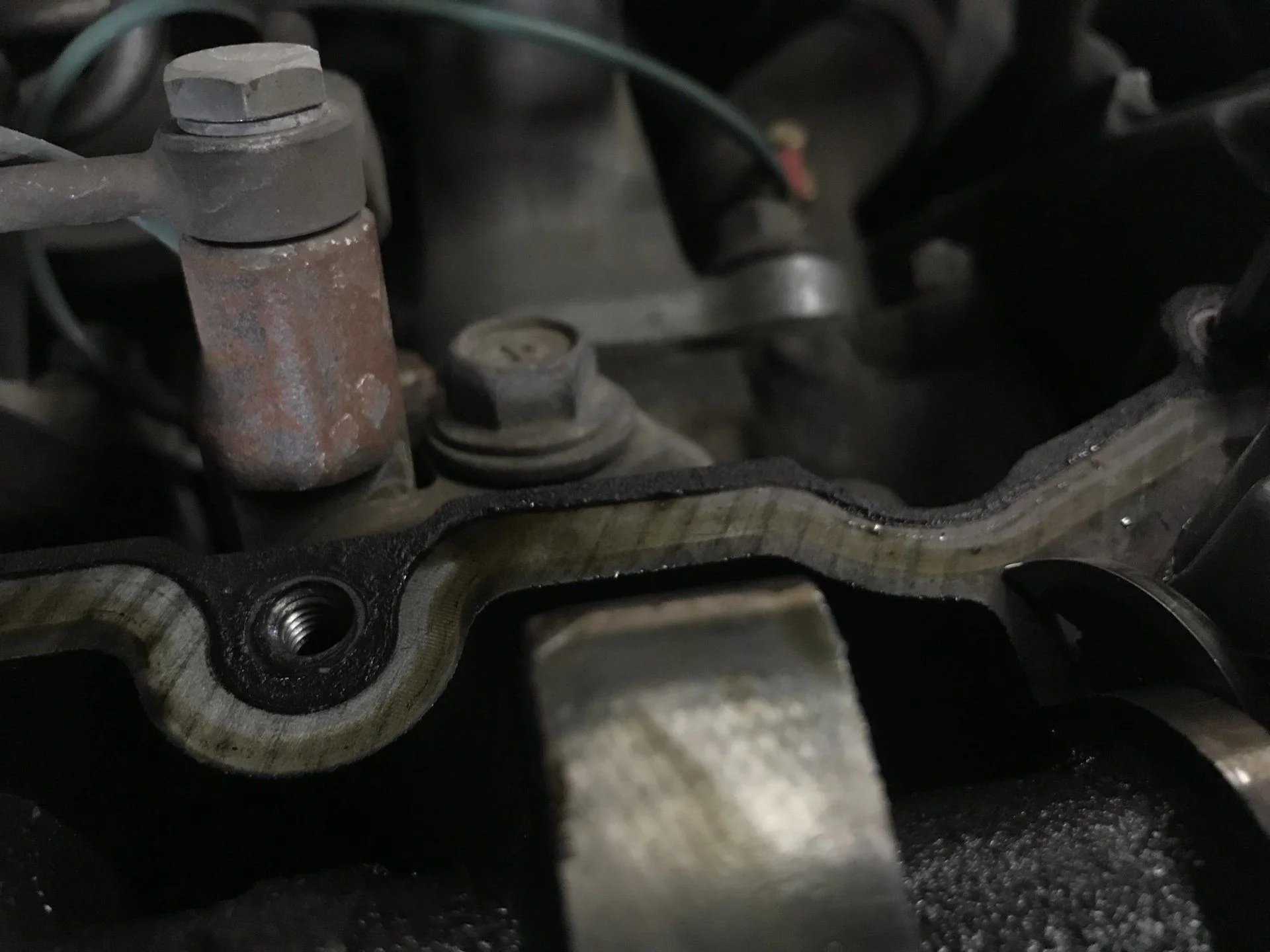

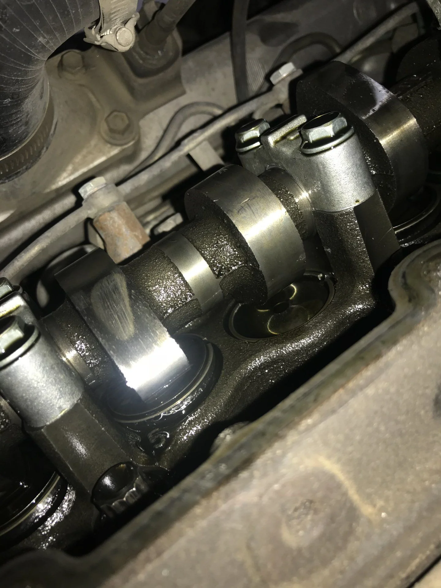

Then I pulled valve cover. Some of the lifters are jammed. Cam lobes damaged
