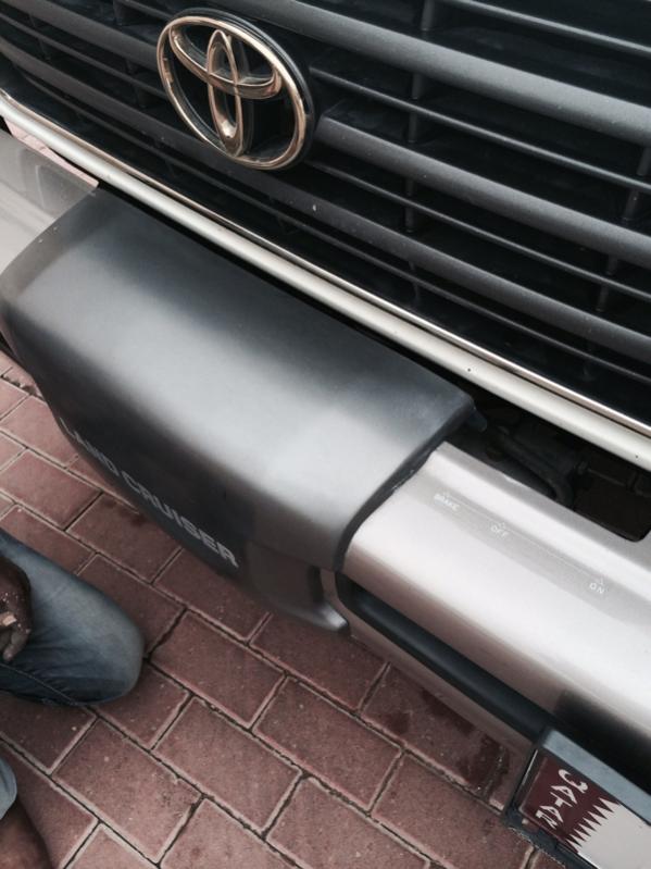

Here's some pics of my '91 HDJ81's electric winch for reference:
Here's another showing the OEM bumper, winch plate, and fairlead assembly:
