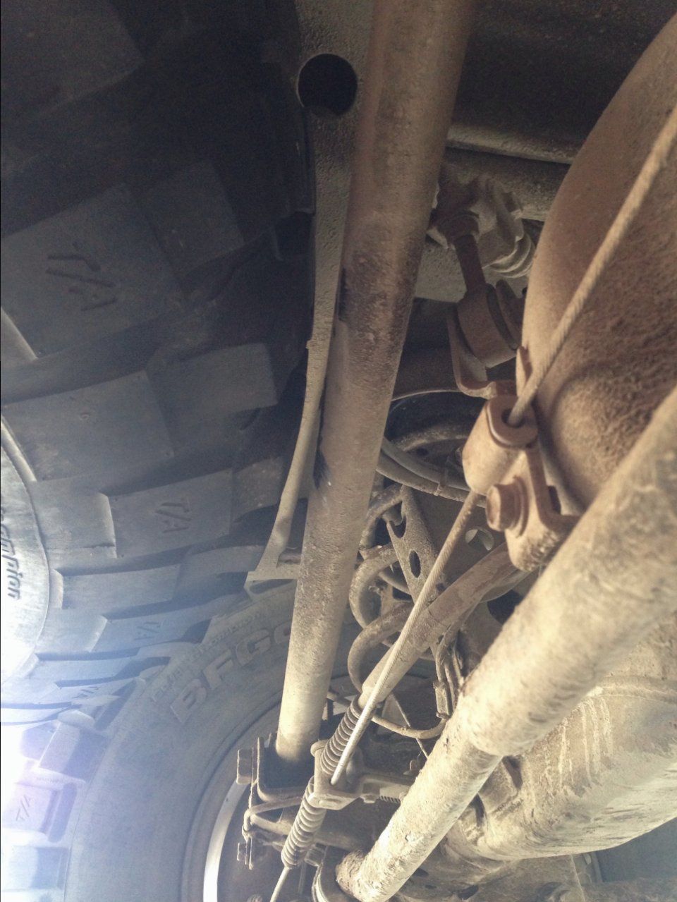

Finally got a chance to take some pics with the kit installed and 315/75/16 KM/2 tire in place. As you can see, it fits and there is just enough clearance for comfort. Works both at stock height, or with my 850/860 springs.

I scored one of the Wits' End versions of this kit used from another mudder, and it works great! Before and after pics below. Gained 3" of additional ground clearance at the front of the spare tire, no gains at the rear, but no room to move the tire up any higher at the rear without modifying the tubular frame crossmember and a body seam. Great design!
For scale, my tires (including the spare) are 265 75 R16 and I have OME stock height replacement springs (no lift).
What is the standard procedure for securing the wiring harness that needs to relocate with this kit? I didn't get any instructions since I bought the kit used. I zip-tied the harness to the gas filler but I'm not sure that's the best way....
