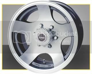

Sorry for the very late reply guys. I didnt seal the deal from the first seller, but I got a second deal which is still in progress (and is more expensive!!). He said the rims are 16X8 with an offset of +10 and here is a pix:

If those are OEM, they are likely zero offset and will require the use of a spacer to use on your BJ74. Have him measure the backspacing. If they measure ~4.5", they have a zero offset.
Since you are from the Philippines, check out :: 4x4 Philippines ::, if you haven't already.
Using 1.5" bolt on spacers.
I've run 16x7" steelies, with 4" BS no problems. Not tried the FJZ wheels without spacers, so I can not confirm.
I was able to tried it on, but its touching the the tierods, will need spacers and replace the lugs...Im dropping the idea.
