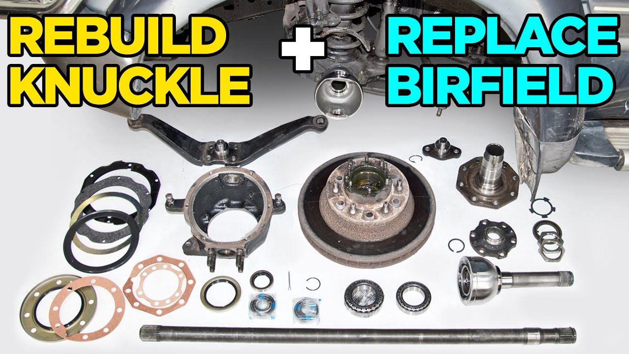

What you're grabbing with your fingers in the video is the shaft end of the CV joint often referred to as a "Birf" which is short for Birfield type CV joint.. You'll also want to check the nuts and studs on the bottom of the steering knuckles to ensure they aren't loose.
More important question; when was the last time the front axle (CV joints, Axle seals, etc) were serviced? Now is the time to do the complete front axle service (remove the spindle and pull the CV joint and axles shafts out), you're halfway there already.
Watch this video to get an idea of how it all goes together:
Here's another with an Australian accent:
One more in case you don't speak Australian:
