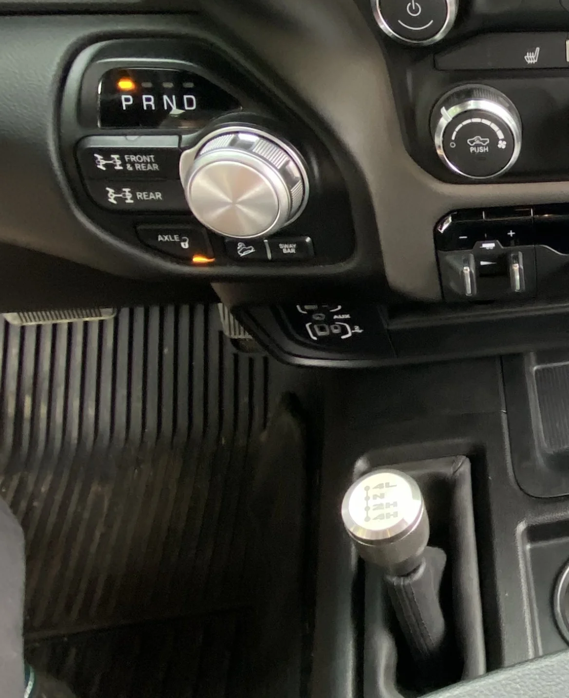

Since you left the lockers at the door, you'll only ever have at most 1.25 wheels per axle under power in this full-time 4x4. lol
Go ahead and triple lock your rig up next time you’re in the snow. You can let me know how well that went from the ditch.
Don’t worry though, my truck can get all locked up when I want to dance that way
It goes great every time I do it. But only up hill.
Wouldn't know about the ditch. You?
If you have that...why are you asking about an unlocked 80 (for street snow of all things)?
…Because I’m a car enthusiast and like projects…. And like many on this forum, I think 80s are a pretty cool platform
Also the truck isn’t the best in the snow. It’s “light” in the rear, so in 2WD it kinda sucks. Since It’s part time 4WD, so I cant just leave it in 4WD when road conditions are variable. Part time 4WD means you DONT have a center diff, which means that when cornering something has to slip to compensate…slip = no grip. Really Big turning radius in 4WD because of this. Love the truck, but it’s admittedly not the best chariot in the snow
