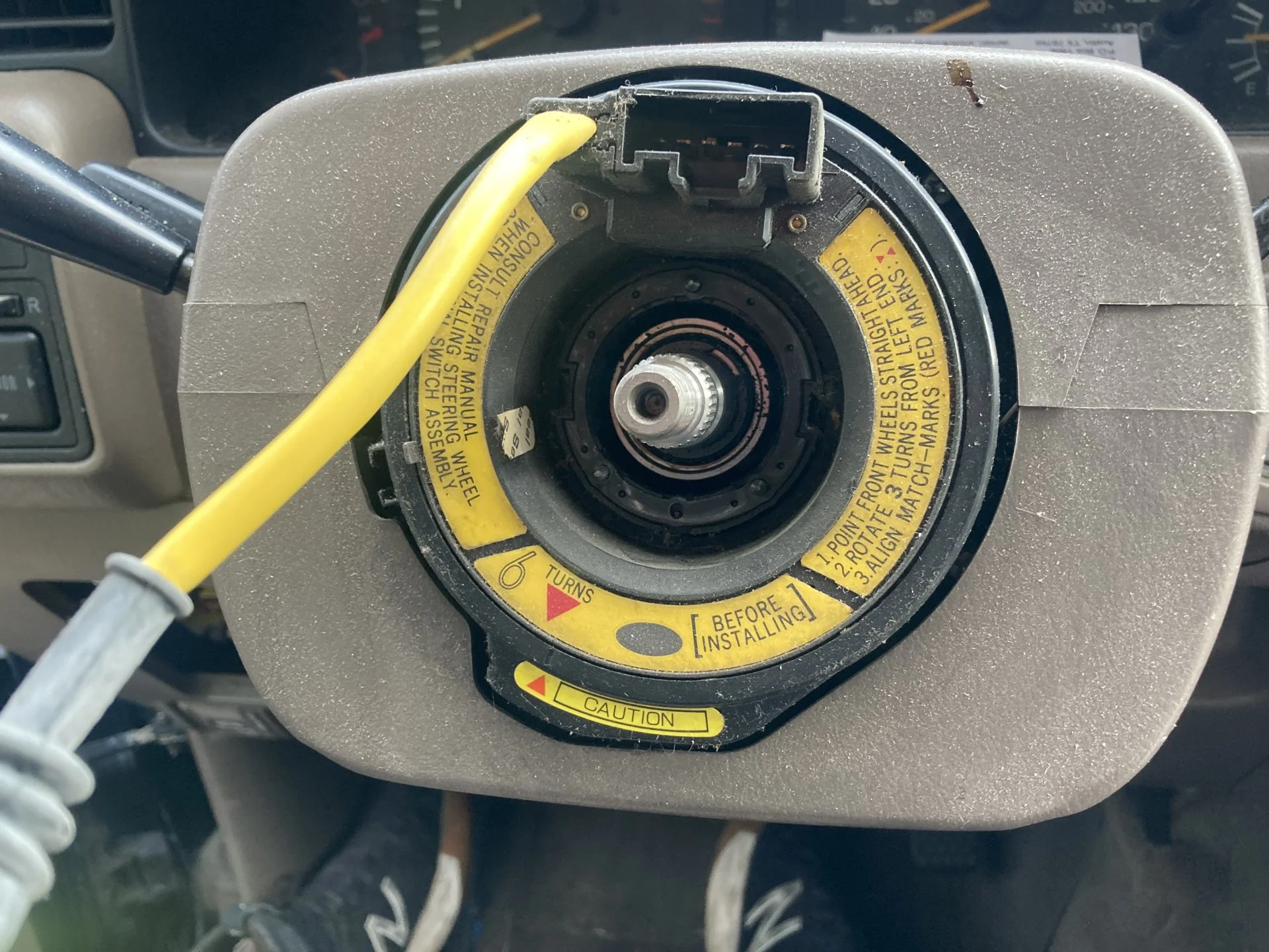

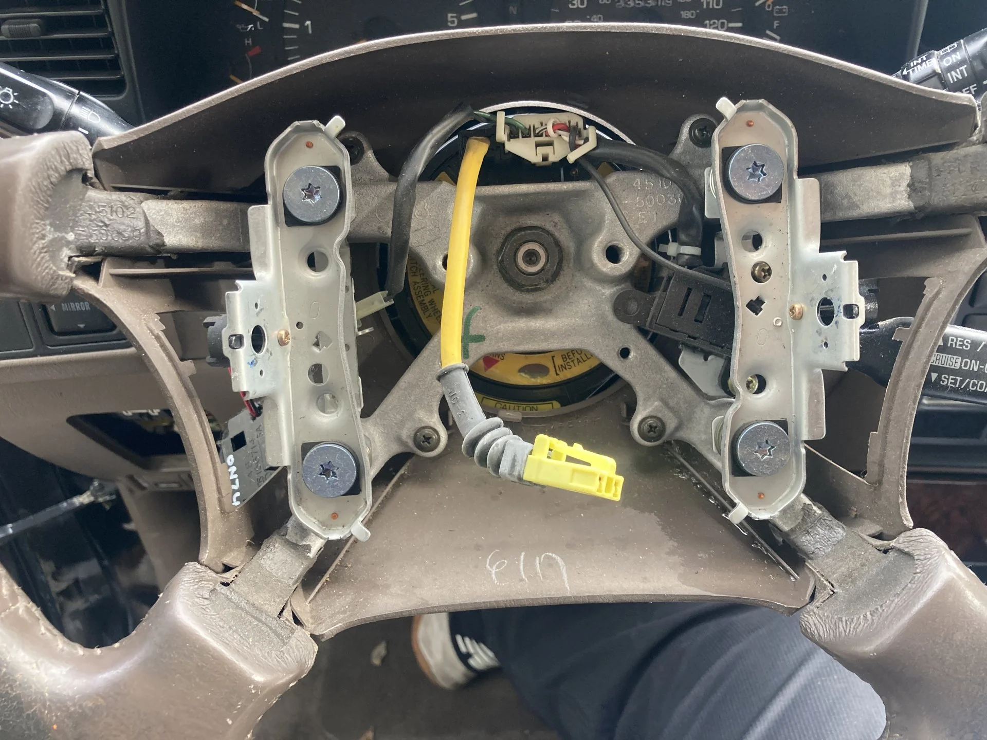

anyone know what you do once you get the steering wheel off and get to this point? both the "non-mud" threads i have printed out are a little light on details.
ALSO, is there some kind of mission critical registration marking you are supposed to do? like do i need to do anything before or after this point?

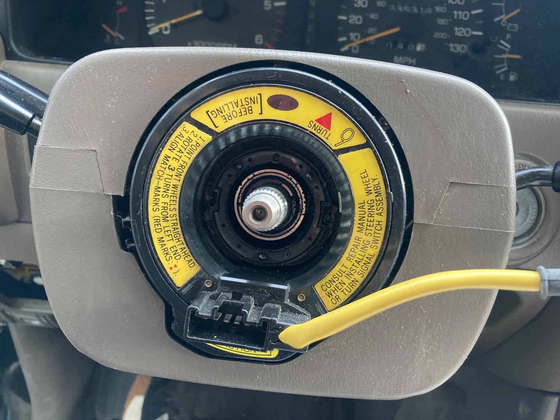

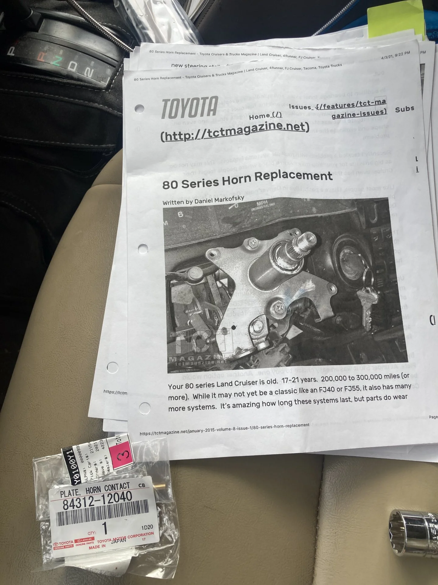

I think you are mixing up earlier and later models. What you have in your picture is a clock spring, but the plunger part you bought is for a '94 and earlier. '95 and above use the clock spring, no plunger.

jeez. thanks man. i thought i researched this.
so my horn is not working and as far as i recall i checked the grounds at the horn and checked the fuse.
any thoughts? i'll print the link and read it in the meantime...

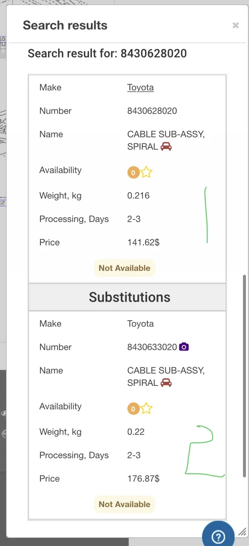

Found this 84306-28020
That substitution is not for LX/Land Cruiser.
The correct substitution part would be 84306-24010.

thanks a LOT for that. i found out about that this morning. not sure what the new part number means. prices are all over the map.

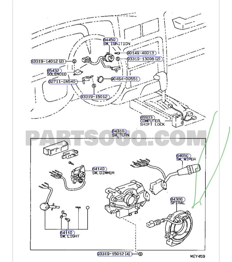

hi zapatius. thank again a lot for this. just so i am clear for others.

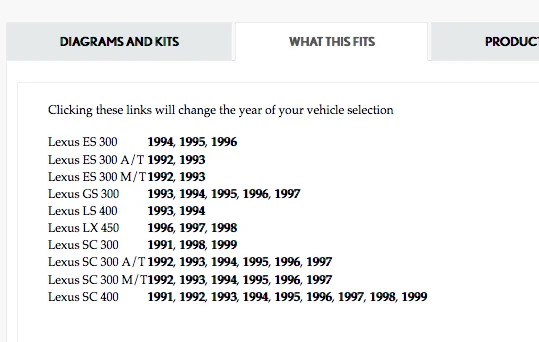

84306-28020 is superseded with 84306-24010?
and 84306-33020 is not an LX450 part?
is it a 95-97 land cruiser part? it's weird because it prices out almost the same or the exact same but it is shown with two stalks...

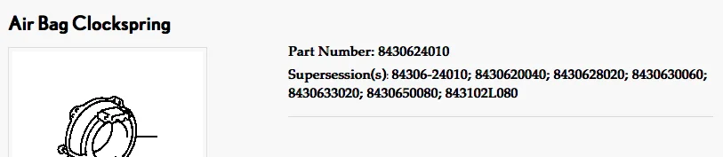

This site answers all your questions:
THANKS man. but i'm not following. that's the lexus site. i super don't want to pay $437 for this part. and i don't have a hookup at a lexus dealer so it is unlikely i will get it cheaper than retail.
84306-24010 is the part number for toyota fiche but it also fits the lexus - yes?(!)
As shown by the link I posted, part number: 8430624010 supersedes the other part numbers you posted. Supersession(s): 84306-24010; 8430620040; 8430628020; 8430630060; 8430633020; 8430650080; 843102L080. And it fits your LX 450. I'm not saying that you need to buy it from Lexus, but pretty sure that is the part you need.

You already answered your own question. The partsouq part numbers your posted both work. Find a dealer that has one of them and buy it.

That one number you posted is for the ES series of Lexus cars. The one I posted and everyone after me is for your LX. You can get it from any Toyota dealer, Ebay, Megazip, Partsouq, flea market, etc....

How do you know this part is bad on yours? Did you test continuity at the horns?
33020 is the part that doesn't fit on yours

on diagnostic i tried for awhile to figure out what i needed to do. basically all i did was clean the contacts and ground at the horn. also to inspect and replace the horn fuse.
i wanted to test continuity at the horn and also i thought to test the actual wire now that my wheel was off.
i have a used fluke i bought for $50. i just wasn't totally sure where the probes went to test continuity or which settings i should have it on...
I would use a multimeter to test for broken continuity through the old clock spring before dropping a couple hundred bucks on a new one.
