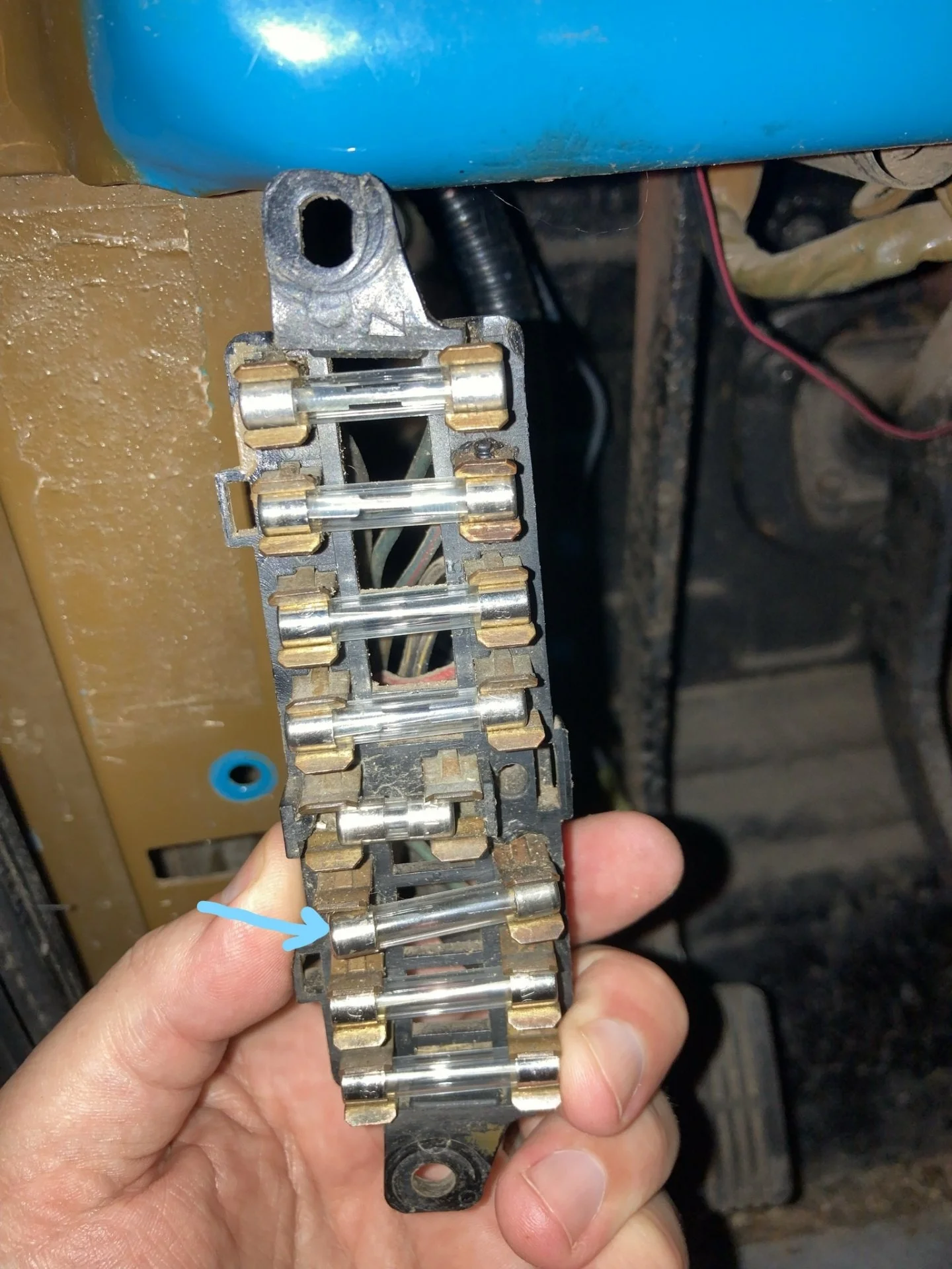

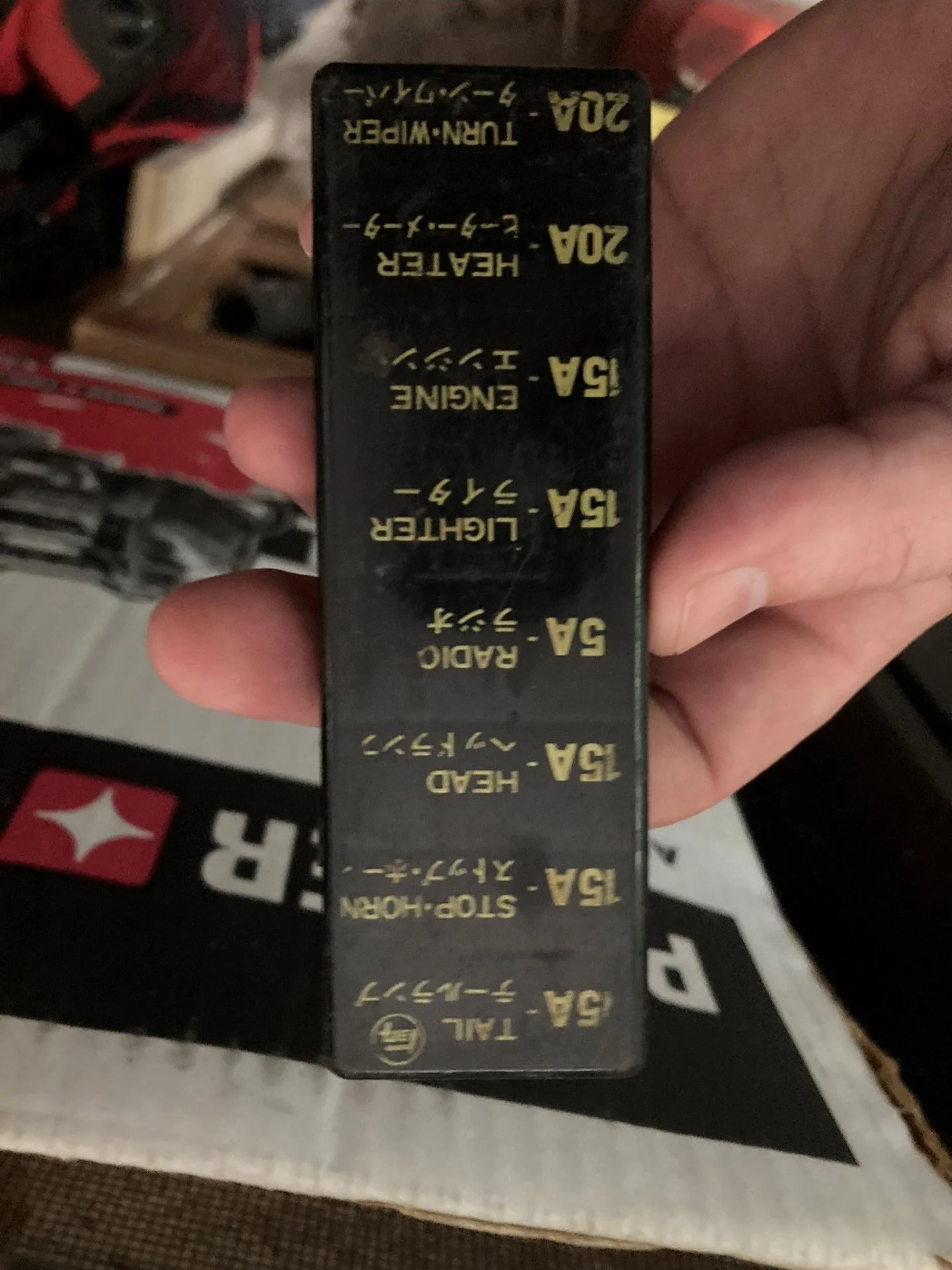

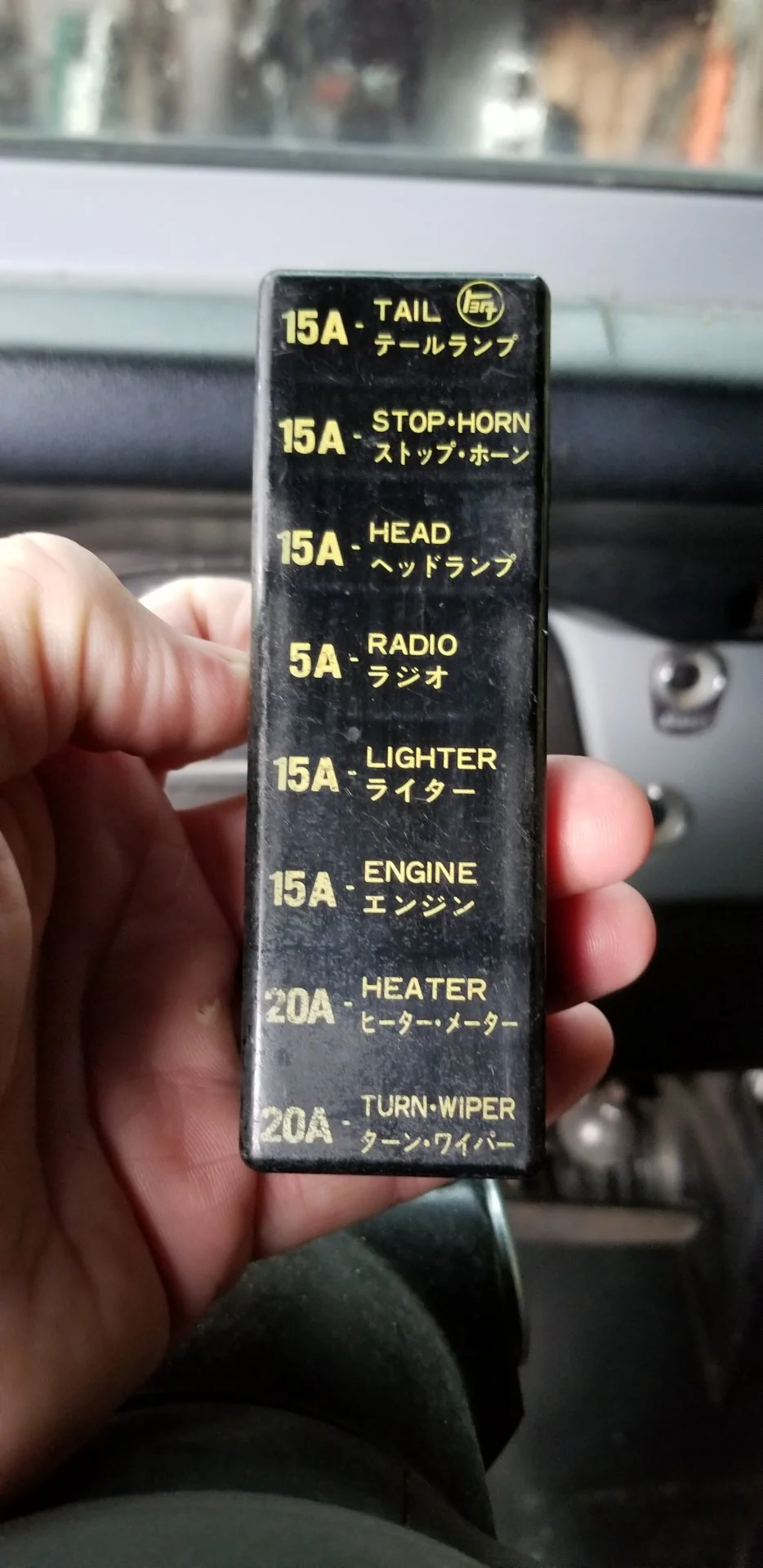

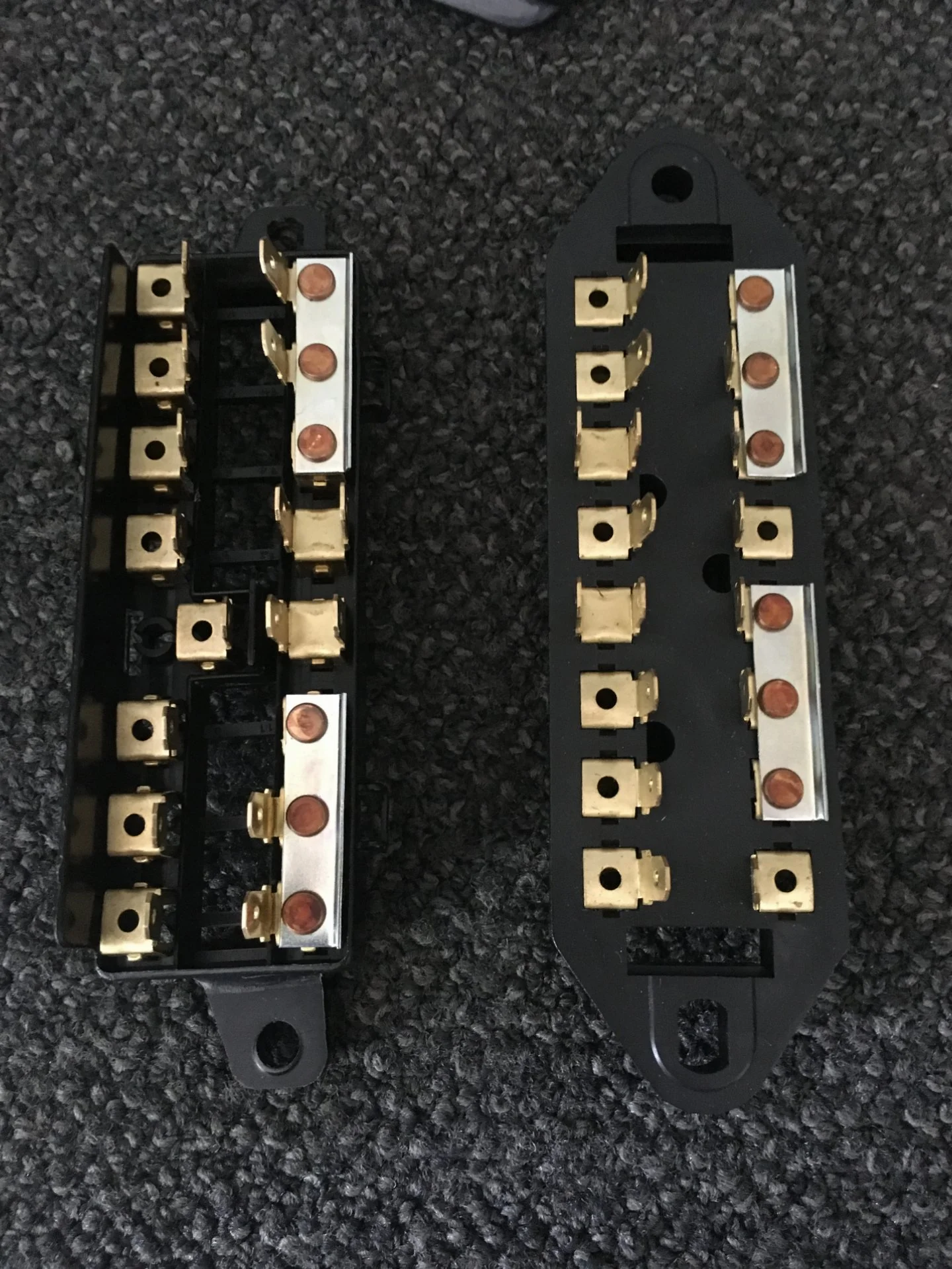

I had one of the clips on my fuse panel break and am wondering the best approach to fixing / replacing. I've looked all over for a replacement for this panel... shorty 5A Radio fuse in the middle... and only find earlier years with the radio at one end. I believe the layout of mine is:
Tail / Stop Horn / Head - Always On
Radio / Lighter - Key Accessory
Engine (the busted clip) / Heater / Turn Wiper - Key On

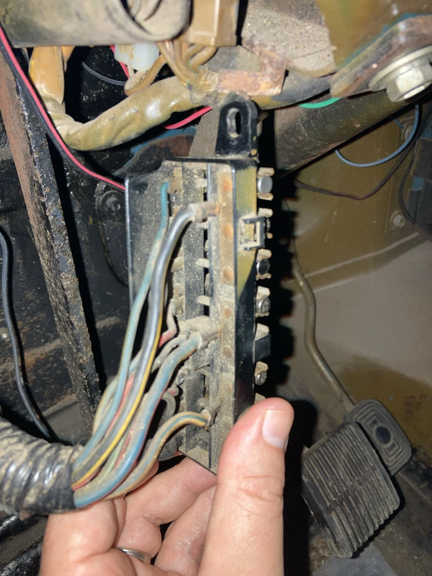

On the power feed side it's 3 / 2 / 3 if that makes sense.
On earlier years, it looks like the layout is 3 / 1 / 3 / 1 so I believe I would need to split the Key Accessory feed across the two singles.
(Example of earlier years: Fuse Box and Cover for '78 Land Cruiser FJ40 - https://www.cityracerllc.com/products/new-fuse-box-and-cover-for-78-land-cruiser-fj40)
Could I source a replacement piece for Key On power feed side? Would be 3 clips attached together and I think they pop in and out of the plastic.
Or is there a stock replacement available for the whole panel? I see lots like the one I linked but no direct replacements for the 79+. I'd prefer this because of the age and I'd like to not worry about it any more.
Any help / suggestions appreciated!
TIA,
Chris
PS the brown paint overspray was the previous owner
