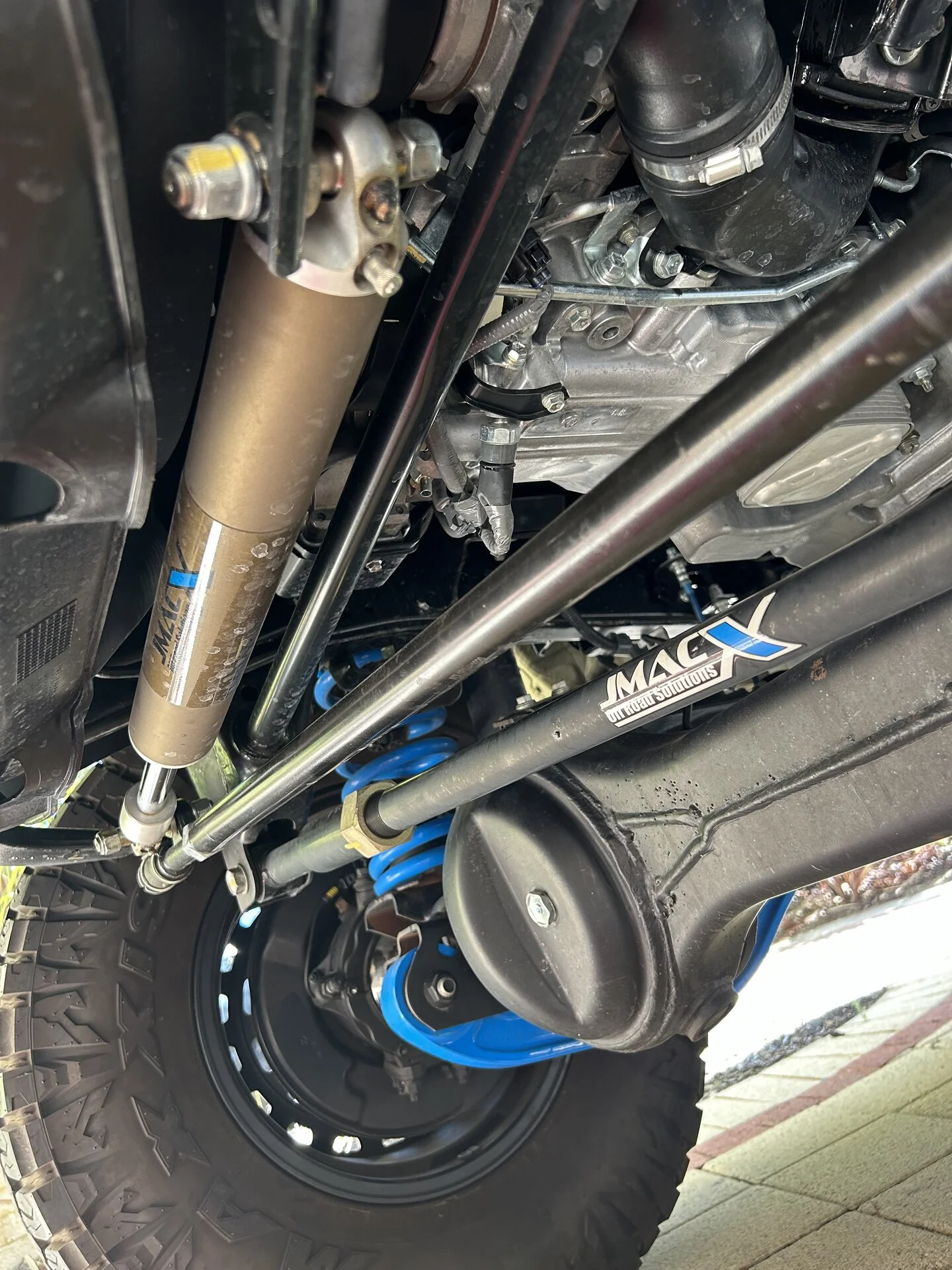

Workshop that fitted the gear said it must be either spring loaded control arm that bolts onto the dampener or the brakes as apparently the stock brakes are no good on the 70 series.

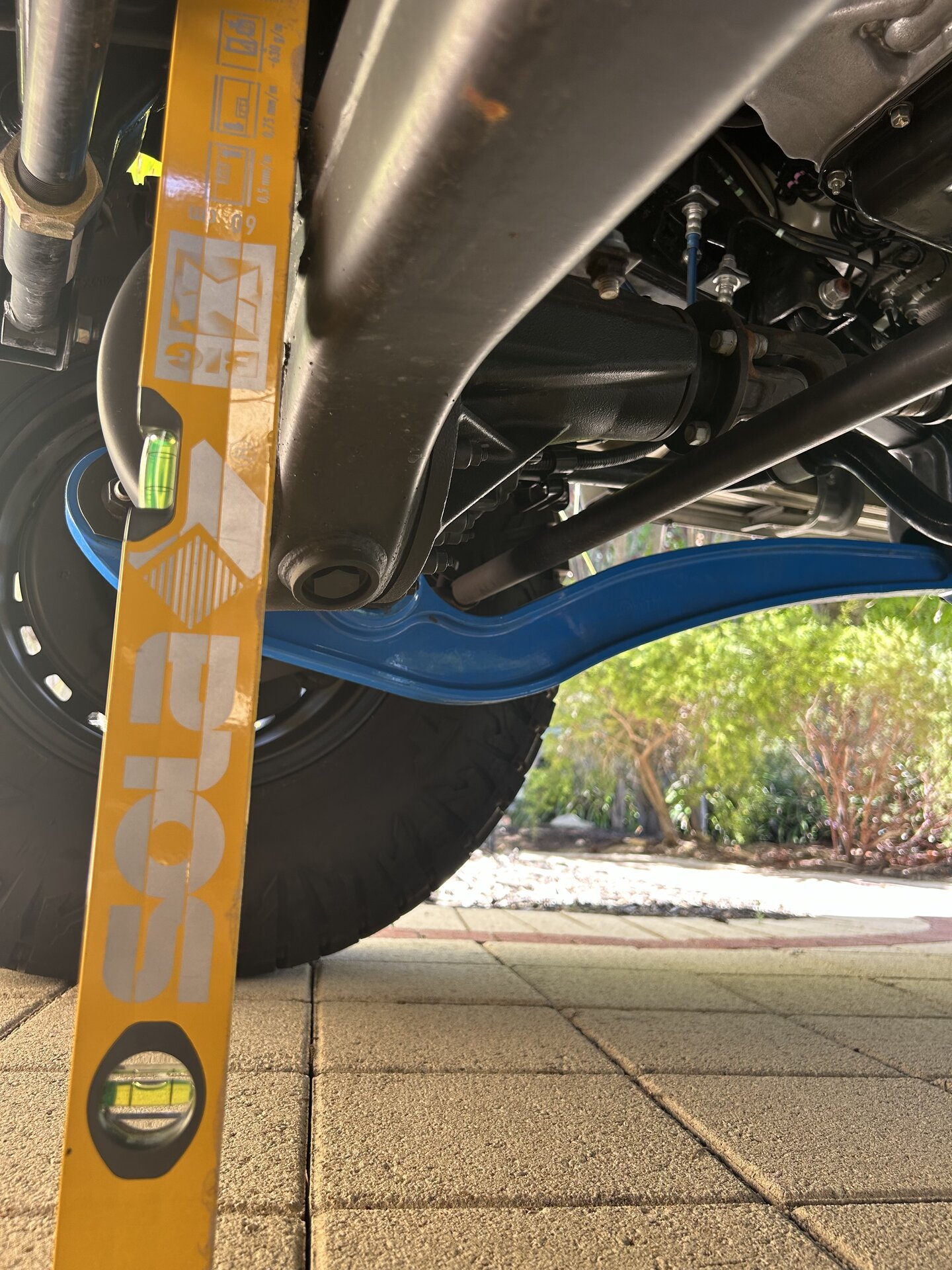

My front diff looks to be slightly leant over forward, not sure if this is meant to be plumb?

Doesn’t look like the new arms are built with a castor (or whatever it’s called) built in🤷‍♂️

Or that the bushes in the radius arms are not offset far enough to level the front diff causing the tyres to wear unevenly,

I came to this conclusion due to the one picture/concern you posted about how it looks like the axle is angled forward instead of upright. Usually the last thing left after doing/checking everything are the kingpin bearings but I don't think that would be doing what you are describing.

Make sure that the adjustable panhard bar is locked down tight.

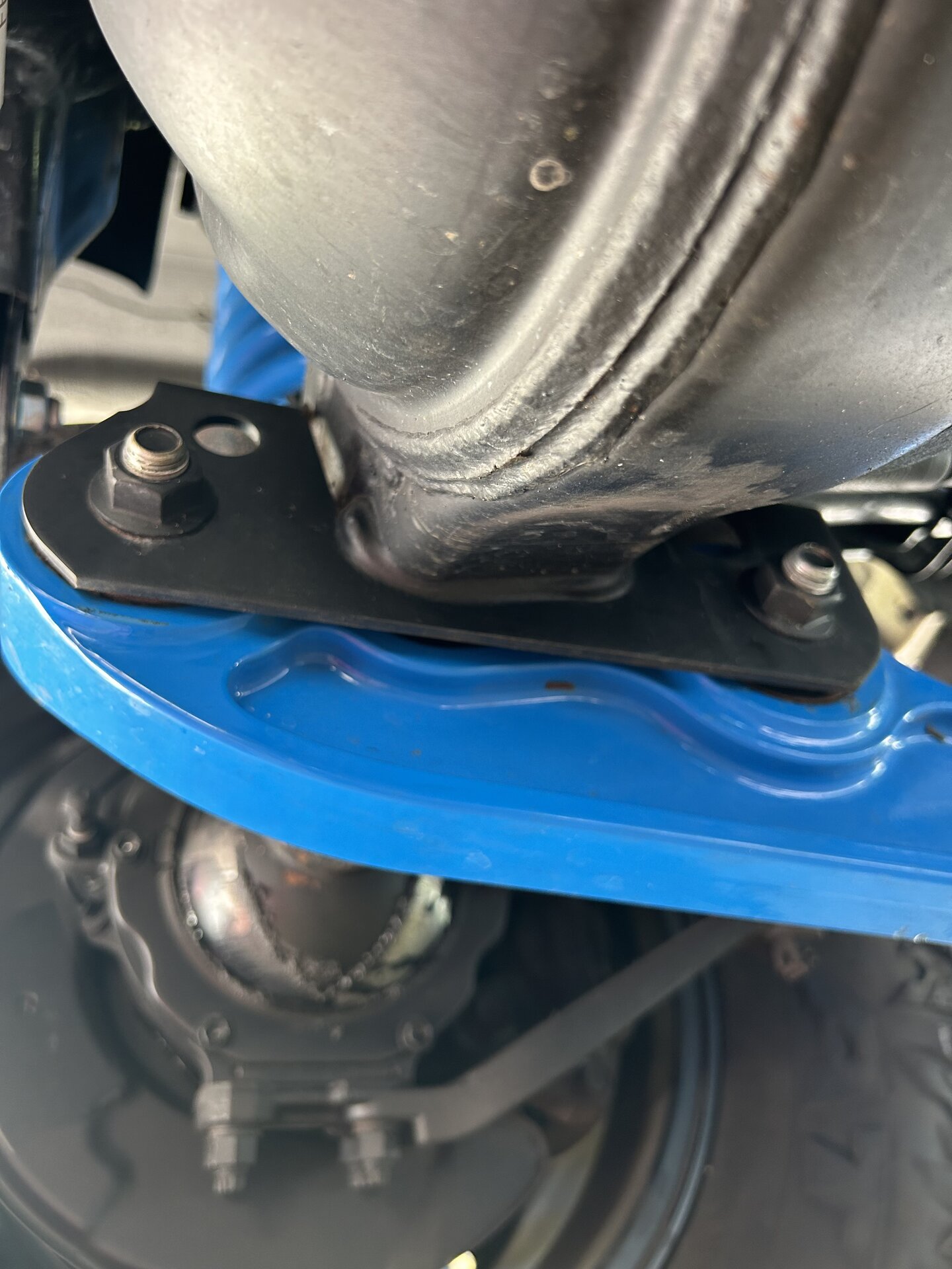

Make sure that all the bushings are in good shape (the sure look to be in your pictures).
Carefully check for any cracking in the panhard bar mount (frame end).

Not sure what sort of"spring loaded control arm that bolts onto the dampener" you have going on, but if that is suspect... remover the damper and see what happens.

Also, the radius arms you have in your picture... are they castor correcting? (IE: keep the front axle at the right tilt or castor) At a 4" lift, they need to be.
