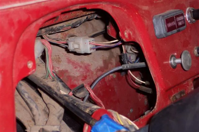

Got started taking stuff off of the dash last night, but didn't get too far. I'm guessing the PO was probably an electrician, thank goodness. He had added a dome lamp with door jamb switches, front driving lights, aftermarket radio, and dual batteries all without damaging the factory wiring harness. All of his inline connections were soldered then sealed in heat shrink and most of it was then run through flexible conduit. This will make a nice new radio for my fishing boat.

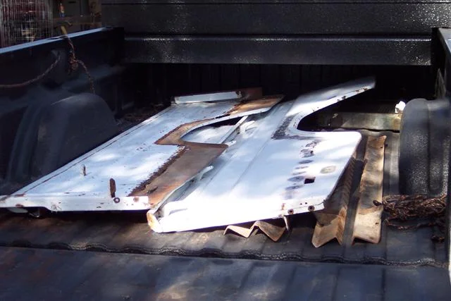

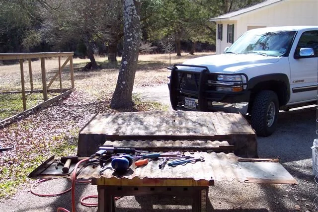

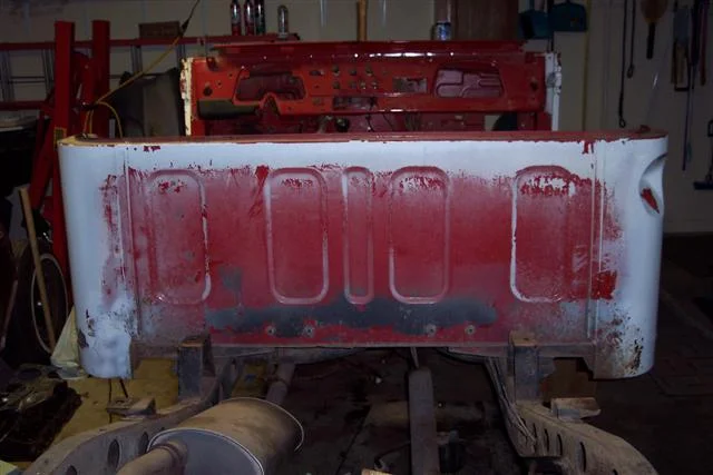

I got the bed completely taken apart this weekend and I dropped off some of the parts to be sand blasted this morning. To blast the bed sides, front header panel and all of the lower support braces will be less than $150, which I thought sounded fair. Can't wait to get them back to see how many holes appear.

Are you drilling out the factory tack welds or using the air hammer/chisel?
Oct 25, 2005
625
Kerrville, Texas

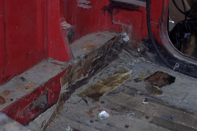

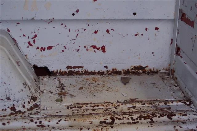

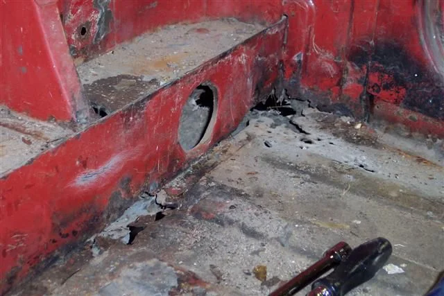

I drilled out some of the spot welds and used the air chisel on others. Some areas of the bed were so pitted that you couldn't even tell where the spot welds were. The chisel also came in handy to cut off all of the bolts because there was no way to get a Phillips screwdriver into them all of the rust and previous multiple paint jobs. These pics show what some of the worst portions of the bed floor looked like.

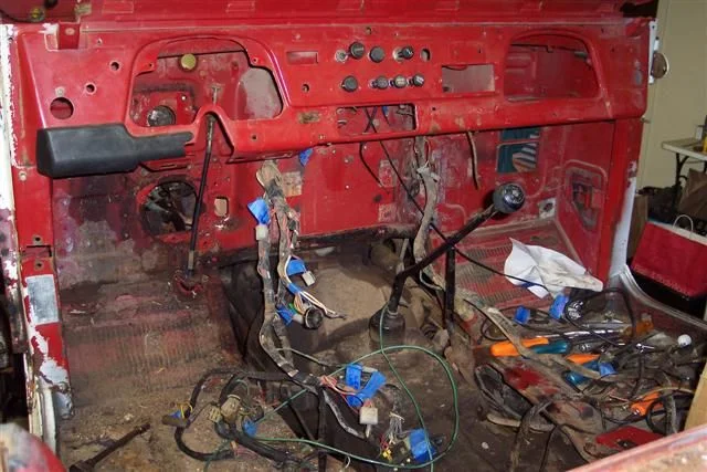

625
Kerrville, Texas

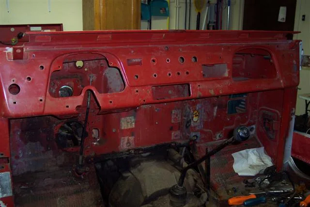

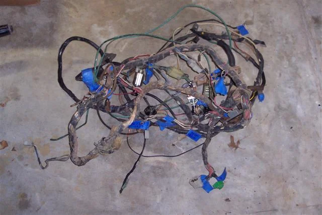

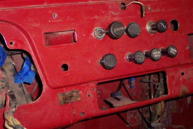

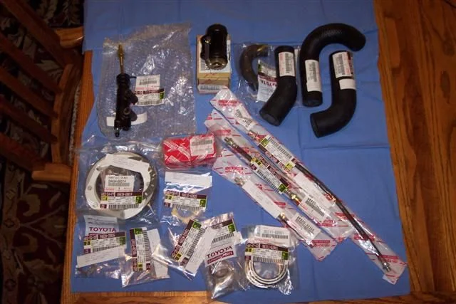

Just a couple of pics of last nights progress. I removed the steering column and pedal assemblies. Most of the wiring harness has been removed at this point.
It's starting to look a little bare now.
Also, I received my parts to repair the front axle leaks, a new rear wheel cylinder, brake hoses, radiator hoses and a clutch slave cylinder. Thanks to CDan.

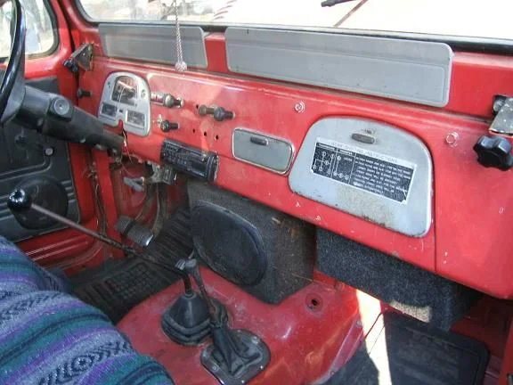

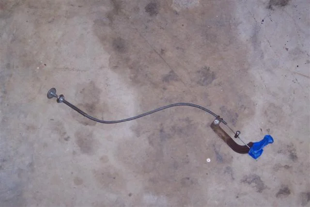

Is this factory?
Is this a factory throttle control cable that I pulled out? It was installed in the "D" shaped hole in the dash just under the rectangular hole for the brake and seatbelt warning lights. The bracket looks like it is a Toyota part but the cable looks like it might be aftermarket. Anyone have a picture of what it's supposed to look like?
Sorry - I can't help you on that one, unless the toggle switch on my rig is factory. LOL
I'd be curious to know as well what is supposed to go in there.
May 10, 2005
2,406
Calgary, Alberta
The throttle control knob on my truck is located inbetween the e-brake handle and the steering colum. It is on a bracket screwed to the bottom lip on the dash. I am pretty sure it is stock. Mine is Canadian though so it might have been different from the factory.

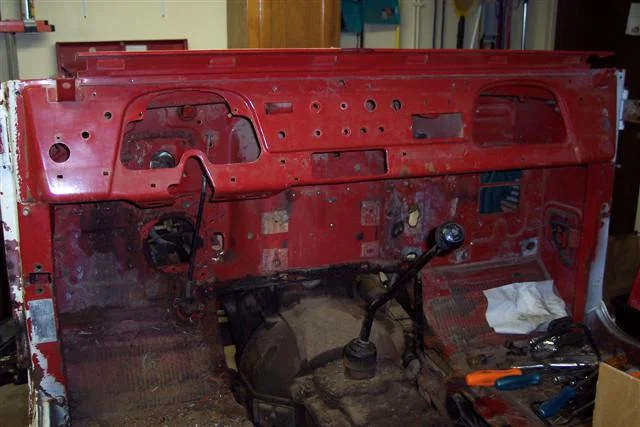

A little more progress made last night. I got the wiring harness out and everything removed from the dash.
I got a new Honey-Do/small remodelling project assignment last night so I probably won't get to work on the Cruiser for the next couple of days.

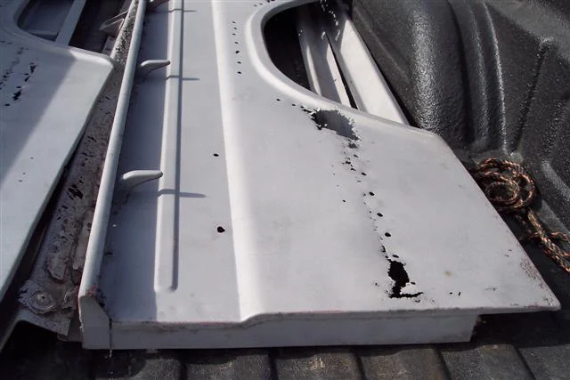

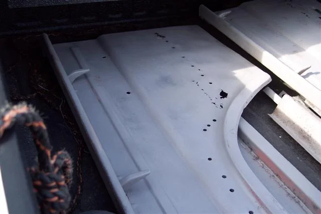

625
Kerrville, Texas

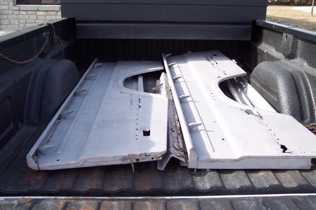

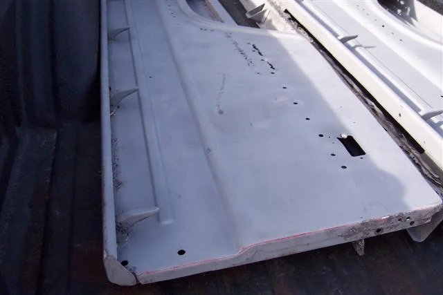

Well, I got the bed parts back from being sand blasted today. They look pretty good, sorta like Swiss cheese. At least most of the bad areas are basically flat. The bed supports look pretty good except for the top of the very front brace.
