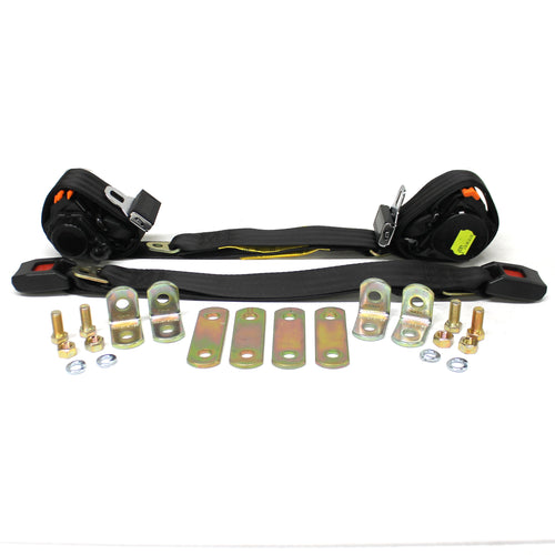

I have the Cool Cruisers of TX model and the install was super easy and I really like them. I'm 5'-10" and they don't strangle me at the throat like i was worried about. Mechanisms lock up like you would expect so I am very pleased and now street legal again. :cool:

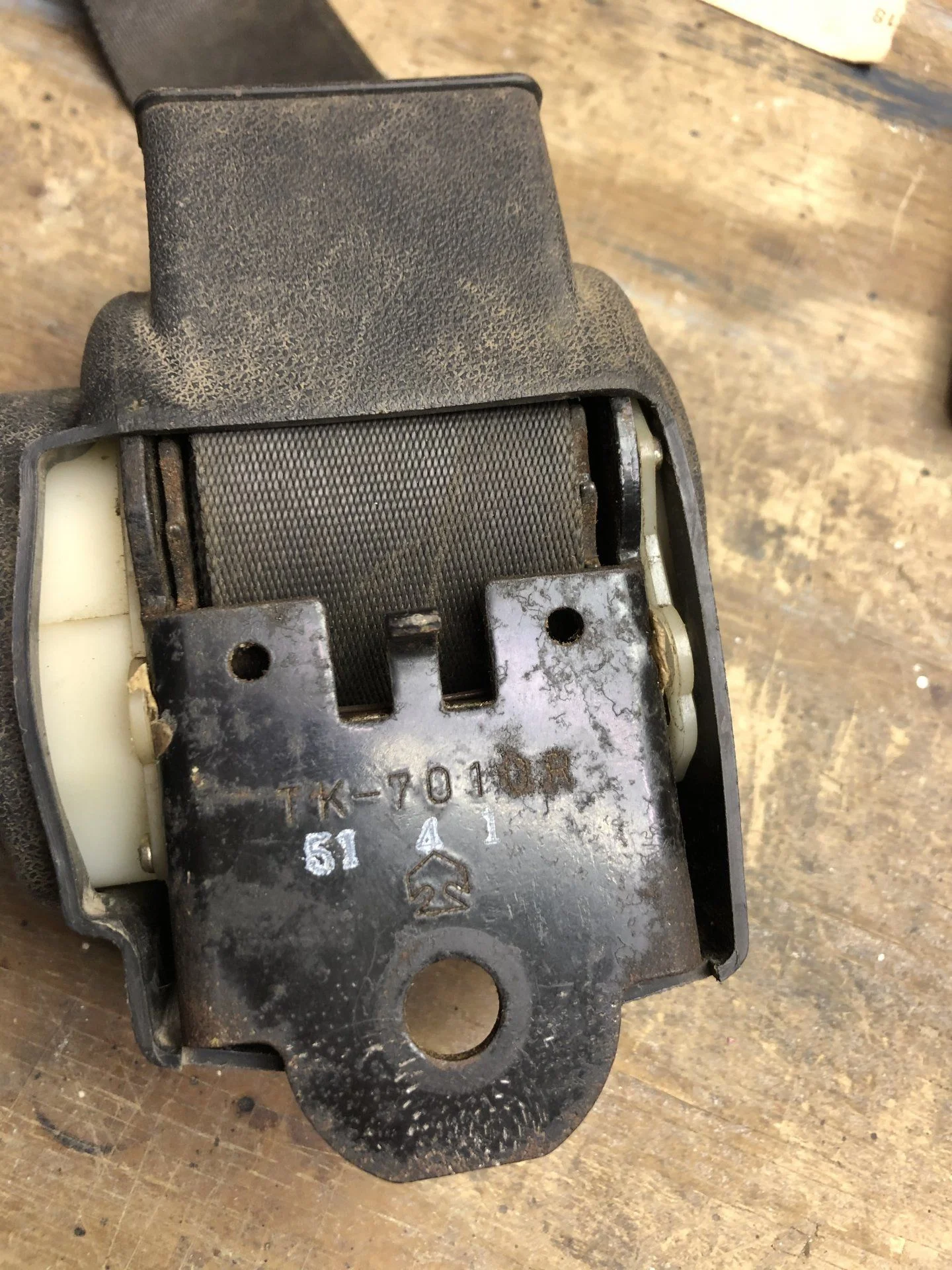

I have this, if you want it and see if you can make it work for you. Not sure if it is the right year for you needs. The catch is different than the one on my ‘82.
It seems to be locked up and I have not taken it apart. Maybe someone will chime in as to weather they can be fixed and made to work. I am not selling, as it is a safety item. Yours just for shipping cost. PM with any thoughts.

Believe the receiver attached to the bucket seat 1/76-12/78. 1/79+ the receiver bolted to the floor. In a vehicle that had three point seat belts from the factory would stick to the original style. My 68 I used one from a 79 because they were available with the roll bar.

I just installed the CCOT seat belts, and so far they seem great. Their site says that they are not intended to mount to the hardtop/OEM mount points, but since I don't have my rollbar in yet, I just went ahead and did that anyway. I just needed a thick washer on the topmost mount point to keep the 7/16 20 bolt from bottoming out on the outside sheetmetal of the hardtop... like some PO had already done! LOL My favorite feature of the CCOT vs any other options was the receiver. It has the round cable stalk with the top facing release button. The stalk could be about an inch shorter, but I suppose it accommodates other usage cases, not sure.

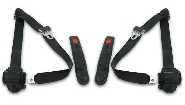

I have the CCOT belts in my '78. They were easy to install and work OK. Sometimes the inertia reel gets stuck and I can't pull it out. They did not seem very robust to me at install. Had I known at the time I would have gone with
These from Seat belt planet
Veteran owned and "assembled" in USA.

I used seat belt planet, SKU305 version belts front and rear as I recall. Attached the upper point and retractor roll cage I put in at the same time. Used a GEO Tracker bench seat in the back. On front seats I ran the outboard mount point back to the fender, so when retracted there was no tripping hazard to get in the back, as if that was the only entanglement of getting in the back of a 40. I used the short 4.5 inch rigid mount receivers as I got tired of the strap mounted ends in my 73 falling down and rattling on the center console. The are nice to buckle into, but stick up real rigid and you can bang you elbow on the whole deal. Maybe the short cable would be better. I mounted them to the seat attachment point where the stock ones were.
My only gripe is that the retractor brake is so damn touchy that they lock up with any movement of the occupant, or any little jostle or bump, which is occurring about 99% of the time a 40 is in motion. They can be tiring off roading because they will lock hard with any sway or movement, not letting you naturally bob and weave with the truck. Also limits leaning forward for stuff, and they even lock if you pull ever so slightly too fast. Forget buckling if you are already moving.
I'm not sure how to remedy the issue. I like the belts overall, but they are way too touchy. But been putting up with if for 6 years, too cheap to try another.
