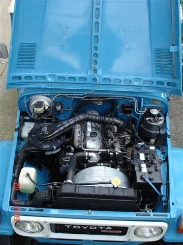

This is one big fan shroud.
...That is a very large fan shroud--any reason why?

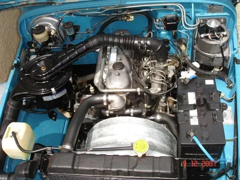

Seems to be just a B-series diesel thing..
Here's another shot of my 1B:
And here's filmpilot's 3B:
