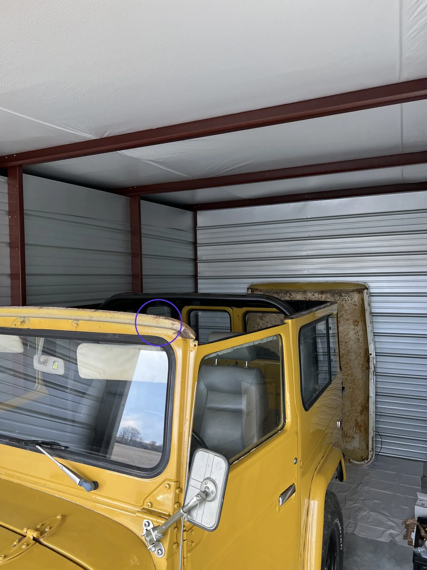

Here are two photos from my experience - one has a circle above the windshield (my roof visor was not riveted to the roof - ugh - another project) - anyway - on the inside of that location is where the wire for the light came up for mine.

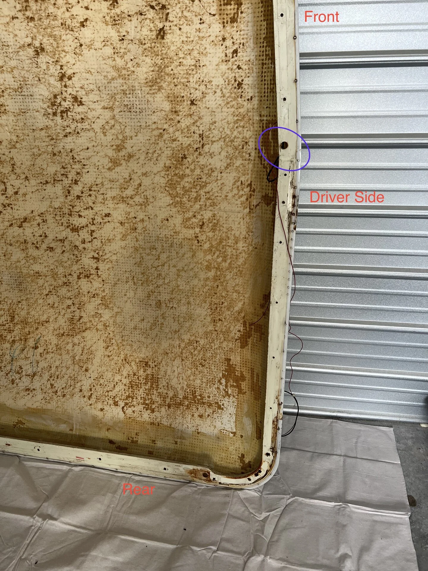

The other photo is with the roof off (the rear is on the ground - I circled the hole where the power goes down for the dome light - Maybe feel above the driver door in the roof rail and see if you get wire.

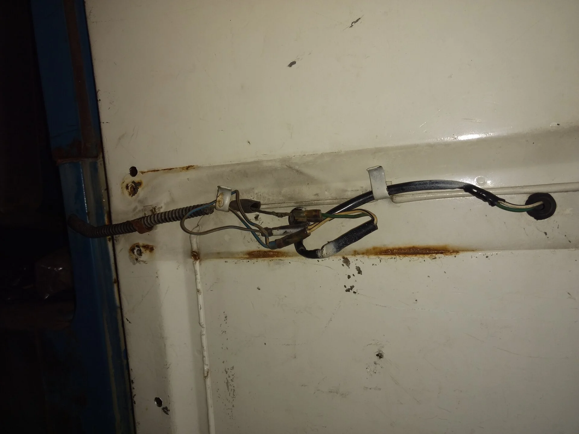

Here is a photo, per @Living in the Past post, of my '77 FJ40's rear license plate light connectors.

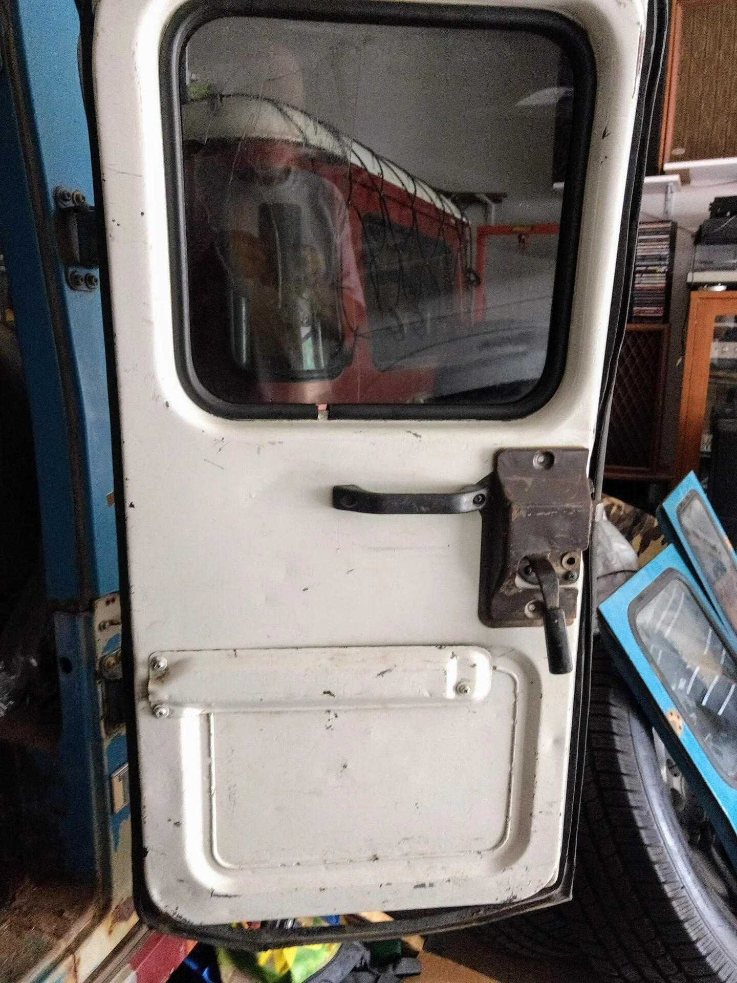

Here is an updated photo of my rear doors.

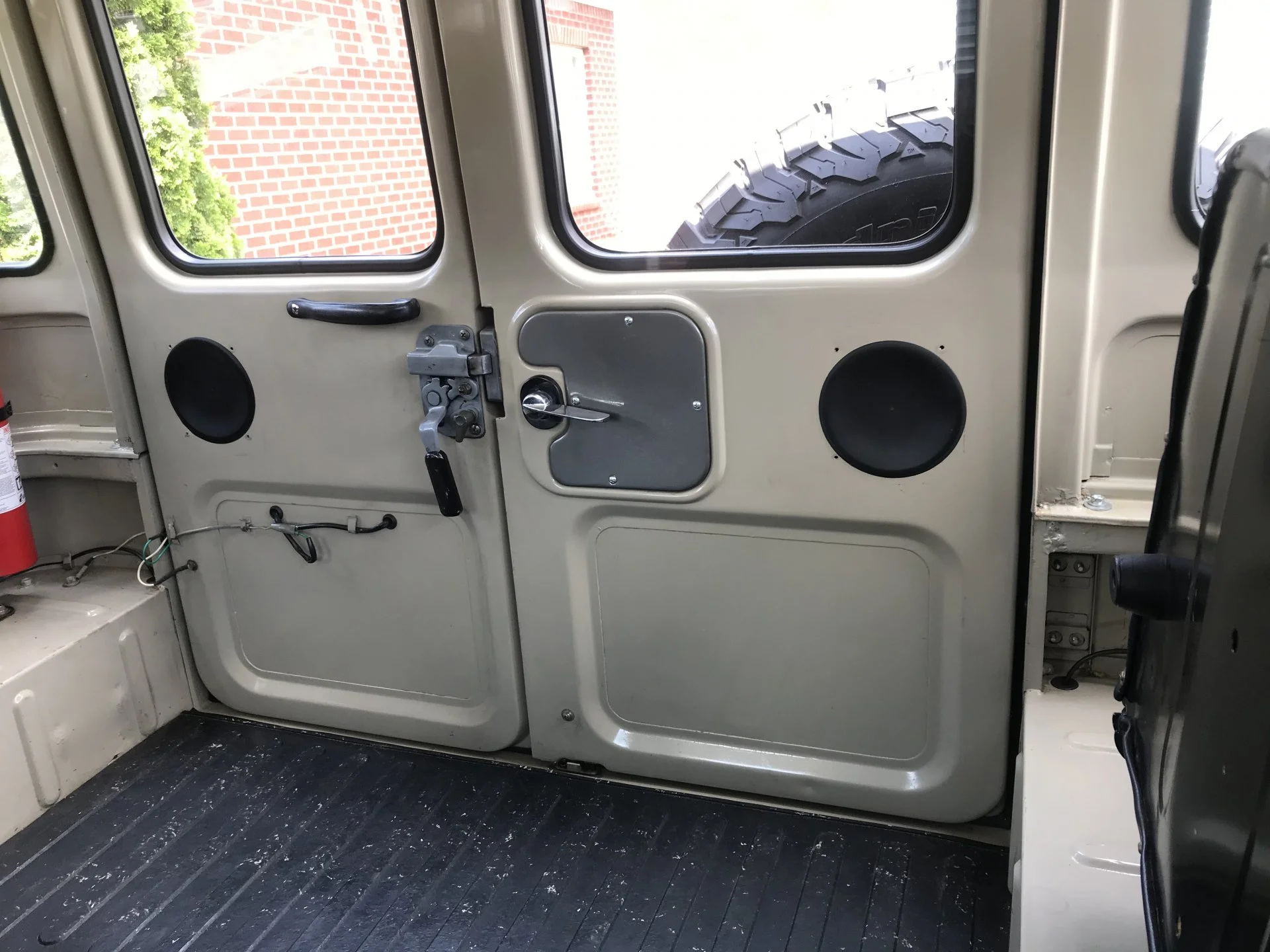

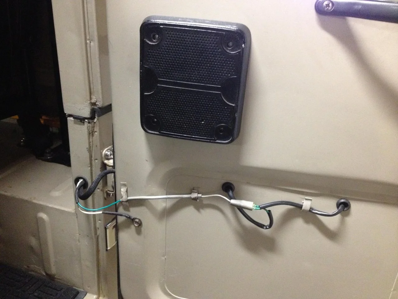

Looks like the harness on my 84 doors off a
wrecked troopy has the bullet connectors as well.
Would be easy to get with the stock harness cover.
Adding a cover like LX models would make it more challenging.
Because the doors will never be perfect plan to mount speakers similar to yours.
