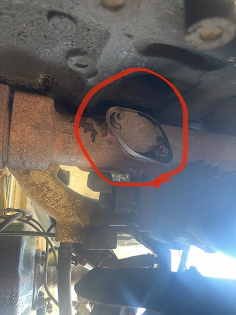

Hi everyone - finally addressing some things on my truck and just can't seem to find this part anywhere - or what it does?
It looks like this part has rusted and deformed a bit - leading to nasty exhaust fumes.
Does anyone know what this part is if it is necessary? Can I just fab something to plug this up?? This photo is looking up at the underside of the exhaust manifold - left side of the photo to the rear of the truck....
Any insight would be great - seems like a pretty easy part to find but can't seem to locate the right manifold or any other info on it!

Homemade EGR blockoff. Contact @FJ40Jim for a buy-once billet solution.

Nothing to stop you from reinventing the wheel. But know that Jim’s block off is a stepped plug. The smaller step fits into the hole of the manifold, so there is no direct exhaust on the gasket. His machinist is a craftsman.😉
