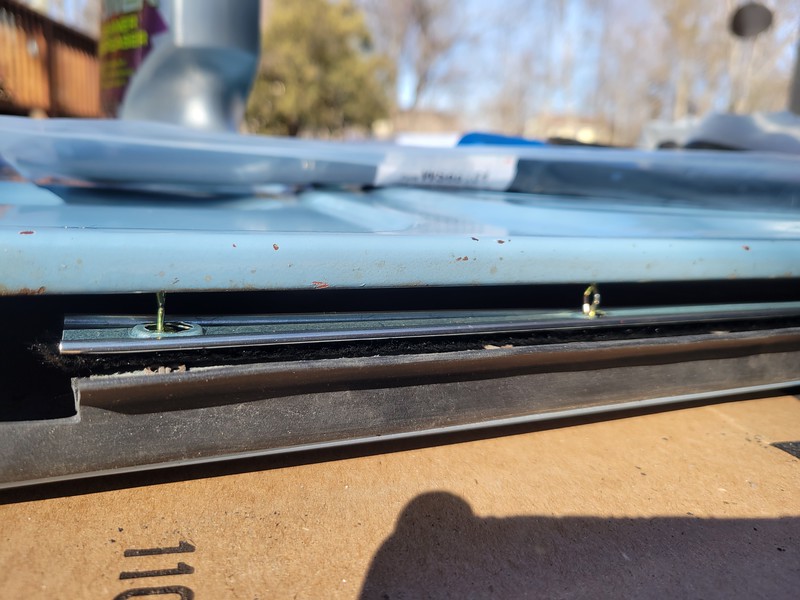

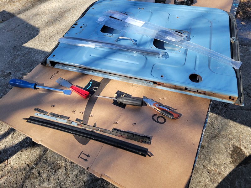

I thought that I bought all of the gaskets, felt, etc. from CCOT to redo the drivers, passengers, and ambulance doors for our FJ project. We get to rebuilding the doors and the exterior squeegee that we were sold by CCOT does not have the metal strip or the fasteners.
Our project FJ did not have either the metal strip or the fasteners on it. CCOT is charging $22 each for the strip with no fasteners.
Any ideas on where to buy the strip or the fasteners. Worst case we can make the strip, I just don't know what the fasteners look like.
Here are the clips
Mr T still sells them, check your local stealership
clip: Toyota 90467-07160 Clip
1969-1975 Toyota Land Cruiser 9046707160 around $4.15
outer weather strip/belt : Toyota 68161-60010 Weatherstrip, Front Door Glass, Outer
1969-1975 Toyota Land Cruiser 6816160010 $9
Metal plate : Toyota 68221-60020 Plate, Front Door Window Outer Weatherstrip Set
1969-1975 Toyota Land Cruiser 6822160020 $3.60
Hope this helps.... :)

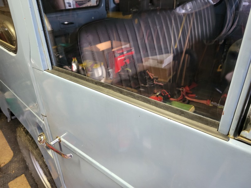

Does anyone know if there are rubber weather seals like this for a ‘77. I’ve been having water in my door panel and everything I see it’s just felt on the outer seal. I’m not sure that felt will hold out the rain. I would order these ones but I believe the window was smaller on the older models.
I did them on my '69 not too long ago and got parts from cruiser outfitters. I re used my clips and metal strips on the rubber side.
