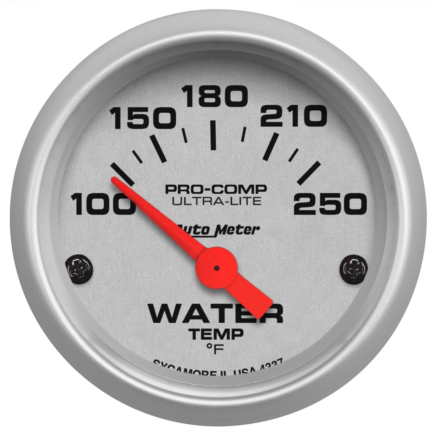

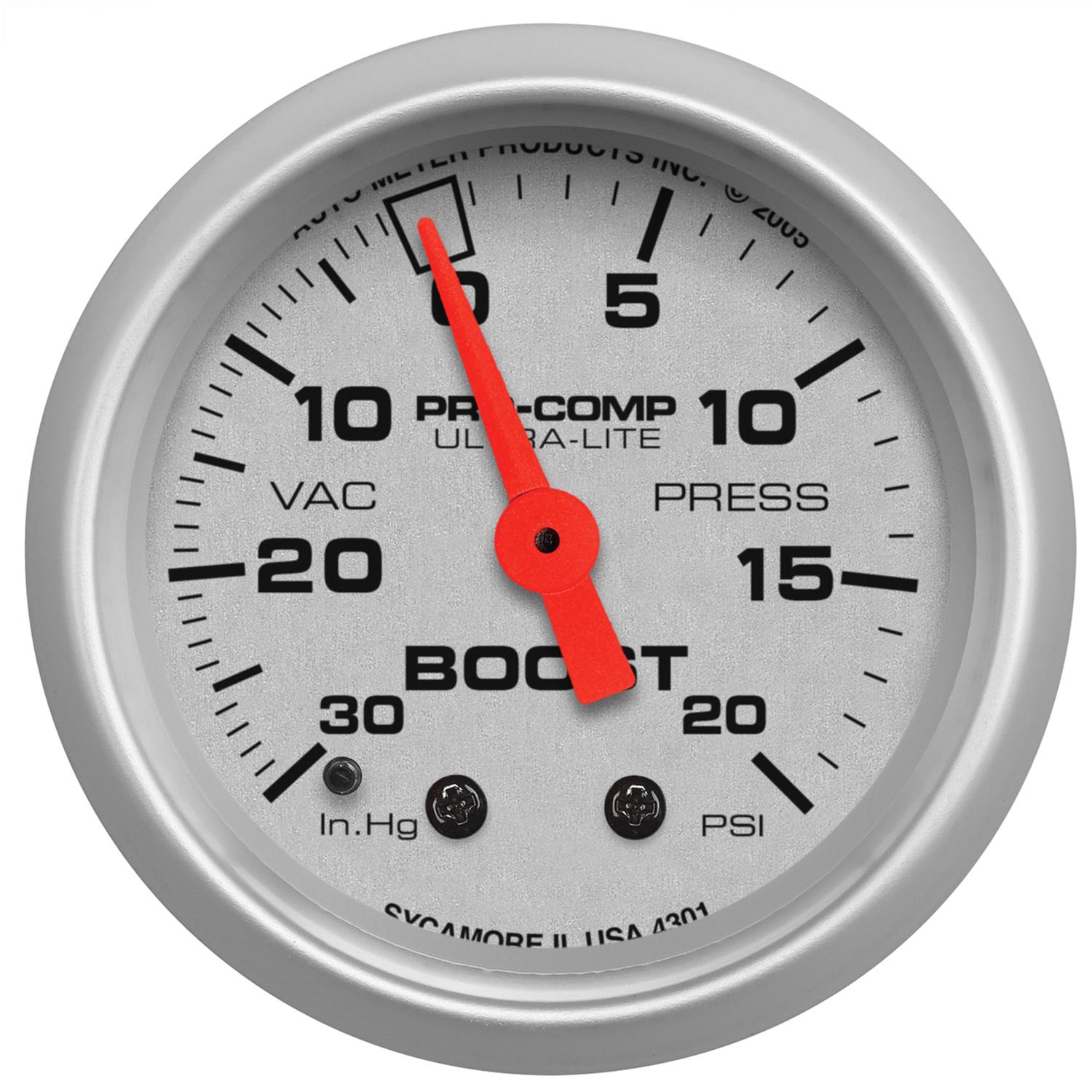

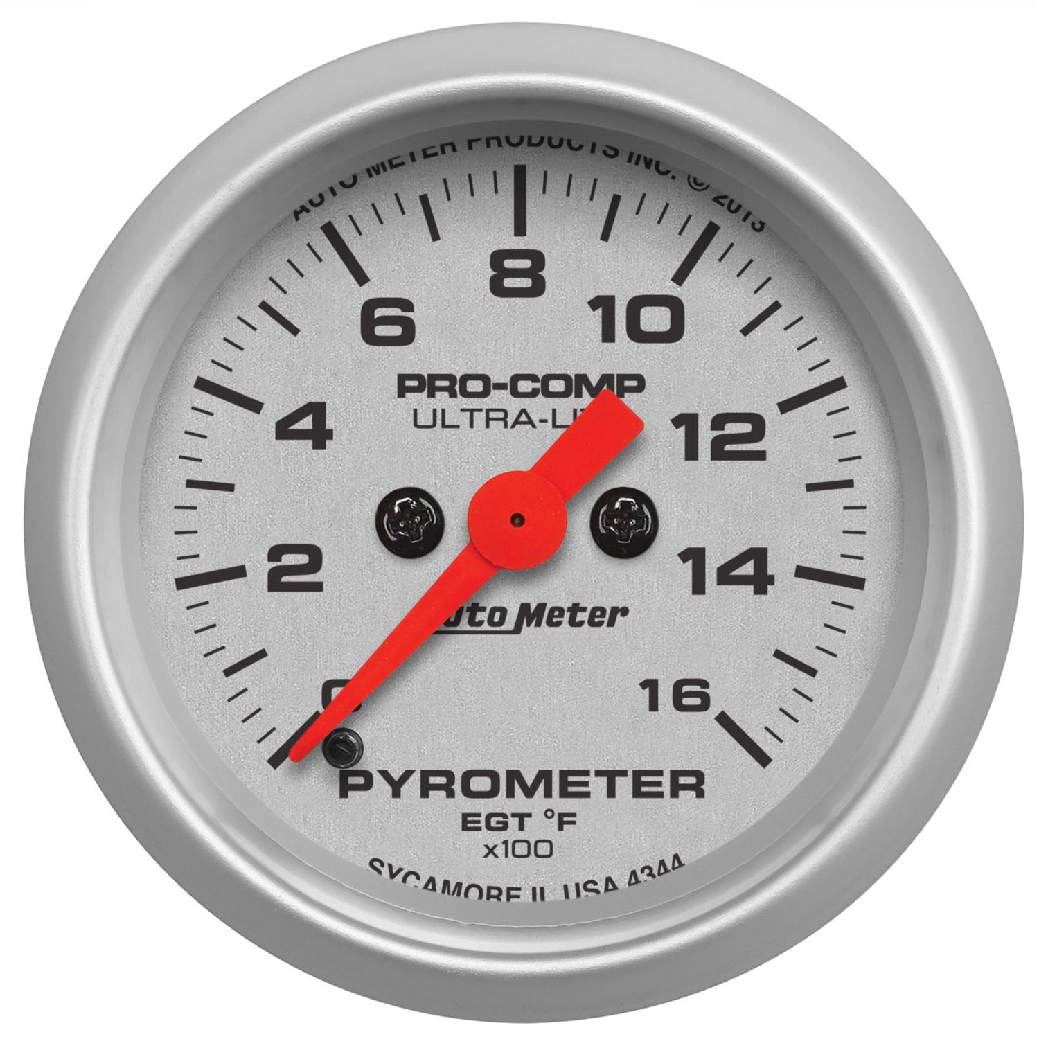

Looking at Dan's gauge pod that he built, anyone see any issues with these pods?
