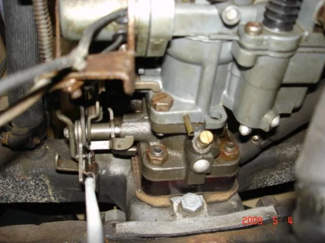

Hi All,I need to get a part for my sept.24 1971 carb on my 69 40 with a 71 F eng. The code stamp reads: 1 I 24.I am looking for the loop bracket that the gas pedal cable goes through(does the cable just pass through there or how do I nut it on there?).I took a pic.off the SOR page and drew an arrow to the part I am missing.
I will post up a pic.of my carb. also.I am just trying to hook up the throttle cable and it seems this is the part I am missing.The carb.was rebuilt by a felow ih8mudder I bought it off.Any advice would be great and yes I did search lots of info on throttle cable,carb.

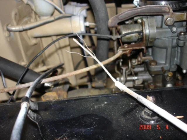

One last thing the end of my cable is missing a little part that hooks it onto the carb.Almost looks like on a bike hand brake cable?

Thanks Dusty,I have checked out his site.I just could not find the PN# or a pic. of what I need.Do I need a new cable also cause it's just the bare cable at the very end of it.

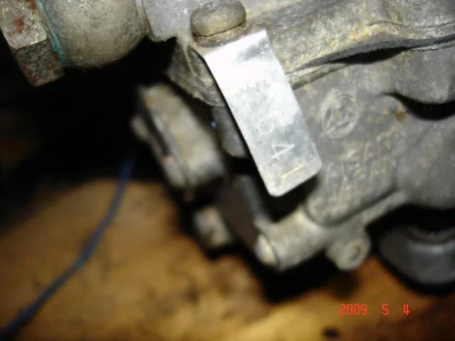

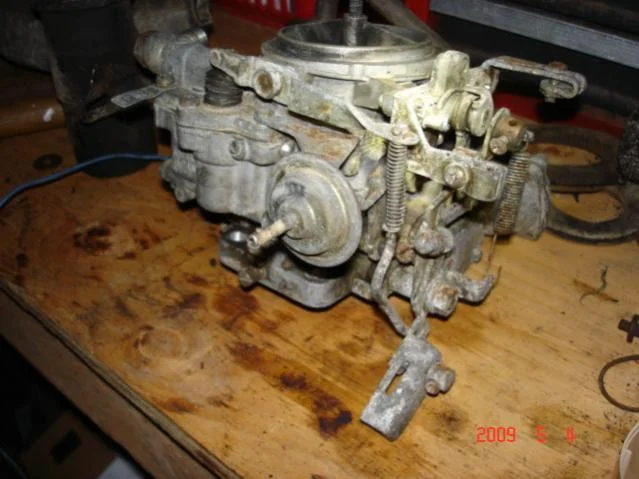

I will post up a pic. of the end of my cable.Also a few pics.of my old carb. I have not tryed to find out the manufacture date on the old one(it's a later year model from a 2F? It has the threaded bolt for the air cleaner) The silver tag screwed on it reads: H2641, I looked for a stamped code on the carb.itself,but all I saw was the ISO stamp

Yes, get a new cable. It has a threaded end on the sheath. You use 2 nuts to position it correctly on the bracket. Mark A probably has the bracket. Just call him up and tell him what you need.

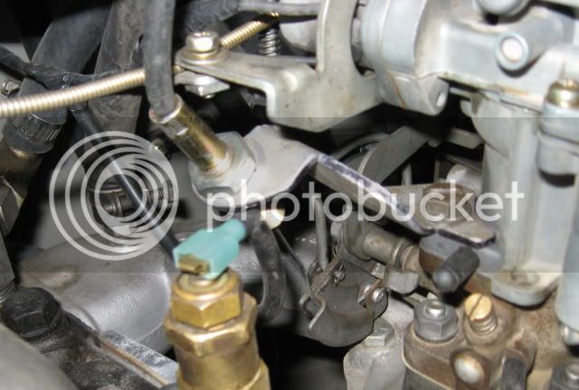

Now do I need anything to mount the accel. cable to the carb. bracket? I saw a nut/washer on another photo somewhere that looks like it bolts the cable to the bracket then it passes through to hook onto the carb.

you are correct, As I remember 057-11 bracket is alll that is needed at the carb the high Quality cable Mark sells comes with the two lock nuts :cheers:
I'll see If I can post up a picture
Good photo thanks! I will give Mark a call.I wonder if that same cable will fit on the inside with my 7/69 40,I have not looked at the gas petal itself for a wile?

Yes, those are the required parts.
The carb w/ the center bolt air cleaner is the rare 3/69-9/69 USA 2bbl. It is too small, only a 32/36. Was used for 6 months to get by emissions until the new Cruiser specific 38/38 was available & successfully smogged.
Thanks Jim C.,I had no idea that carb. was from a 69.Thats pretty cool I guess,is it worth anything to anybody cause I don't need it for my truck any more.
