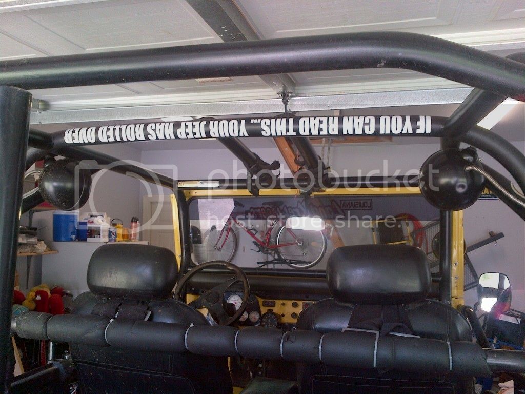

I do not have a center console which seems to be most people's location of choice, so I am trying to come up with mounting options for a stereo. I think I am going to use 2 wakeboard speakers mounted to roll bar, but need to tap into the infinite ingenuity of the Mud community for stereo options.

Are you looking for where to put the headunit, speakers or both? What does your dash look like? have a full cage with spreader bars over the driver / passenger? Pics of the interior of your rig would help us help you. :D
I have the tuffy center console with the stereo compartment for the headunit and I used KC fog lights for the speakers mounted to the cage.
head unit
Trying to determine a location for head unit. Not interested in cutting the dash. Going to mount the two speakers behind head on roll bar.

Looking at a couple kicker wakeboard tower speakers that mount to roll bar.

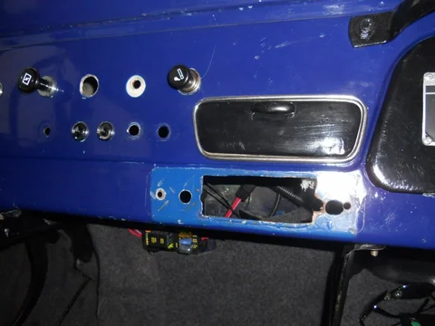

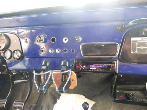

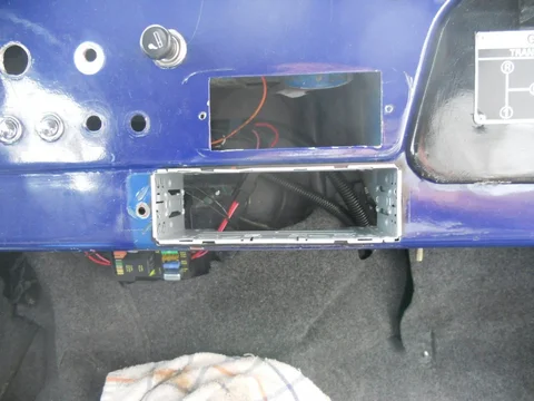

The purists will cringe at the sight of this dash board but many of us have no control over what has been passed down over the years. In December 12 when I bought this rig it had two radios, one installed in the dash and one under the dash. Above the right cup holder (that I added) were two simple on/off toggle switches to operate the radios. Of course the installation was twisted wire and black tape. So now that I have the rig completely rewired (American Autowire Hwy 15) and operational for a month it was time to add some tunes. I did some work at the rear support of the unit to at least slow down the potential thief. The rig came with a pair of Kicker speakers, 6 x 9 3 way, that I had no idea if they even worked. But I cleaned them up, corrected the wiring and they sound great.
