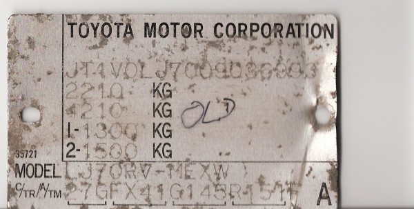

You should find the chassis plate on the firewall which will have the relevant weights on it:
On this plate:...
2210 is the maximum gross vehicle weight.
4210 is the maximum train weight(trailer,load,and towing vehicle)
1 is the maximum front axle weight.
2 is the maximum rear axle weight.
So this lj70 can tow 2000kgs....(subject to it not overloading the individual axles...)
All you have to do is:
Max train weight - Max gross vehicle weight = Max trailer weight
Afaik all short wheelbase 70s are only rated to tow 2000kg (in Europe and Japan anyway) which is crap! If a LandRover 90 is rated to tow 3500kgs with its scrap metal drive chain and useless brakes then a 70 series Yota definitely can! What were Toyota thinking!?

actually, your answer is wrong.
the original poster mentioned he lives in Alberta and VERY likely will be towing into BC.
the firewall plate will be from Japan since he is talking a recent JDM import
max allowable weights and common sense.
to take this one step further, you are saying that an imported from NZ or Netherlands or Oz with the above plate makes it acceptable and realistic in Alberta or BC? no, you mentioned practicality. so for practicality a LJ will die a painfull death trying to pull 4000 lbs across the Oz outback. so if the original poster looks at his plate (which i "think" is missing on the JDM trucks) then those figures are a dangerous error to be avoided..
so, in a nutshell, the plates are worth about as much as it cost to produce them.

And crushers is right, JDM/Oz vehicles don't have that plate.
