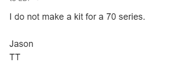

TT do not make a kit

Yeah that would be a 60 series kit not a 70 series kit
