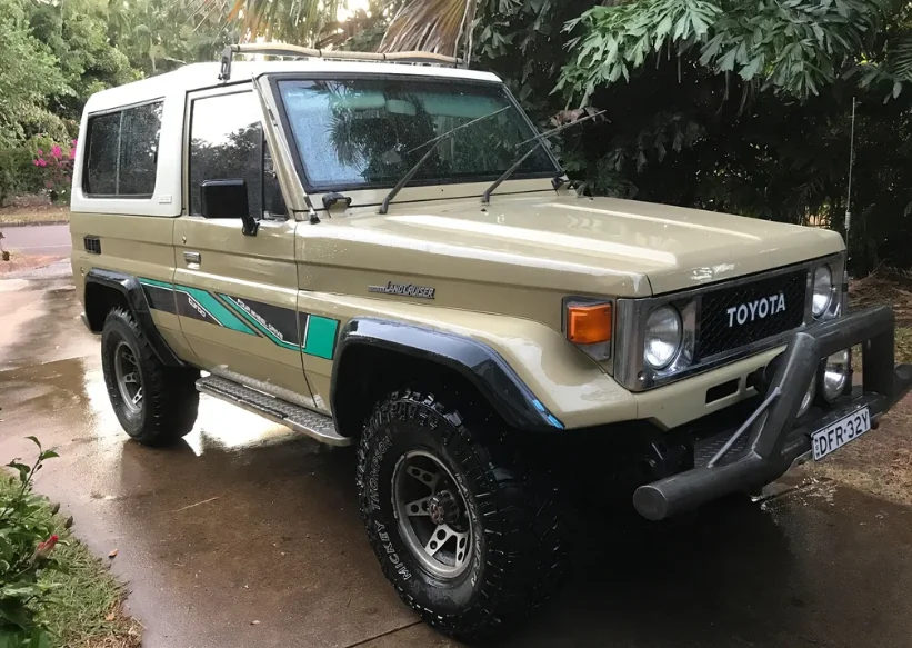

Doing the build isn't a concern, I am just looking for some pics of what the diff width looks like in an early gen 70 series ( 1986 BJ74 ) .

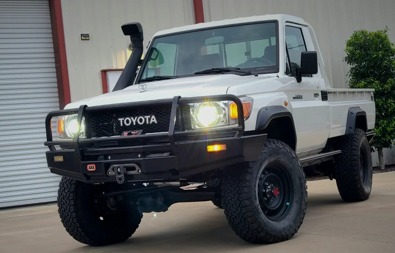

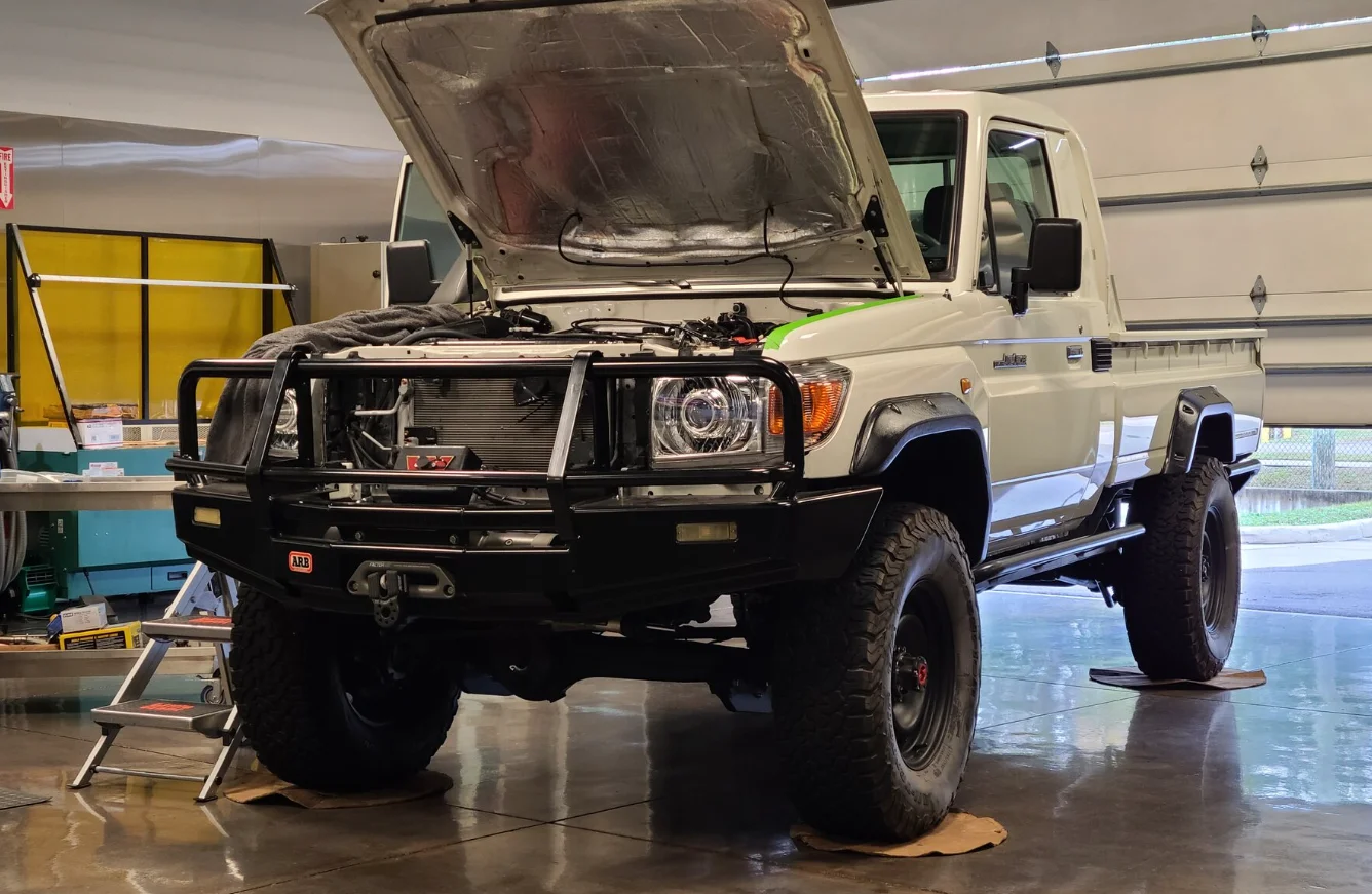

Dozens and dozens of photos in all of the build threads that have been mentioned by others. By "diffs", I assume what you really mean is 80 series axles? I picked a random build thread just as an example. Post #1577 in this link has multiple photos and if you go earlier in the thread there are dozens more. Again, that's just one example of many.

The build thread is what i would call a wide body and I was looking for teh earlier which has a different fender profile etc and from what I have been told is narrower but maybe it isn't
The fenders look to sit out from the door significanty more than the earlier which is more inline, I am thinking of doing a BJ74 thats an 86 model so its the earlier style body.

Gotcha. You probably won't find the earlier 70 series in the US threads because we can import them without doing anything. The only reason people are putting late model 79 bodies on 80 series chassis is to circumvent the import restriction on the 79 series pickups. Without those restrictions they would just import the truck and call it a day.
