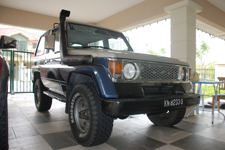

I recently acquired an old Toyota Land Cruiser short base (70 series) with a 2.5L 1JZ twin turbo installed on board. We are currently preparing it for the conditions of the rain forest of Borneo. I'm member of a 4x4 club there named SAKTA. This is a group of passionate people with a huge experience in the extreme conditions of the jungle of Borneo. :cheers:
Originally this car was used for street racing an drifting and had never seen muddy conditions in its life. This mistake is corrected! You can have a look at the transformation at Picasa Web Albums - olive_fr I have posted there many pics of the different phases of the modifications, which are still going on! :wrench:
Here are few pics:
The Toy before the transformation... a 20 years old 70 series.

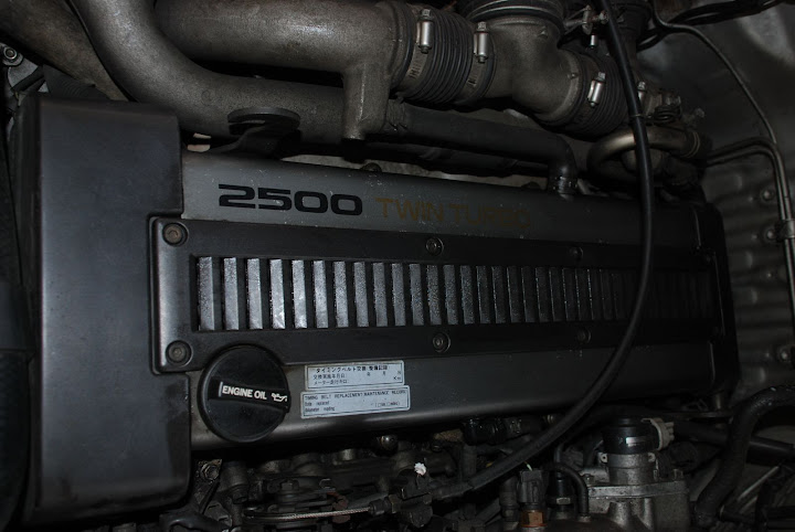

The 2.5L 1JZ-GTE fitting in the hood. Enough power to tackle the muddy conditions of the Rain forest.

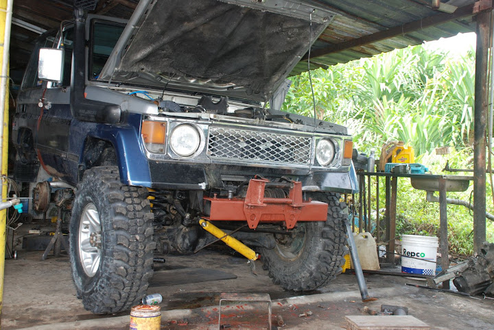

After 2 weeks of work. 4" suspension lift by Old Man Emu, 35" Extreme Trekker tyres. Almost ready to go!

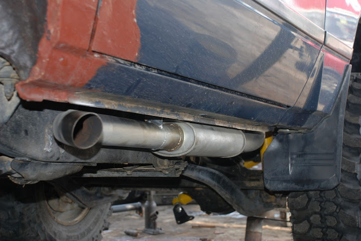

Exhaust line placed on the side, will be protected by the tubular side steps.

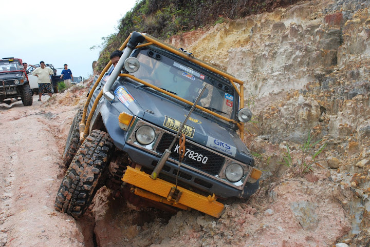

A PTO winch has been installed. Absolutely necessary to pull you out of a mud pit.
And more to come in 2 weeks. Going out this Monday and after that 2 weeks of more preparation to finish the body rust, install a front and rear bumper, side protection as well as an external roll cage. Then there will still be some other improvements the latest being the installation of 2 ARB lockers for the front and rear axle.
Don't hesitate to ask questions if you have. If you plan to visit Borneo one of this days and specially Kuching, drop me a message! :steer:

do you think the PTO is better than electric?
What do you do to keep the shear pin from breaking,bigger pin??

Regarding the PTO, I'm not yet an expert (far from it), but my friends of the SAKTA definitely are! We don't have snow here, but if you look at some pics on my Picasa you can see that we have among the toughest Mud conditions. That's why they use PTO, because when stuck in the mud pits here you can need more than 10 tons of pulling force. Look one of my gallery, the one with a blue Dayatsy jeep, we had to pull a heavy long based using 2 PTO, one pulley and the 2 cars were attached to trees. Electric winch would be burn in such condition. We use electric winches on lighter vehicles like the Suzuki jeep.
The Pin issue is the known problem, mine will have to be reinforced as well.
There will be an electric winch at the back of my truck. All my friends who compete use PTO and have a mechanism to sue it in front and back.

i wonder why you are using a 1JZ which requiers high revvs etc since this is not a VVTI its almost impossible to drive under 2000rpm and tears the jungle up leaving only a ploughed pair of tracks.
Surely a 3.0 diesel would be more suited.
Most PTOs here are welded up to stop the shearing.
Well I got the opportunity to get this truck for less than 4000euros. The swap was already done. In fact the engine gives already a lot of power between 1500 to 3000rpm. When used with low gear ratio it just reacts like an electric motor. I rarely use it above 4000rpm, but when you need power to extract you from any situation... just press the pedal and you get everything you need!
I've been racing enduro (motorbike) for few years and if could compare this vehicle with a bike its a very easy 250cc two stroke bike! In fact the weight/power ratio of this car is comparable to the one of my enduro bike.
Once everything will be installed on the car, including workmanship, I will go to a bill around 10000euros for a car I intend to use both for touring and average competitions here in Malaysia and south east Asia. Quite a pretty good deal.
Regarding the engine many of my friends are using either 1JZ-GTE or 2JZ (turbo or not) and for the type of terrain we have it has proved to be a good base. Of course some are using diesel engine, often 4.2L boosted with a turbo. A 3L diesel is a very good engine for european conditions or african raids. During our Jamboree we always need heavy duty recovery car to either winch or pull, specially from severe mud pit.

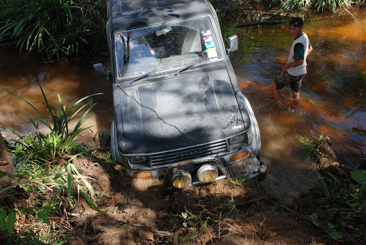

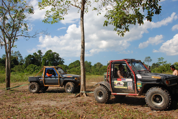

To recover this car we used, 2 PTO, one connected via a pulley to double the pulling power.
The blue one is powered by a 2JZ, the black one by a 1JZ-GTE
But well sometimes, even power is not enough!:lol:
