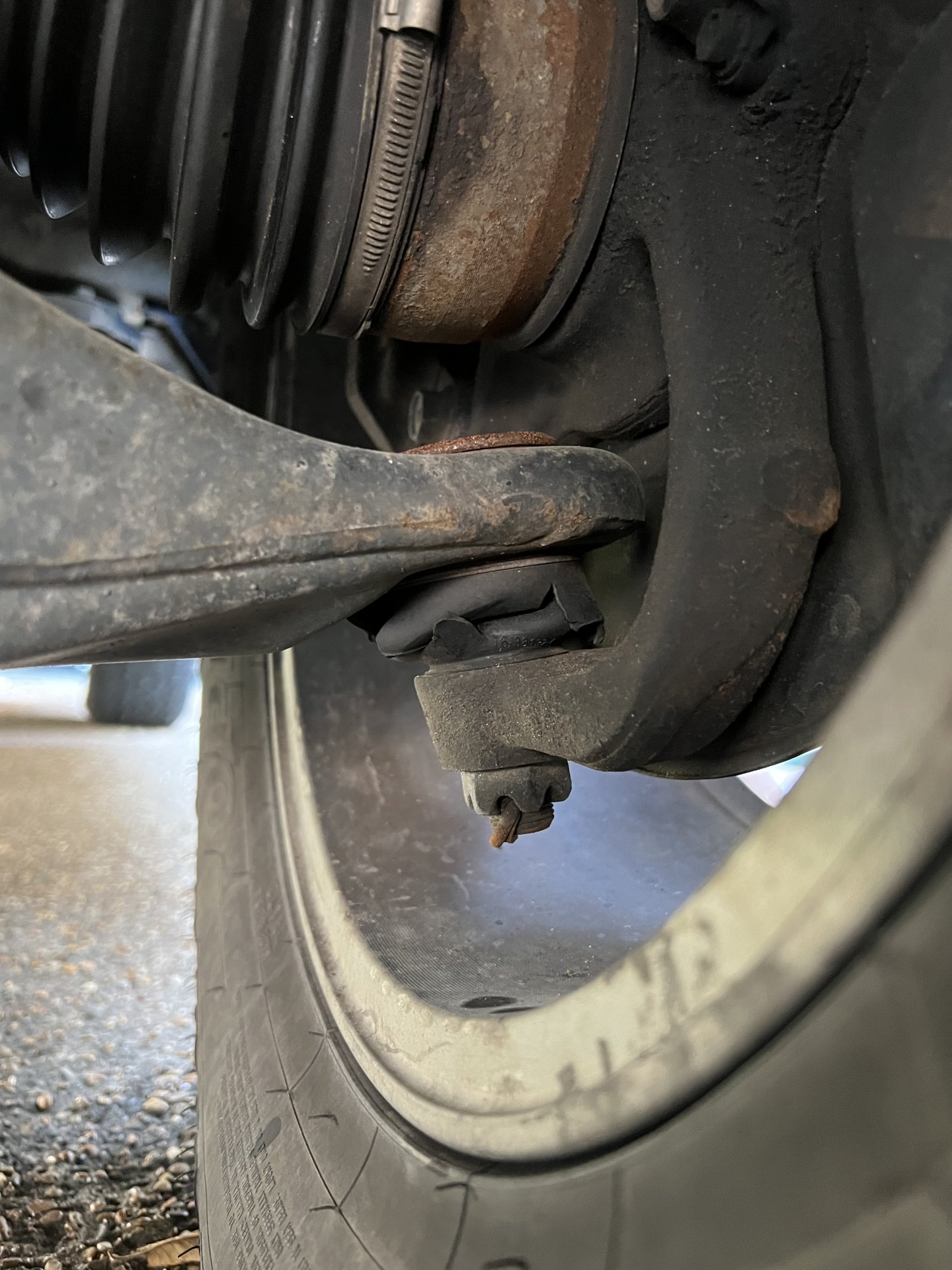

555 lower ball joint boot torn in 500 miles.
I've got 50k miles on all 4 new 555 joints, no issues. Sounds like an install issue or random road debris.
This is what I’m seeing, and actually I had an 03 LC I had these done in years ago. I sold it to a friend who’s still driving it and no issues. I want to say it was install error. Truck hasn’t been driven enough for any debris lol. Things is a driveway ornament at this point.

So how much lower did you press it down? I’m wondering what it looks like compared to mine, any pics?

I recently installed new 555 ball joints and put a little hole in the boot using a pick tool to remove the spring that retains the boot. Happened to check a week or so ago and the hole had opened up to an inch or so. I bought another 555 ball joint and took the boot from it. I bet an OEM boot would work as well. Live and learn.
