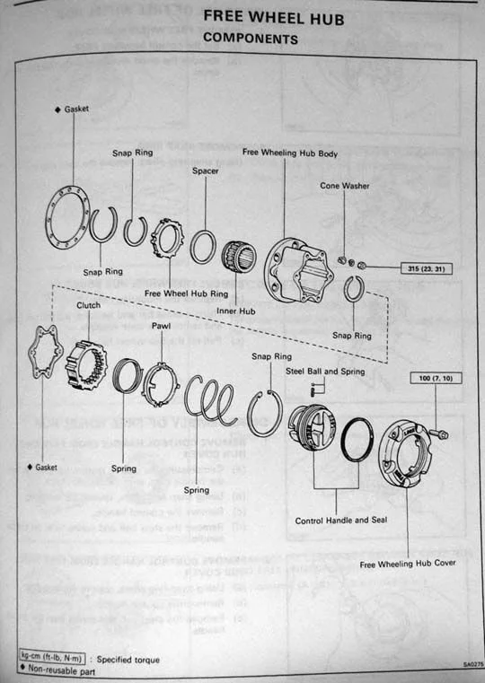

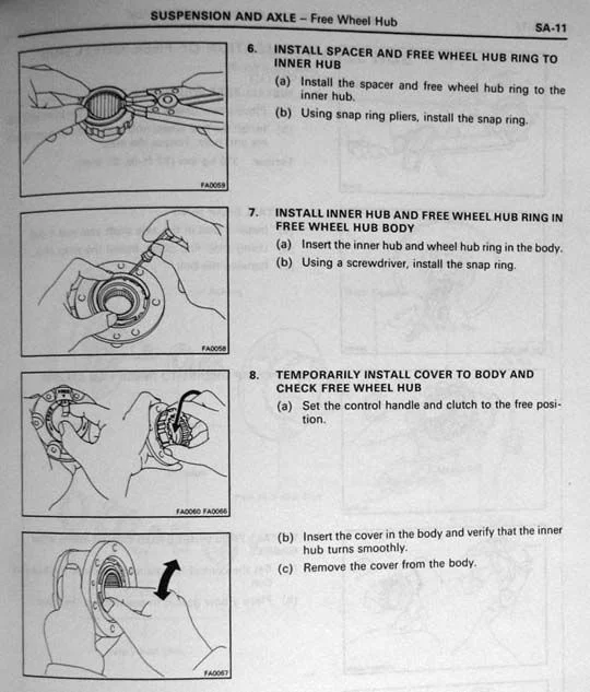

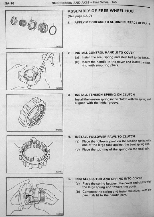

From the FSM
Those pics make it sound way harder than it is. Yank the 6 bolts that hold the outer cover on, the sliding piece that engages the hub comes with it. Scoop all the gook out, reinstall (30 seconds), if it doesnt work proceed with further disassembly and removal of old grease. There is little you could screw up, aside from forgetting how to put it back together if you really break it down.
