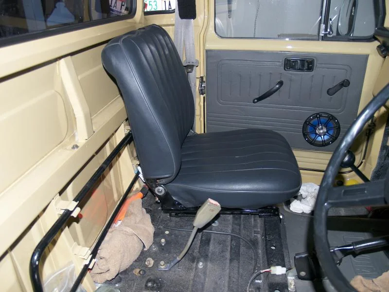

I have a small pad on my stock seat. It lifts me up a bit and gives me a more movement in my legs. I am about 5"11. I also added an extra 1" of foam to the seat when i reupholstered.
I got the idea from Landcrusher909 (Rob, 6'+), who has logged many long days in his 45 traipzing about the country.
Sorry, but I have no experience with non-stock seat options.

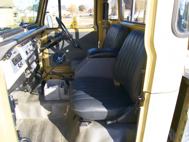

You may want to message cirbo on here
He put that style seat in an stock cab and was able to keep his center console. Think he ended up with 4 pt belts, maybe just lap belts, but might be worth asking the brand. IIRC they were a model of Recaro. What was nice was the bolstering on the sides wasnt so tall/deep that it made entering/exiting a pain.
Only pic I have of the inside. HTH

The sides of the one seat were pretty wide and tall making me believe the use of my center console would have to go and the seat belt stands will be to short to reach. I pretty much have conclude that the stock seat would benefit from some new foam. I still may change my mind with info and ideas such as this one. Looks pretty nice. My PM him with questions.
