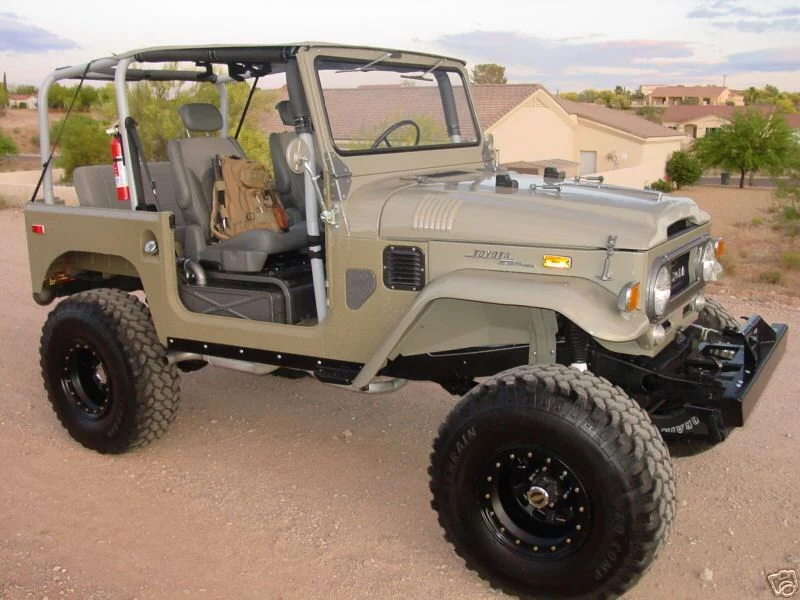

I've been shopping for and saving pics of cages. The cage on this beautiful rig looks like a 4+plus cage to me. Chula Vista FJ40 could probably verify this.
Sure wish this was my 40!!!!

That tan one has some of the same characteristics as on my blue 74. Especially the rocker guard pieces.Some of the same paint sceme on the bezel, kick panels ect.. I got it from a guy in Rehoboth Beach Delaware who claimed he got it from someone in AZ. Be neat to know the history. Jeff :beer:
Hey Jeff,
This is where that tan one originated. You could give em a call to see if thats where yours came from.
Vulture Mine Crusers product awsome Vintage Land Crusers
Also, more pics of the 4+plus cages there.
