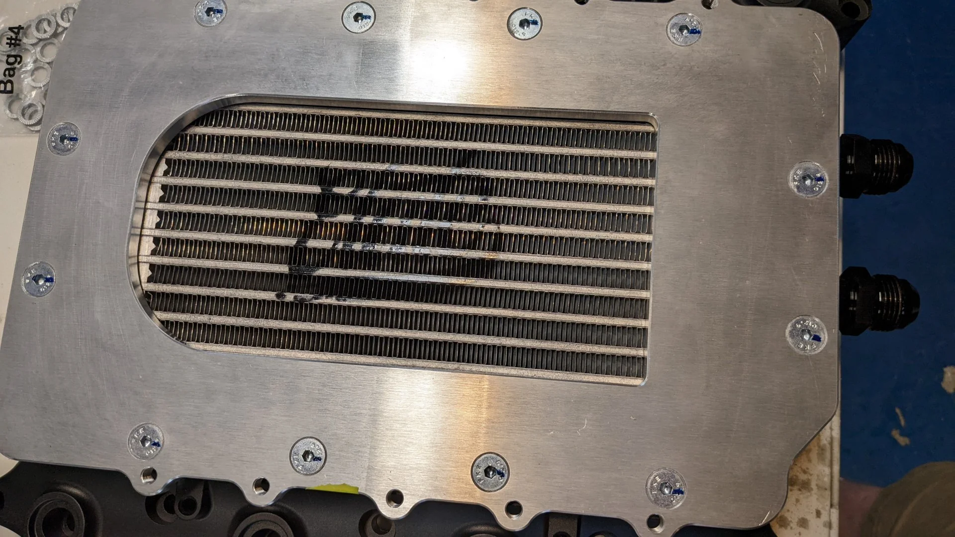

Another option for an Australian supercharger for the 2UZ is Elate. Compatible with VVTI and non-VVTI. Intercooled and non-intercooled options. They also sell a W2A heat exchanger kit with all the hardware and tubing and electric pump and it undercuts the Bullet by about $2k USD. Uses the same Harrop blower as the Bullet but has a front facing intake.

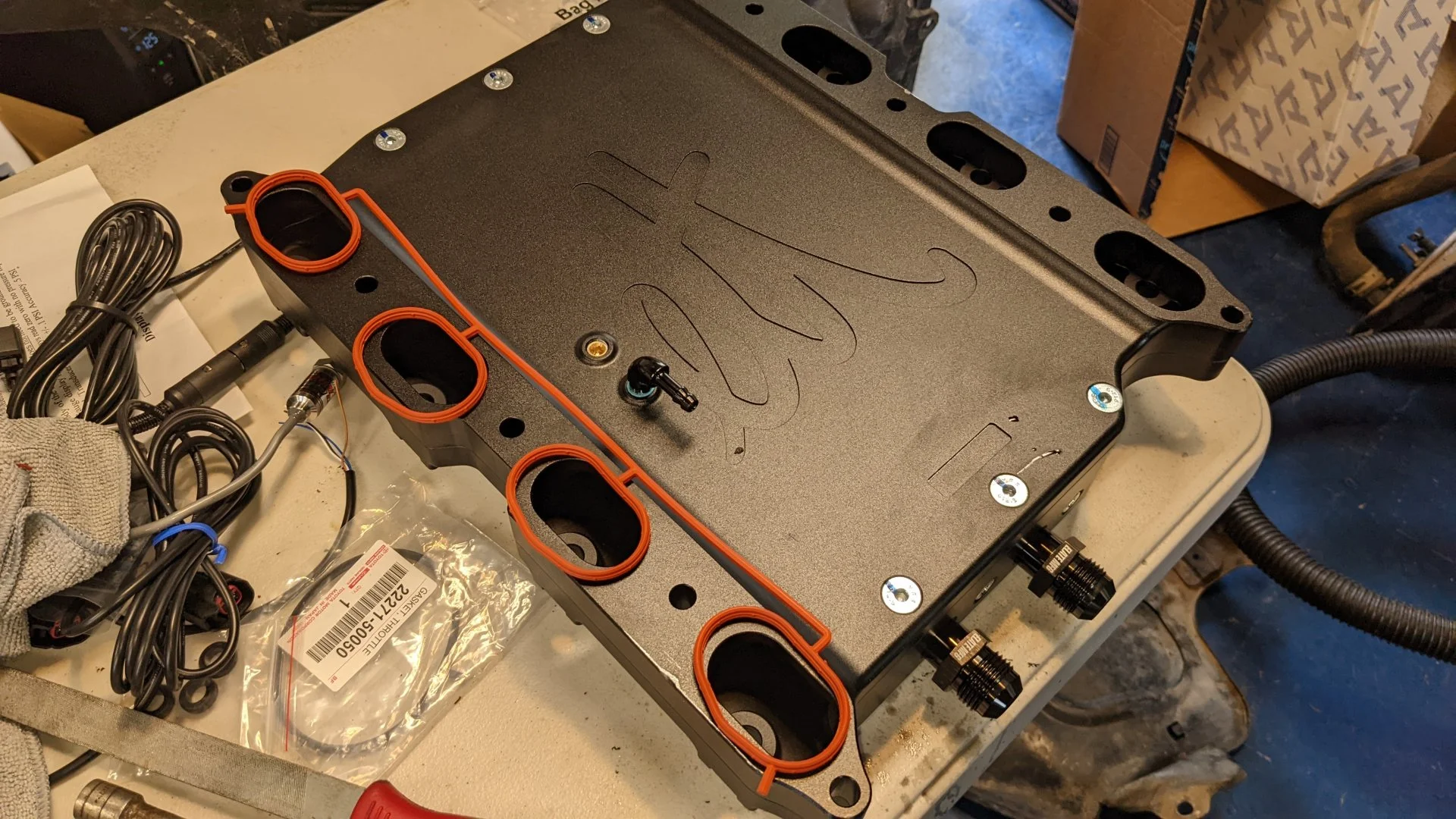

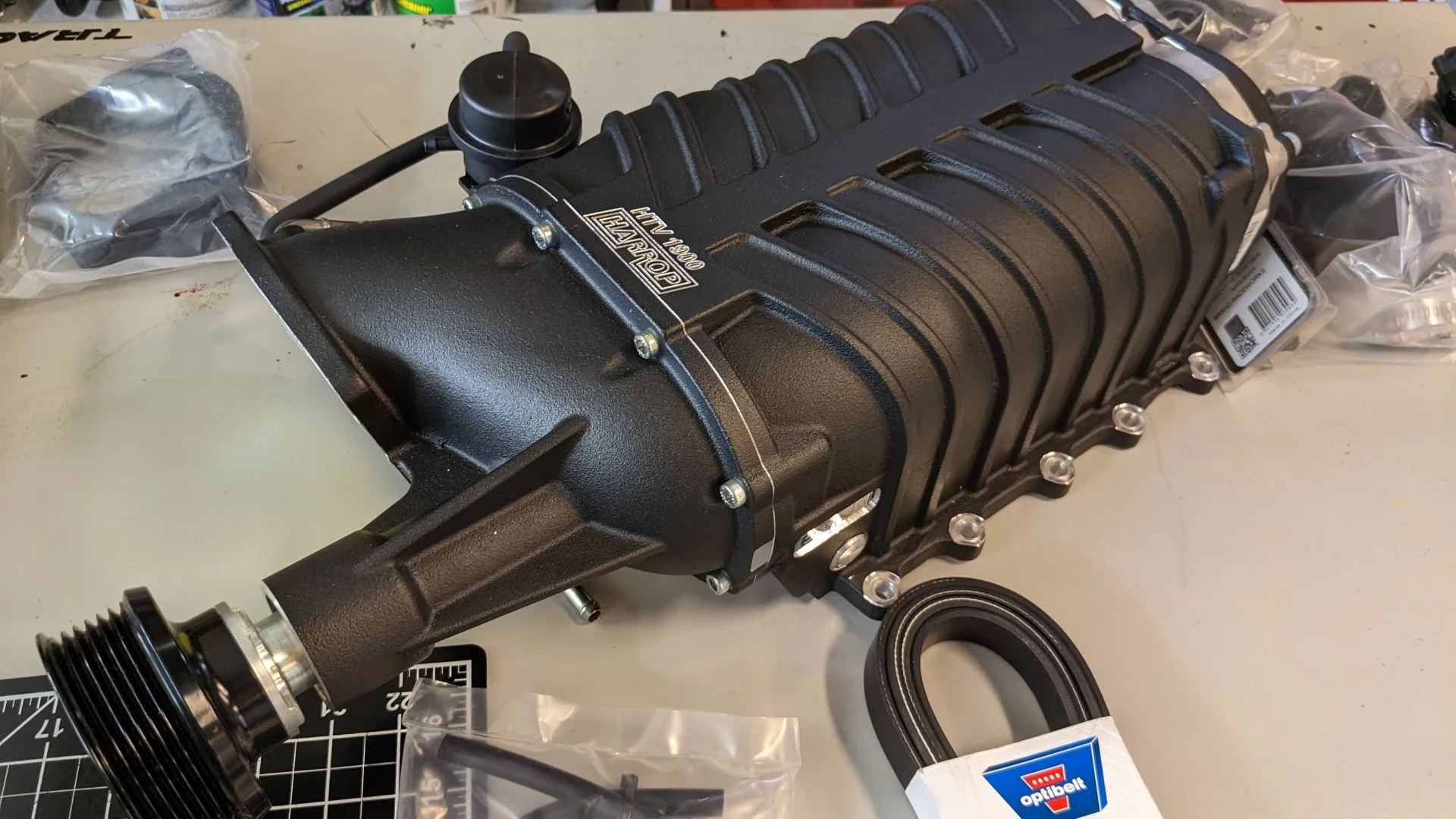

Part way through my Elate install. I guess they forgot to include some parts so I'm waiting but so far I'm seriously impressed with the hardware.

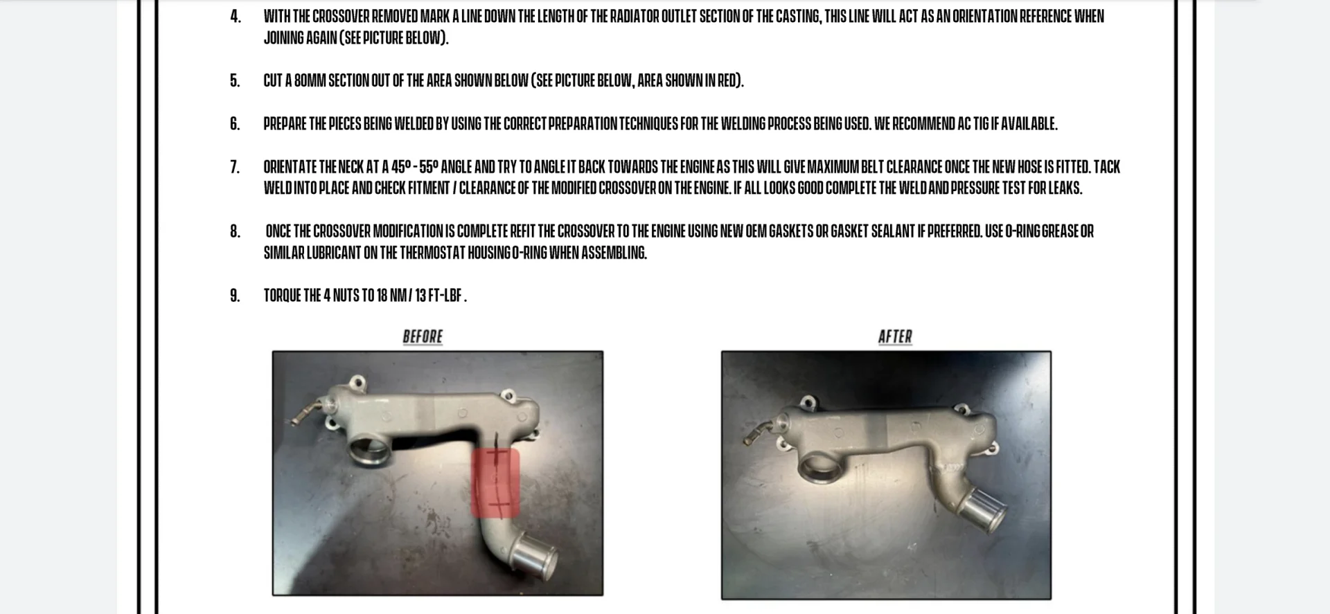

You do have to modify the water neck slightly, however.

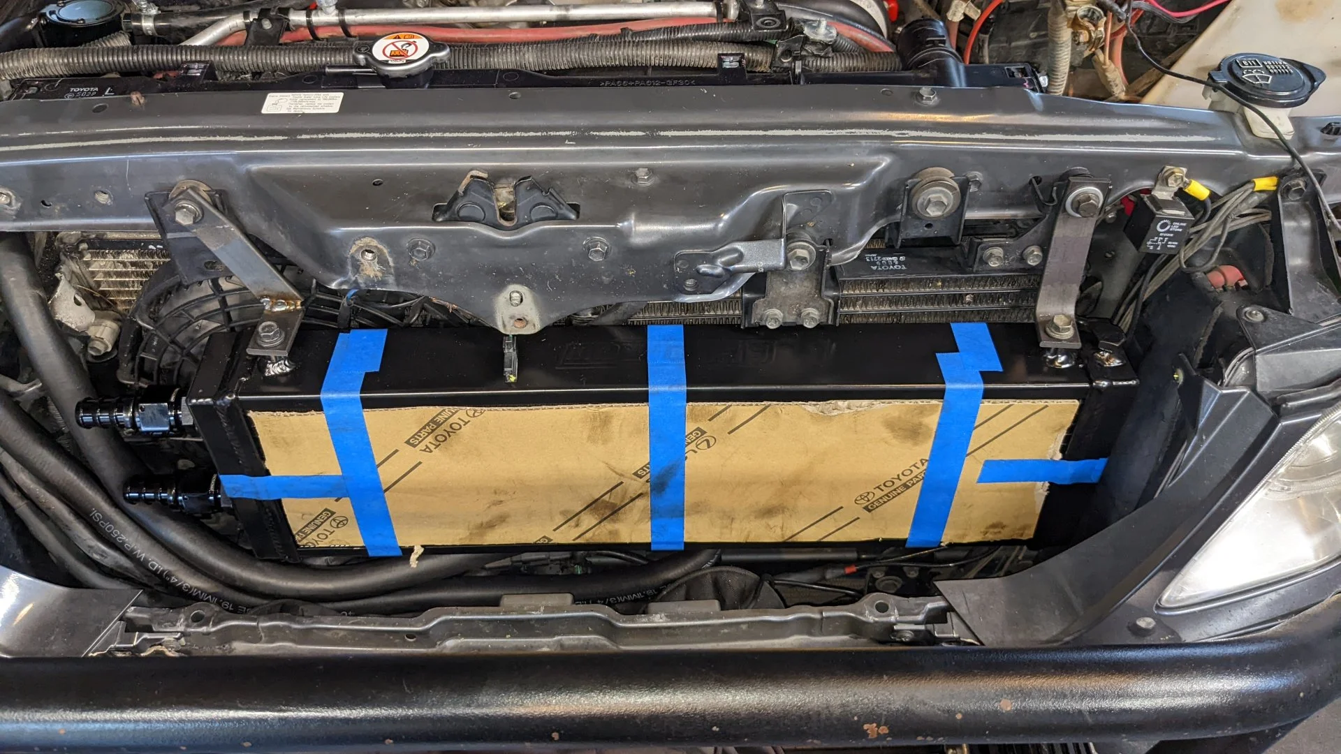

I went for the full setup with intercooler.
