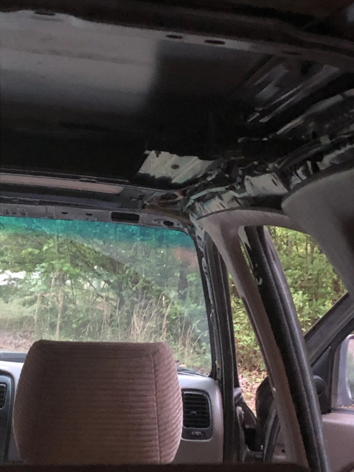

Even with new buttons on stand-by, if I try to remove without the proper tool, I will gouge/scar my headliner, so...
I ran to O'Rielly's auto parts and bought a 5-piece interior trim tool kit. They are red plastic pieces and look like mini pry bars...$13 for the kit.
These worked well to pop the buttons out. Each button still broke (somewhat) but only one of them could not be re-used.
I dropped the headliner but did not remove it from the truck...mostly because I could not remove the two forward-most grab handles (stripped 2 screws trying!)
Once dropped, it was easy to see where the water had pooled and mold/mildew had grown.
I used Clorox Clean-up, a mop bucket of warm water and several rags to scrub these areas.
I let it dry and then reinstalled it.

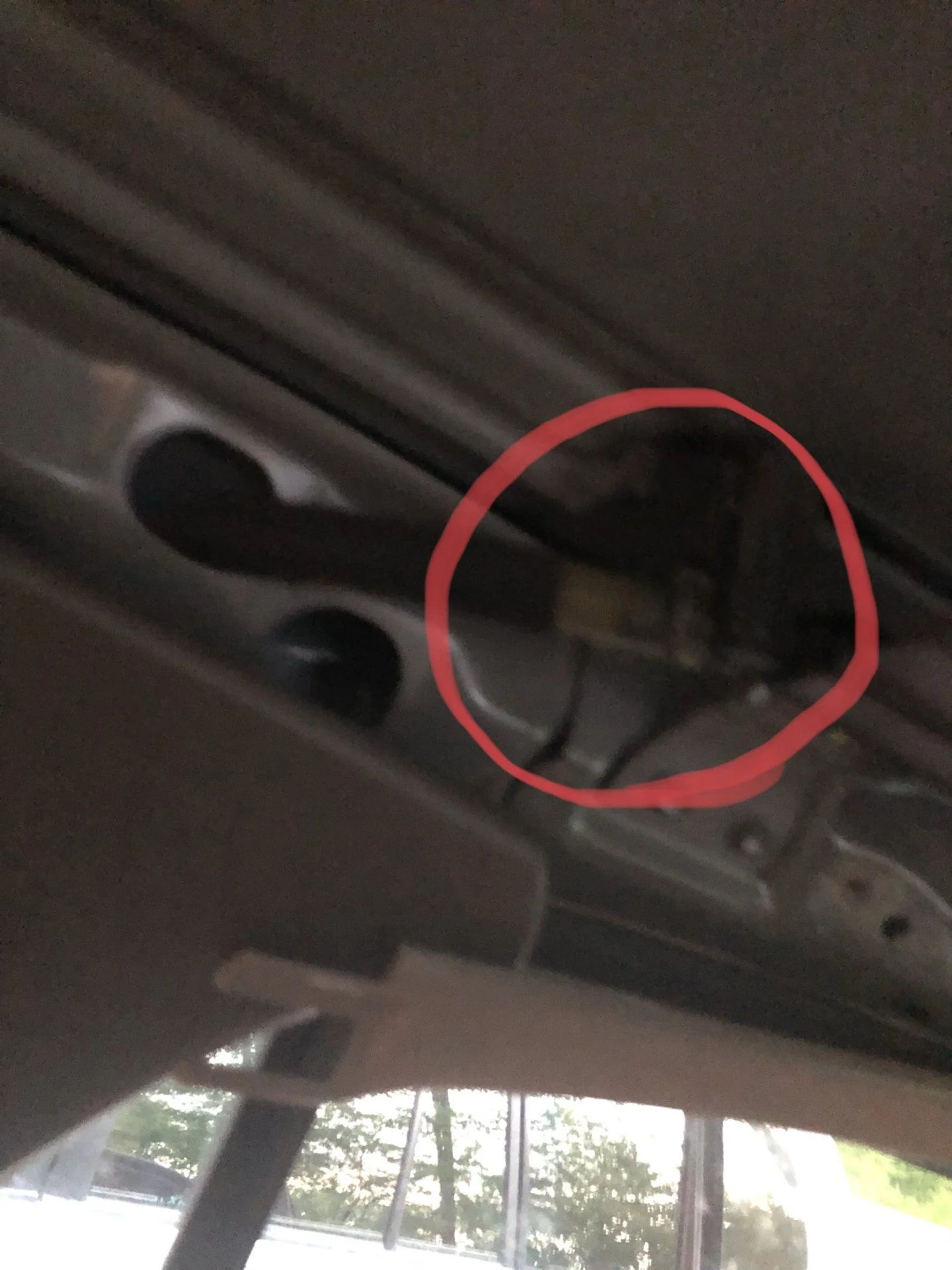

This is just a suggestion I would like to add, once you clean the mold source and fix the leak rent or buy an Ionic/ Ozone purifier and leave running inside the vehicle for few days this will remove the residual smell and and other source of mold in the car also check the rear drain tube on your sunroof I know you cleaned the front but the rear drain gets clogged too or get disconnected at times.

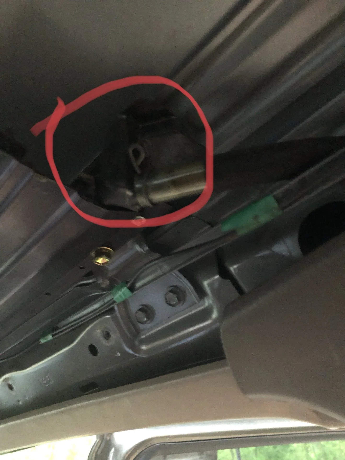

Fixed. 15-year-old and I dropped and removed the headliner. Found the tube to the P/S rear sunroof drain completely disconnected.
