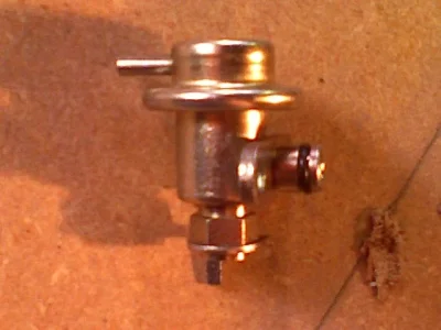

worked for me too. thanks yooper. But be careful when putting new unit on. first time I pinched the O-ring and spewed gas all over when I started it. After replacing the O-ring i tightened one bolt too tight and snapped the head off.:mad: Just fair warning

Apr 27, 2005
211
Boise, ID
Its this thing
Cruiserdrew
On the way there
Mar 15, 2003
15,919
Sacramento, CA
Right on the front of the fuel rail. Very visible just looking at the front of the intake runners.
