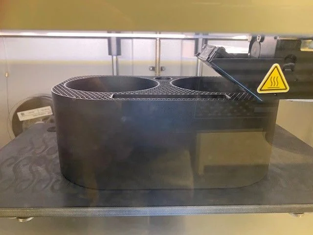

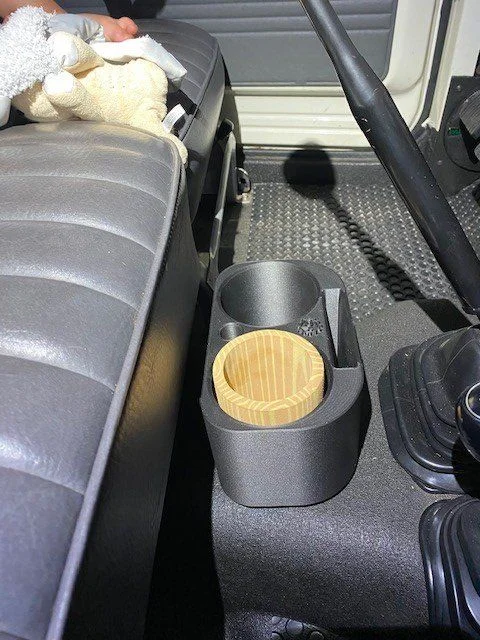

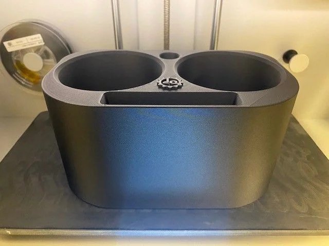

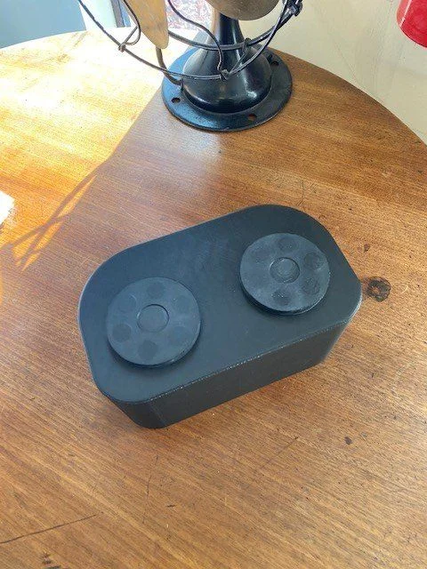

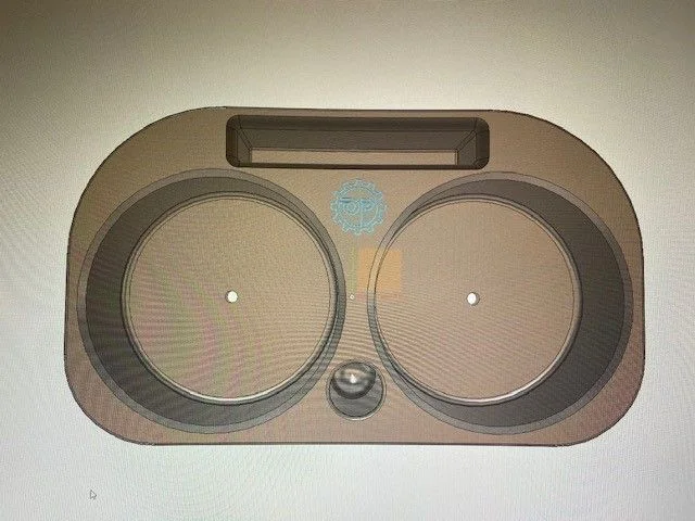

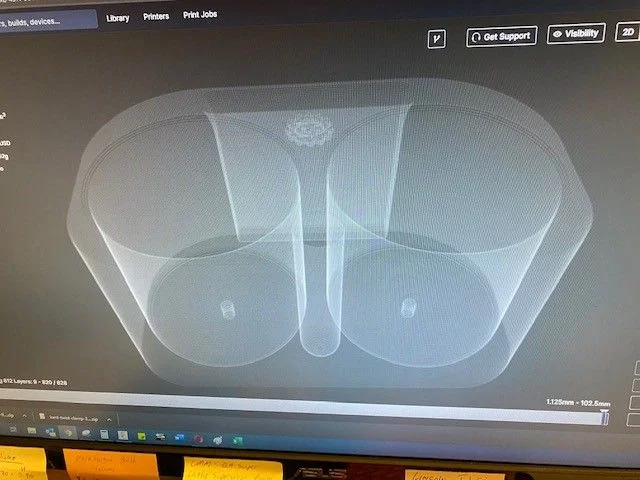

Hey everybody,
I am playing around with 3D printed cup holders/ I-phone pocket/ small flashlight holder.
This one is 834 layers of Onyx and Carbon Fiber reinforcement. I am utilizing 2x rubber encased 35lb magnets for non invasive mounting.
For version 2.0, I am going to recess the magnets into the holder, and possibly add a UBS or 12V outlet.
I would love to hear some ideas for other things that would be useful to have. I am happy to share my CAD files with anybody that want to make their own. This one took about 36 hours to print and utilized a lot of carbon fiber so $$$$$$.
