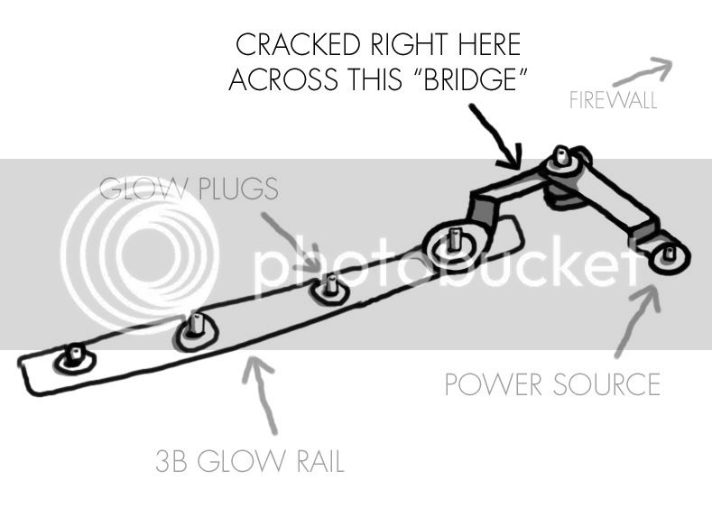

Can you hear if the relay is closing and more importantly, you need to measure voltage right after turning the key. If you are too slow in taking a voltage reading the timer will have turned the glow plugs off already!!
I had a problem getting power to my glow-rail as the little metal bridge had corroded and snapped in half, after I located and addressed that issue, she fired up just fine.

Is power coming out of the relay? If yes, is it making it to the first point shown in Nicolas' sketch? If not is there power to the relay? It could be a bad fusible link, bad wire or??
Basically, it's time to get out the volt meter and chase the power down.
