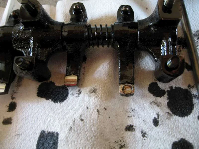

I have found a 'new to me' large diameter rocker assembly that's in good shape.
I'm curious though and for the future, but how exactly did you go about grinding out wear divots?
For example is this done exclusively at a machine shop or otherwise? Do you add metal?
I'm sure others would like to know as well.
aaron
aaron,
I certainly didn't invent the rocker-divot-grinding procedure; when I joined the forum it was already common knowledge on this board. You just grind them with a dremel, go slow to keep the heat down. No need to add metal, there's plenty of adjustment available.
Here's a pic of mine prior to grinding:
attachment.php
I used a grinding stone like this
followed by some fine sandpaper discs to give it a reasonable polish.

Has any one ever welded the hole punched by the valve with 6010 weld rod then ground it down? Or any weld rod, all would be much harder than just cast steel.
The rockers might have originaly have had some hardening on that surface. Grinding them down would expose the softer cast metal.
Or is just grinding it all that’s needed for another five hundred thousand kilometres?
I am the process of changing the head gasket on my 3B and found similar wear on all the exhaust rocker arms, the intakes seem fine. The arms are still available so I’m just replacing them. Once you wear or grind through the hard facing the base metal is exposed and will wear much faster and create more friction with the top of the valve stem.
FWIW my motor has around 360'000kms on it and only 1 rocker showed any significant wear, even then it was nothing like what is pictured above.
What sort of mileage is on the motors with really worn rockers?
