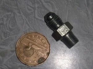

Yes, as the one thread indicates...BSP is the correct thread. Get the adapter if you don't want to tap the thread.

this is what i was talking about...

So the Oil Sending Unit Adapter Kit 1/8" x 28BSP (Most Japanese Cars)
BP44 from amsoil

1/8 BSP. now When I hook up my pressure line to my turbo, what tee do you use? have the one end of the pressure line BSP and the other going into the turbo size.
what have others done?

1/8 BSP. now When I hook up my pressure line to my turbo, what tee do you use? have the one end of the pressure line BSP and the other going into the turbo size. what have others done?
I had a local shop source the adapter from the block BSP to the AXT oil line fittings. I simply went in with a plug from the oil gallery and the oil supply line. Any HD diesel shop or hydrolic shop should be able to source what you need bb.
