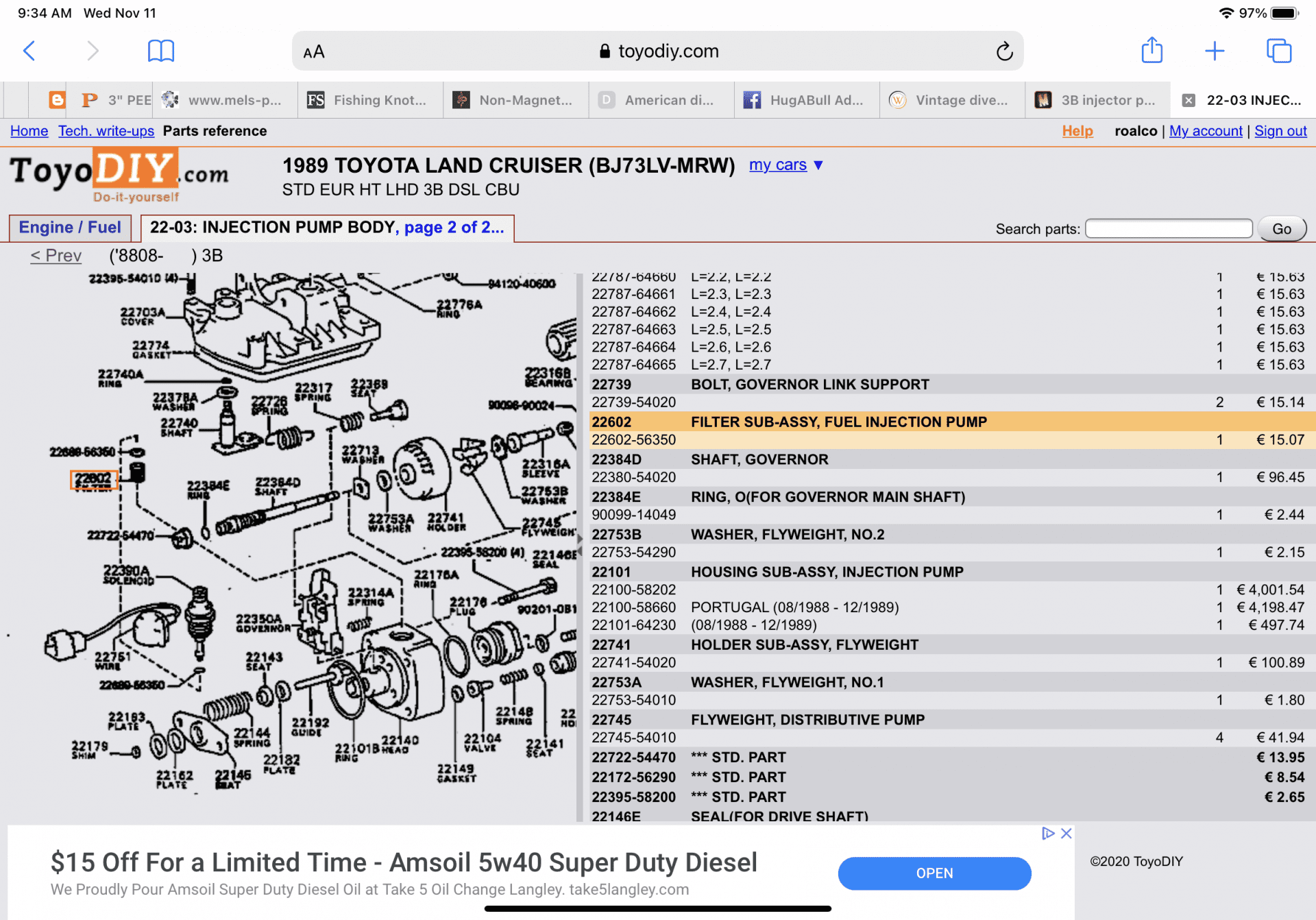

I think this may be your pump, it shows the filter.

Off and on I hear guys talking about the lift pump on the 3B injection pump. I'm going to attach a picture of my pump. Maybe somebody could point it out to me. Is that something that can be easily fixed replaced repaired? Or does it require removal of the IP?
