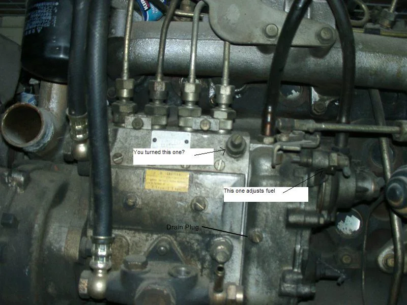

Ok first off its a 82 3b with an AXT turbo kit that was put on myself 2 months ago. The other day i decided to turn up the boost to 10 pounds from 7 for my trip up the coq. I started playing around with what i thought was the fuel mixture screw (a nut with a set screw in the middle on the left side of the motor) and i opened it up to much and got air in the system. I then decided that i don't know what i'm doing and tightened it back up and left her alone. It drove fine for a day and when i started my trip up the highway 15 minutes in the engine felt like it ran out of fuel (the tank was full) and i had to pull over.
This is where my fun started. The engine would turn over put wouldn't fire. I checked the little set screw (the only thing i messed with) and it seemed fine. I primed it up with the plunger and with the pedal to the floor she fired up. So i was on my way again for another 10 minutes and the same thing happened again. This went on for awhile till a got her home where its sat for the weekend.

ooh, wrong adjustment screw.

I've got a question to add to this...
I recently replaced my B diesel after I spun a bearing. The "new"used motor I installed runs great and has good power but I am getting a lot of black smoke under load.
I am going to have my spare set of injectors rebuilt, but could this be as easy as adjusting the flow of fuel with the rear facing adjustment in the photo above?

thats exactly what i did :doh: I did a search on bleeding out the air so i'll try it when i get home. Thanks for the help :)

ya you opened the injector bleed screw. shouldn't be too hard to bleed. although that air can be funny, I had to crack my injectors several times to bleed them. fussy little things.
Put some clear line from the fuel pump on the side of the block to the fuel tube coming from the fuel tank. This way you can eliminate any air issues further back, and concentrate post fuel pump for your air leak.
