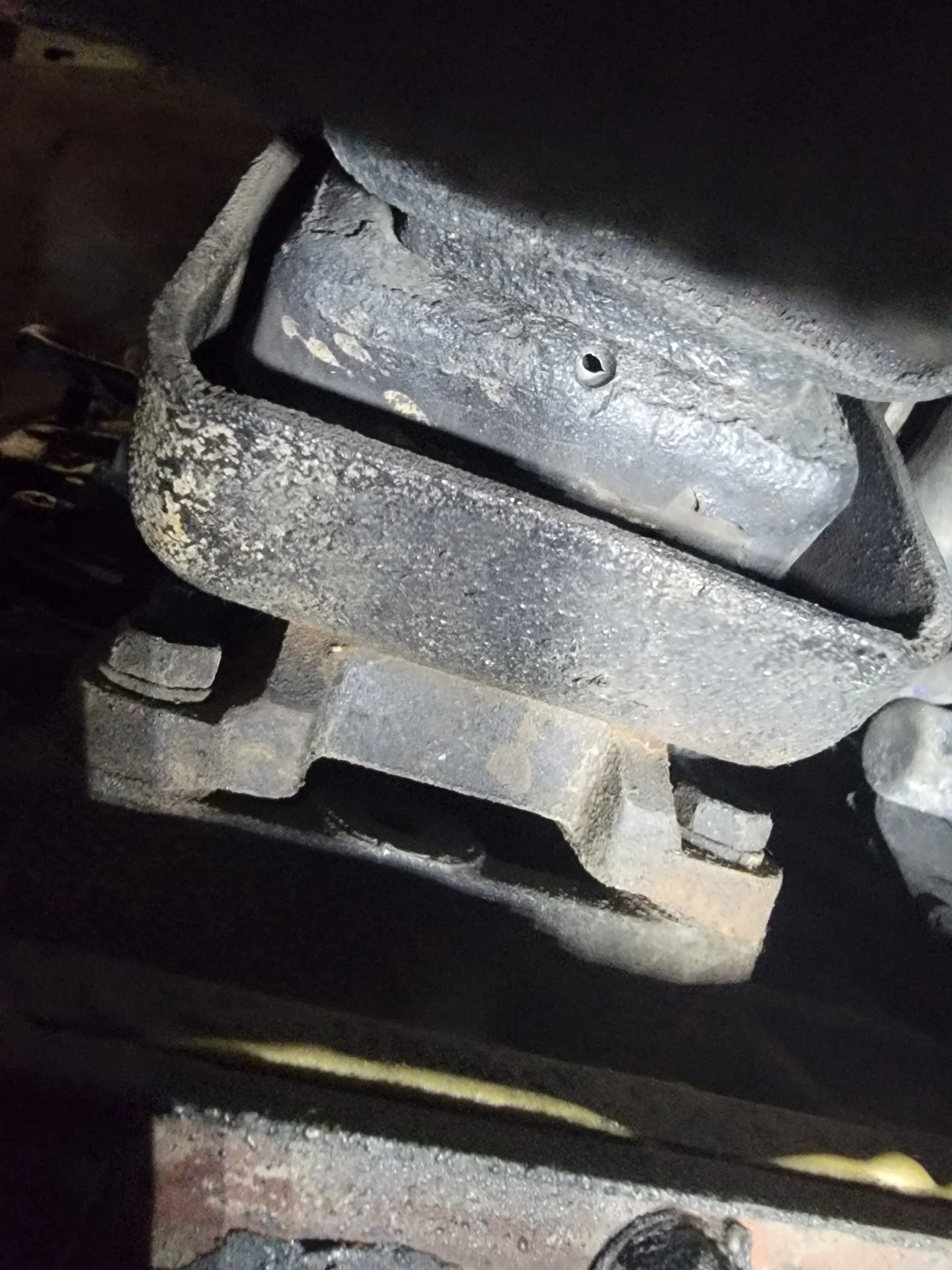

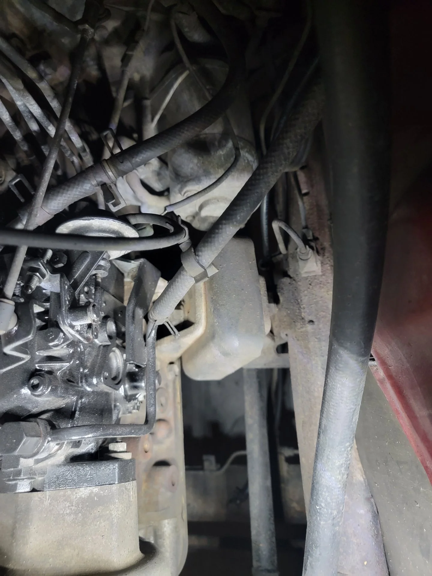

I have been trying to find the correct engine mounts for my '85 3B in a JDM 60-series. The part number that came up with is 12361-58030, which has been discontinued. I have attached pictures of the existing mounts in my truck. Does anyone know if there has been an updated/superseding part number for these? Is there an alternative that will work? Aftermarket equivalent?
Thanks!
I think 12361-58061 will get you by. Partsouq looks to have stock. <EDIT> Now has no stock but I'm sure someone will <EDIT>
ridiculously expensive. Go online and look in Australia aftermarket suppliers
Amayama lists it discontinued, BUT they indicate 3B, 13BT and 2H share the same mount. that might help broaden your search
