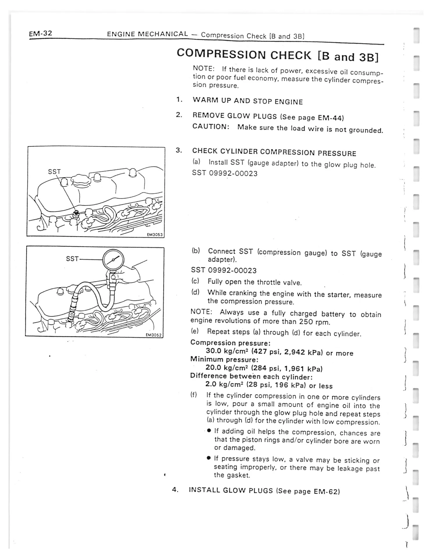

Need some assistance and advice as to what could be the issue or if this is normal. My car was idling and noticed a bit of smoke comming out of my crankcase breather underneath the car. The cars a 1982 Bj42Lx. Any advice would be great.
