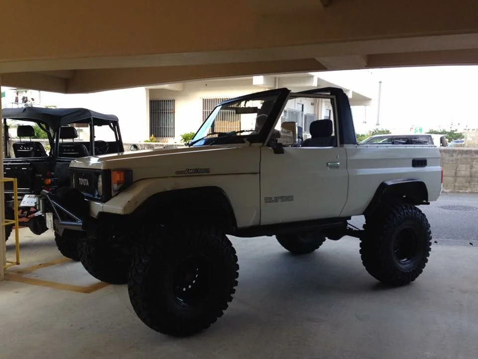

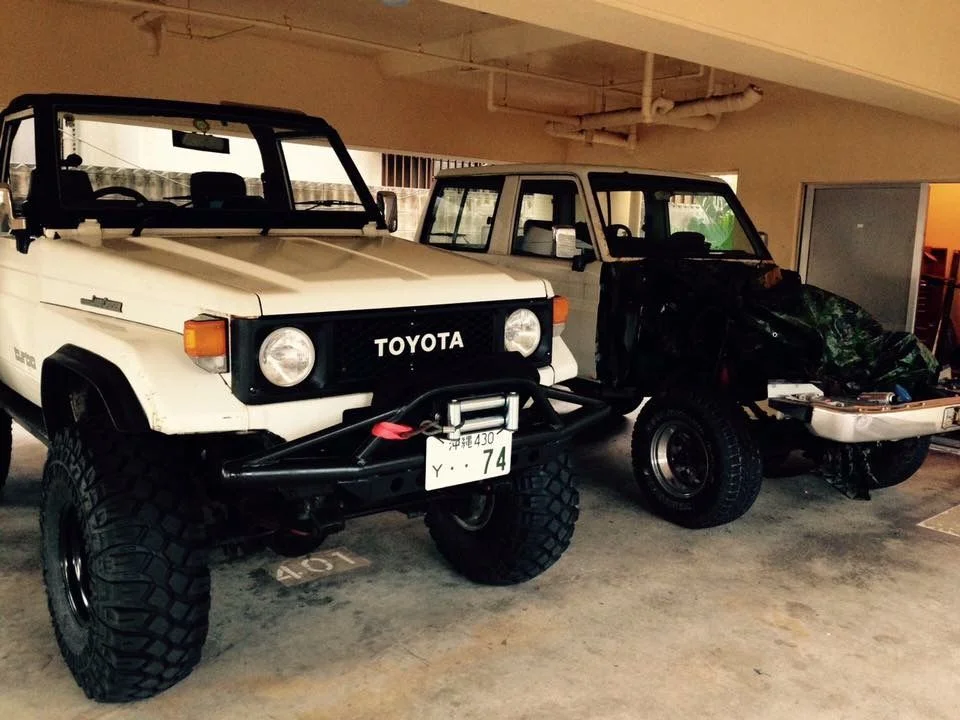

One of my BJ74's, Zed, has skinny 36's on stock suspension with no body mods (currently running 9.00R16's ~36"). Looks great, no rubbing. Use bump stops to prevent rubbing.

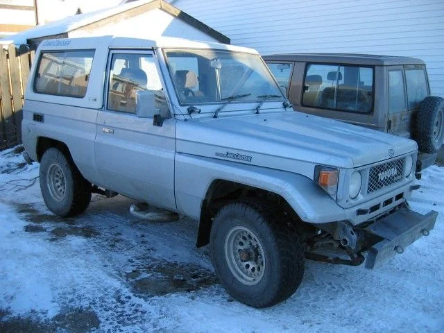

Another one of my BJ74's, Zee, has a Dakar lift kit and 35" tires. The tires look way to small for the truck, with giant embarassing gaps between the top of the wheel and bottom of the fender. Like a plumber's ass, no one wants to see that

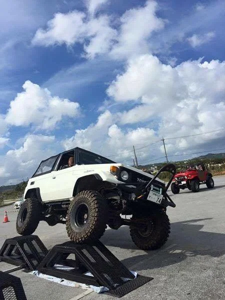

I ran 39.5's on Ziplock the BJ74 on a flat spring over with 1.5" cut to the fenders. When I originally built the Spring over, I had 38" tires for it. they were so small, it was as embarrassing as driving a 100 series. It was upgraded to 39.5" Iroks before it even left the shop. That was an awesome combination.
I am currently rebuilding Ziplock for 42's. LOTS of mods this time.

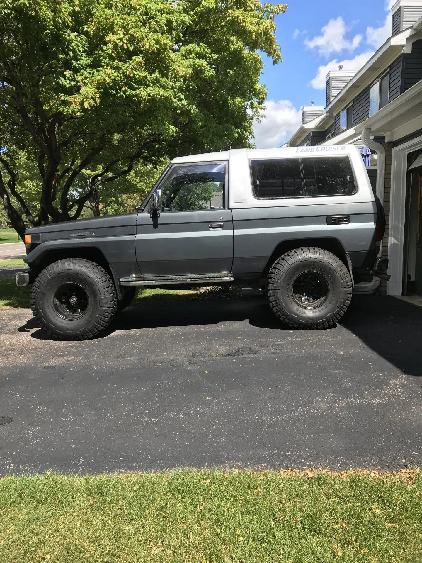

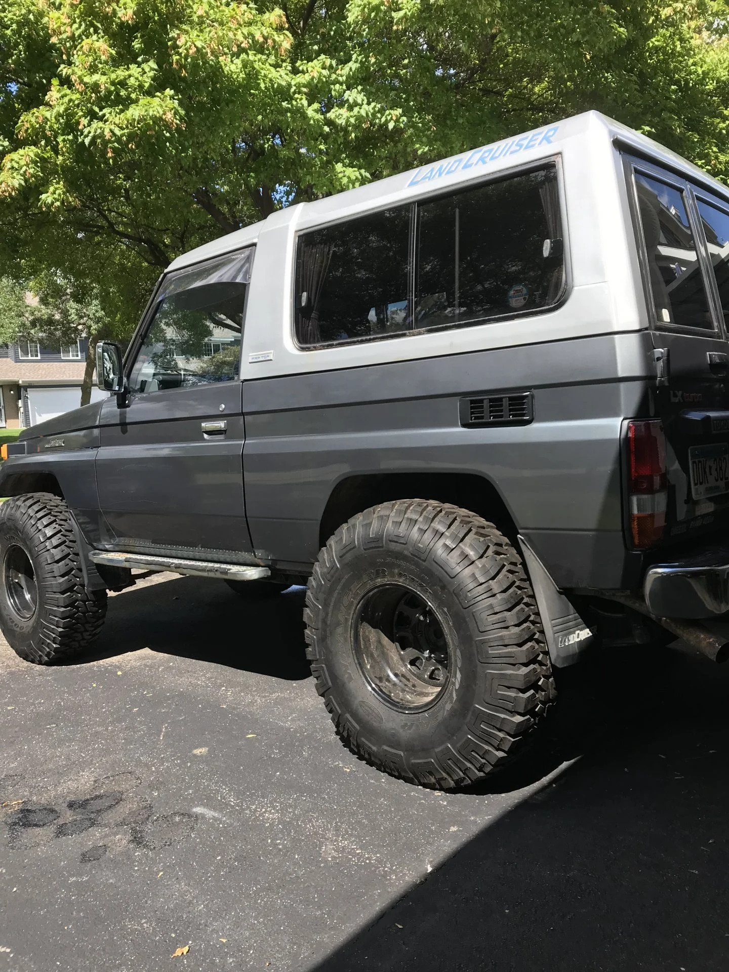

Expedition BJ74 Buildup
Had a little extra time and some old school 37/12.50 15 mtr’s in deep storage, so why not.
Those look pretty good on there! How is the clearance when articulating and/or turning? I had to remove my front mudflaps for 35" never mind 37"!
